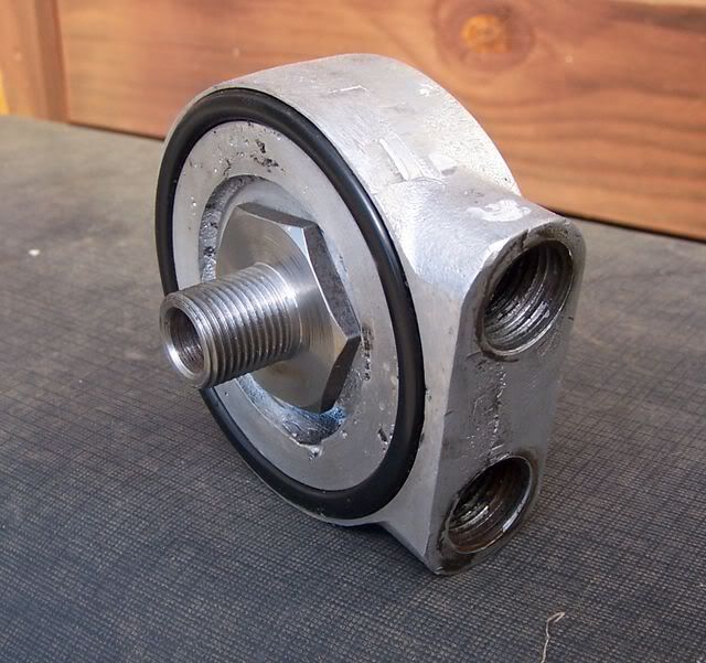

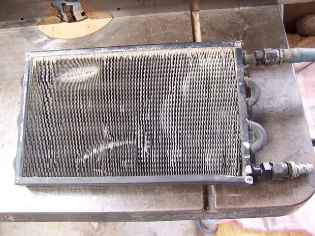

I already have an oil cooler and the connections but have been afraid to put it on in case I end up with oil that is too cold because under normal running the oil temperature is about right.
I might put it on with a fan to control the temperature.
Cheers Richard
Never say die, up man and try
throw away the sandwich plate ..
get a electric oil pump .. put a boss in your sump for sction .. and one down the other end for return .. ..pump.. rad .. sump ... maybe even add in some bypass filtration there .. and one more boss for a thermatic switch to turn the unit off and on at your desired running temp
ill go look in the shed later see if i have any of left from my last setup
basically there comon use is a diff/gearbox cooler setup in a curcuit car
tilton used to make the pumps... im not who does now
ill see what i can find ... but it is the way to sort your problem and has the ability for you to basically pick your oil temp
Kiwi4x4

Oil overheating problem solved.
I was looking at my Surf radiator yesterday and noticed it had 52 cores across and the Hilux is 41 cores so that is alot extra cores .Times 3 = 123 compared to 156.
Swapped them over this morning and went for a test drive up the Spooners range.
Pyromter 610C Water 90-92C oil 98C and cruising 100k on flat road oil 85C so I am completely happy now because the internal oil cooler is now working properly.
Cheers Richard
Cheers Richard

That's a dodgy looking casting. I have one in my gearbox adapter setup that looks like it came from the same place. Bloody thing seeps oil despite my best attempts to seal it.
Dodgy it my look, but it dosnt leek, Had it and the oil cooler on my old "Oldblue" 40series Crew Cab with a 2H that I turbo'd.
Fitzy will remember it
