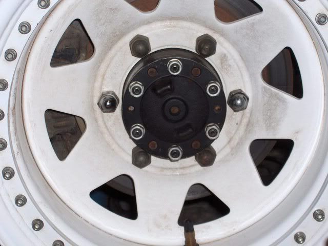

Sheared the axle hub again today. I'll have to look at getting something stronger some how. The axles have had a beating lately. I'm surprised they've lasted this long (the way I drive it). :shock:
After i broke it (smoking the tires :roll: ) i slipped the axle out, threw it in the back, locked the rear up n put in it in 3 wheel drive :lol: then drove it back round to Ricks. (I'd only just come from there) :D
I think i might of bent the axle as well. When i turned it while in the diff it didn't spin that straight. :evil:

what sort of axles are they pete

mercutio wrote:what sort of axles are they pete
The picture only shows the hub minus the axle. The axle is in the back of the truck. That's how the hub looked after i drove it back with no axle in it to Ricks.

hi pete,
looks as if what hapeened first is you sheared the studs that hold the drive flange secure, pretty sure Jafa has some much stronger ones available from Trail gear for the front of hilux's, they will definately fit on your rear hubs :wink:
I'm going to call in tomorrow at Ricks so i'll have a chat with him

hmmm, maybe its time to look at putting safari/80 series running gear underneath and going coil sprung??

gary_in_nz wrote:hmmm, maybe its time to look at putting safari/80 series running gear underneath and going coil sprung??
That was talked about today but, I'm happy with leaf springs. And to go coil over all round, I'd be throwing a shit load more money into it when the extra articulation just wouldn't get used. (around the supermarket carpark :roll: )

With the horse power and you have stronger axles you may find you bust ring and pinion's or drive shafts maybe you need to see if you can get some shear pin's in the drive shaft, strong enough to have fun but you bust the shear pin before damage, quick swap and you are away again.
Also when you go offroad you can change the pin to a stronger bolt and allow the tyres to spin and get all the power, must admit if I had your 40 I think I would need a removeable bump stop installed under the accelerator :twisted:

Drill out the studs and re-tap bigger ones from a Dyna or other small truck (and get the cone thingys as well ) , Redrill your axels to suit .. Going up a couple mm might be enough ??

mudzilla wrote:Drill out the studs and re-tap bigger ones from a Dyna or other small truck (and get the cone thingys as well ) , Redrill your axels to suit .. Going up a couple mm might be enough ??
I've gone with brand new 70 series hubs n axles. Should be all up and running tomorrow. They're a little bit stronger. Should last me a wee while. Once they brake I'll go for something stronger ex the states. But i need the cruiser asap.

I'm a safe driver though. I think Steve's exaggerating things just a little there. :shock:
skid probably drove his on the edge of extreme more than I do.
So far I've blown one diff (sheared pinion n broke a crown wheel tooth)
Broken one UJ.
Sheared the axle bolts/dowls twice.
I don't think that's to bad in hindsight. :)
Madaz
Posts: 1042
Re: petefj40's project complete!
Post by Madaz »
This is what you want to do.........
100 series cruza studs and dowels
These are both 10mm verses 8mm on earlier stuff.
I have heard that overtightening is the biggest killer of these studs too.
