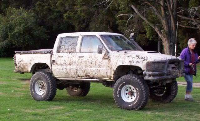

To show I still have the Hilux and are alive. Here is a photo taken 30mins ago, still covered in mud from getting stuck picking up pegs with James(Toysuzi )at the National Trials on Sunday. We had to be rescued by a 15 ton digger.
After breaking the windscreen with Jafa it is good to have a new screen with no scratches.

oldblue wrote:Hi Richard, You my need to correct your clock, trial was on Sunday 8th not today.
hahahahahahahahaha
and you should of taken a pic of the other side as it was a hell of a lot muddier
I wondered where the hell you had been to turn the white truck into a brown truck in the space of 20 mins or so.
looked like you'd had fun though
was good to finally meet you in the flesh as well
you didn't get any pics of the day by any chance

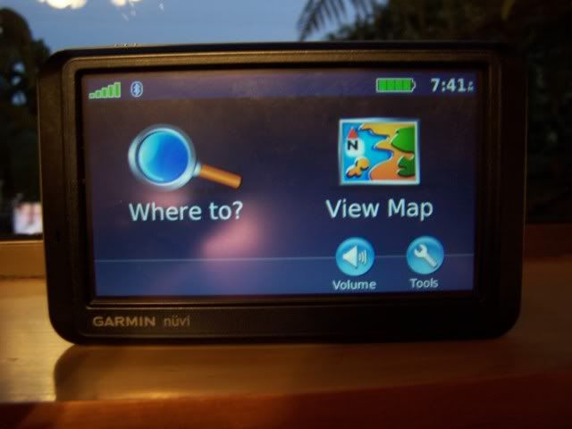

New addition to the Hilux. A new Garmin Nuvi 760 GPS.
And just ordered the official topo maps of NZ with the high resolution aerial photos so should have no reason to get lost in the bush anymore. Hopefully !
First test at Easter when we hopefully will find a historic power station.
Cheers Richard

Bulletproof wrote:New addition to the Hilux. A new Garmin Nuvi 760 GPS.
thats 2 new additions dude
how long ya had the flash woodgrain dash

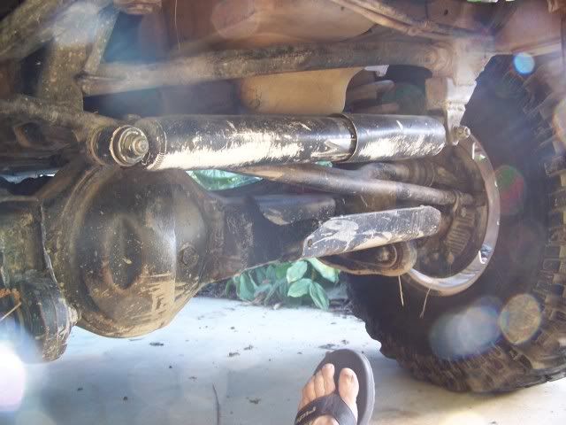

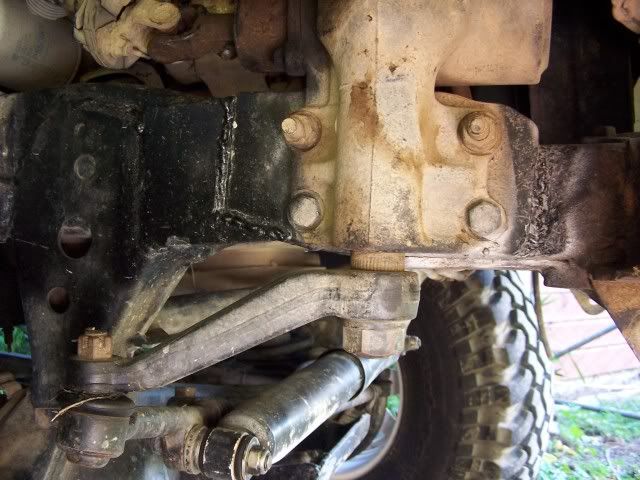

A couple of small mods to the mods.
I have bent the drag link 3 times now in 3 months so have extended the protection out some more. Might fit a high steer arm on the left side to lift the drag link up a bit. I think it would work alright with the panhard angle.
I have also bent the steering damper but dont know what to do about that. Not many options
My cruiser steering box keeps coming loose on the chasis mount so have now welded the mount to the chasis.
Time will tell
Cheers Richard.

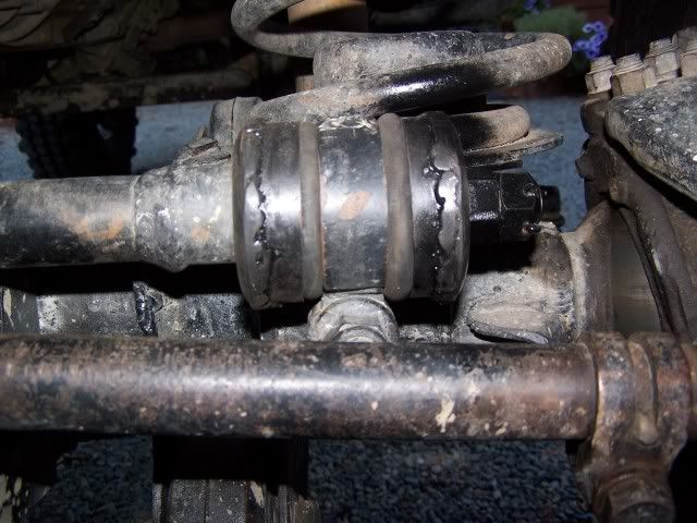

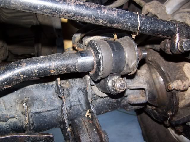

An adjustment to my panhard rotating end that works really well.
The Rubbers I used are the nissan rear radius rod bushes. Since I have fitted it the rubbers seem to have softened allowing some side movement and a little shimmy on the steering wheel.
I have now fitted a piece of exhaust tube around the out side of the rubbers and now there is no side movement at all.
Pic before
As it is now.
Cheers Richard
Pic before
As it is now.
Cheers Richard
