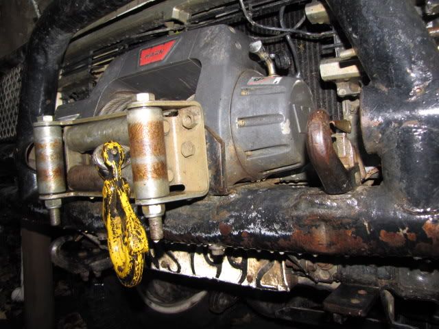

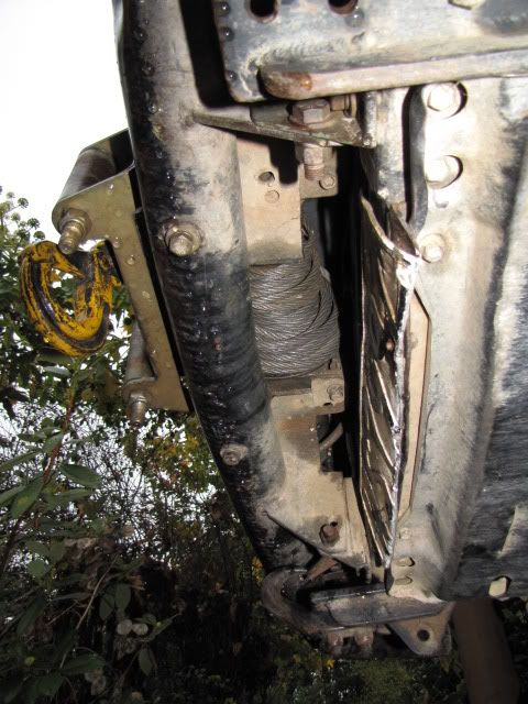

antsarooney wrote:Hi Richard i have been watching this thread alot and am intrigued by the amount of work you have done.
Wondering about your bullbars whether you built them yourself or bought them if so where from,also could you possibly put up a photo of where your winch is mounted please.
Cheers for the thread.
Ants
Hi Ants
The bullbar was on the truck when it was imported. It is a Smittybilt from the USA
I cant seem to be able to really show how it is mounted. I have set it hard back so I still have a good approach angle.
2 bolts go right through the bar and 2 are through plate welded to the bar
The bar is mounted above chassis height so I have tied it along the chassis for extra strength. I have triple blocked off it so has been tested to over 20,000lbs
Hope these help
Cheers Richard

Richard, while on the subject of your winch, what battery do you use?
- Bulletproof
- Posts: 1775
- Location: Nelson
Andrew1706 wrote:Richard, while on the subject of your winch, what battery do you use?
I have a single Hella crankmaster CM1000 cca battery and a 70amp alternator and have never had a winch give trouble with a flat battery or overheating.
When winching I put both lockers in and using 1st gear winch and drive at the same time.
