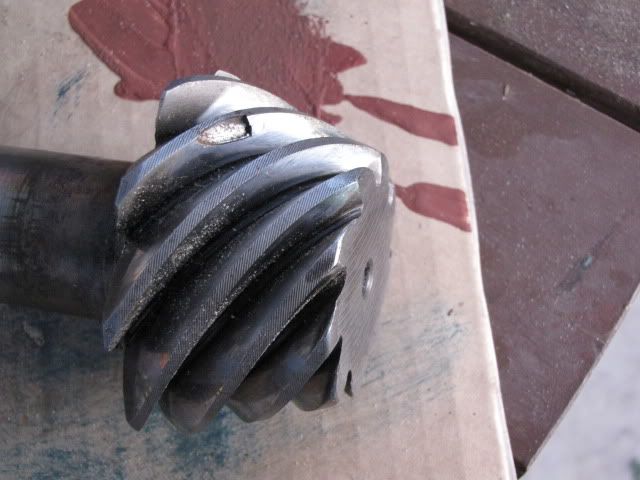

Decision made.
Bill (WJW) ordered me a Yukon Ring and pinion from the States last night .
Just have to wait now but not the end of world because the existing diff is still OK. Just hoping for a stronger setup all round.
I have never blown a diff but this is a worry when a piece of tooth falls out in the middle.

Your a builder richard, just mix up some bog and add some extra hardner to make it a bit harder and she'l be right, if that doesnt work pva some h3 msg8 timber in there.
BTW Im a builder too so dont take offence

If you look the picture beside the pinion, that is what I am doing. Plenty of red hardner in the mix.
If I had a lathe I could turn up a hardwood one

I don't think a chippy would be able to repair that, but the last time I chipped a tooth like that was when I was young and silly ( yeah I know ) and opened a Beer Bottle with my teeth, the Dentist made a brilliant job, $400 and 10000 bites latter still going strong.

SMOKEY wrote:I don't think a chippy would be able to repair that, but the last time I chipped a tooth like that was when I was young and silly ( yeah I know ) and opened a Beer Bottle with my teeth, the Dentist made a brilliant job, $400 and 10000 bites latter still going strong.
NOW OLD AND SILLY,
FITZY.
Still chewing the idea over Fitzy. I was going to ask for the name of your dentist so I could have it capped.
Second thoughts. Your dentist at 20 wouldn't be alive now.

pre heat the whole thing , use a hard facing electrode, careful mill job and polish,
