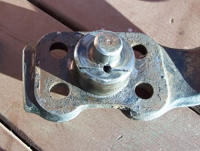

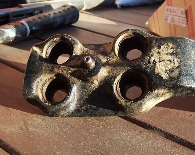

Another mod worth doing for any one with a solid axle hilux or cruiser is to put a grease nipple in the top of the king pin arms.
Off roading you always get water into swivel hubs and the top king pin bearing goes rusty and dry. A pump of grease every grease solves this problem.
I have hack-sawed a groove to spread the grease
cheers Richard

I like that mod Richard, very cool 8) . The other place to look at putting a grease nipple is in the hub itself so all the wheel bearing cavity can be filled with grease, (if it's full of grease, there is no room for water). Some will argue that this will cause the bearings to overheat, and if you drive at 160kph for long periods, I'm sure it will. But mine is a 4wd, not a Fendalton tractor, and is never likely to be driven at constant high speeds.

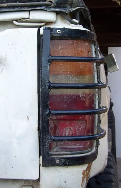

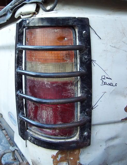

One of the best mods I have ever made is protection for the rear lights. Over the last 10 years I haven't broken one light even with serious bush bashing.
Side view
In this picture you will see I have used 12mm rods around the lights welded to 30x5mm down the side. This is doweled through the double skin of the body with 12mm rod and stops it being ripped off. The back end has 16x16 section steel .
To hold them on I have used 4mm stainless screws which make it easy to change light bulbs. All the strength is in the dowels.
Back view
cheers Richard
