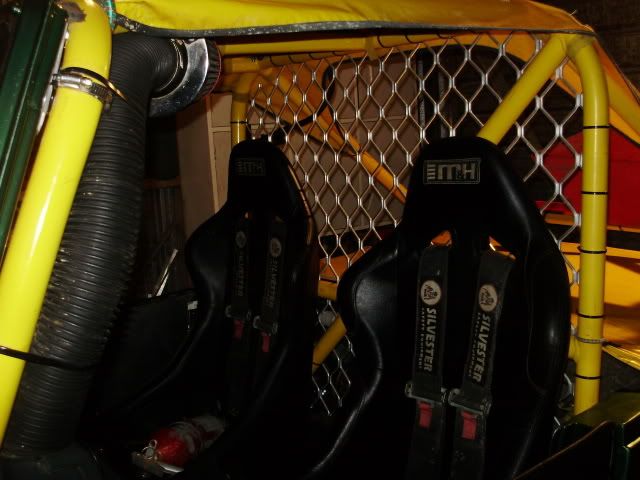

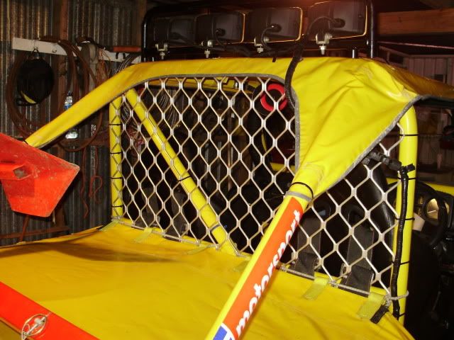

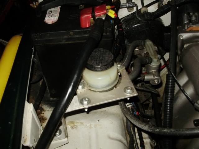

Scrounged some aluminium mesh and threw together a cargo barrier tonight.
Its just cable tied in place so its easy to pull out. It doesn't actually serve any kind of purpose other than to satisfy a rule, but its there, its in and it only gets in the way a little bit.

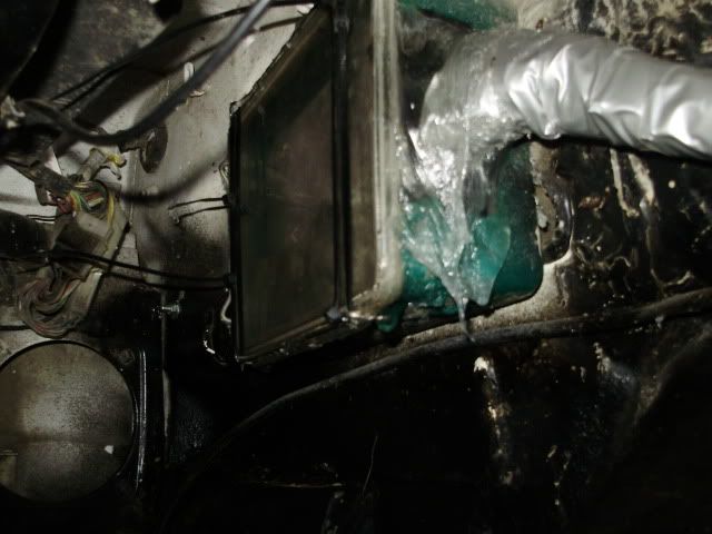

With all this rain i thought i had better have a look at the computer and see how water proof its mounting was.
Pleased i did :shock: :shock: :shock:
The loom wasn't long enough to get it into the glove box, so had to use plan "B".
I wrapped it a thick plastic sample bag and vacuum sealed it, wrapped the the plastic bag in rubber and tape so it won't chafe through the bag, stuffed the whole lot into the box, and then emptied 2/3rd's of a tube of silicon sealant around the join on the lid, and around the hole in the box where the cables go in. Looks poo's, but i bet its water proof :lol: :lol:

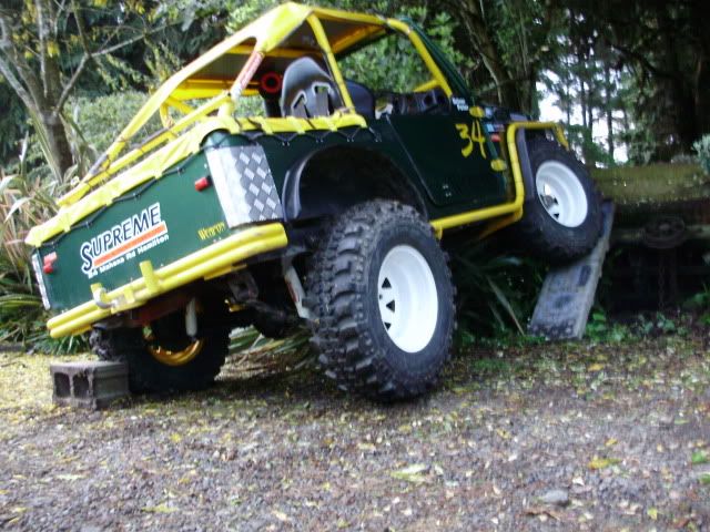

Also tried some 31 X 10.5 15 Simex Centipede's on for size. Was far to wet to get down to the official flex test drain, so had to improvise :lol: :lol: :mrgreen: :mrgreen:
Bit of rubbage, but they do measure at 32.2 or something like that :lol:

lovin the Zuk with those Simex on it? :twisted: :twisted:
How well do they bag with the light weight.
Looks like you need to move the diff forward 20ml or so, to clearance the firewall a little more. Are you running bump stop extensions in the front?
id be concerned about condensation buildup in the plastic bag for the computer.
My plan is to vent the water tight ECU box into a breather system connected to the snorkel. Should keep a slight vacuum in the ECU box.

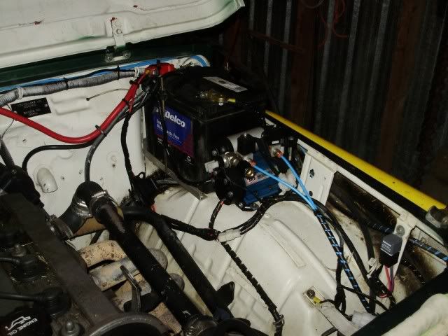

So since the Weapon has got the blingy twin ARB airlockers and HD Compressor, it really needed something doing to the front end to handle the extra load.
I had the lockers in at the Taupo winch challenge, but due the stage's being about as hard as a Laurie Sanson fun rally in the middle of summer, i never really got to test them properly or put the driveline through it's pace's. It all hung together though, mainly due to the fact I had taken my entire collection of spare Cv's and axles with me, god o'l Murphy's law eh :lol: :lol:
Nothing eventuated with the quest for chromolly axles. They don't make them for the standard Jimny axle, only the W/T Samurai.

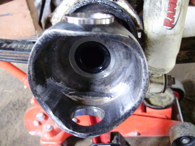

Not to be beaten, I picked up a set of Spidertrax Birfield Rings, choose my best pair of CV's and got the rings pressed onto the CV's.
CV with Spidertrax ring next to slightly greesy standard CV:
The logic behind the rings is that 99% of failure is doe to the bell of the CV exploding under load. The rings provide further strength to the Bell preventing that from happening. The tooth pick axle shaft just blows instead :lol: :lol: :lol:
The rings once pressed onto the CV joint take up the entire space inside the housing and more.

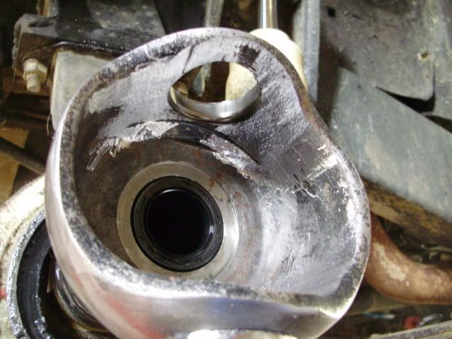

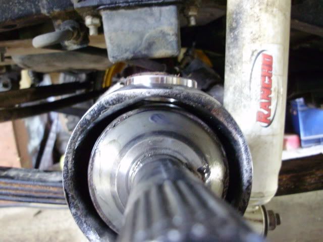

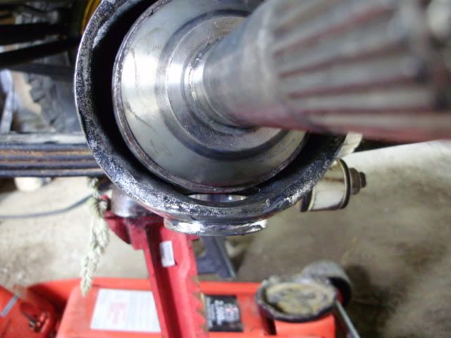

Grinding is required. This is what you start with:
You have to grind the ridge where the machined area meets the bare casting smooth for a start, just to get the CV's with the rings fitted in there, and then keep going untill the CV joint rotate's freely and doesn't bind on the housing on full lock.
Lower area finished:
Upper area all done:
I gave it a little more clearence than needed just be safe, but its still a bloody tight fit :shock: :shock:
Gave it a decent thrash at the weekend and it all hung together, so I must have got it right :D :D :D

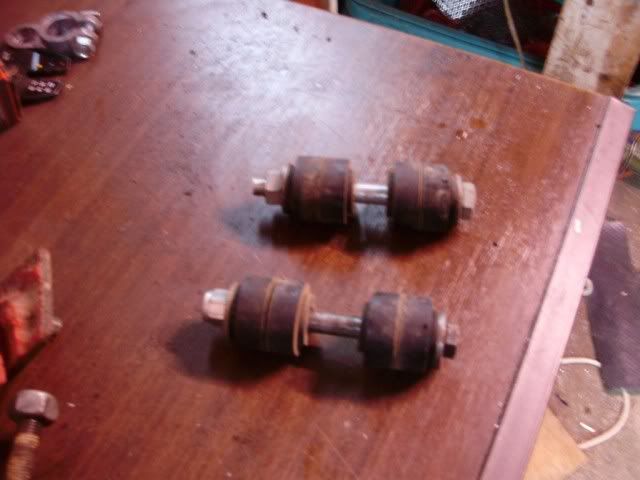

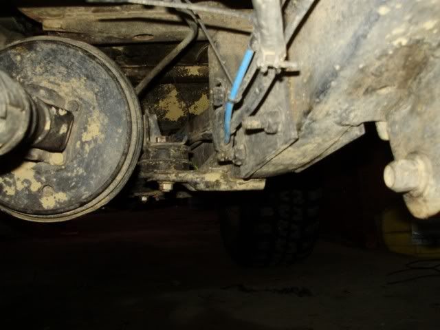

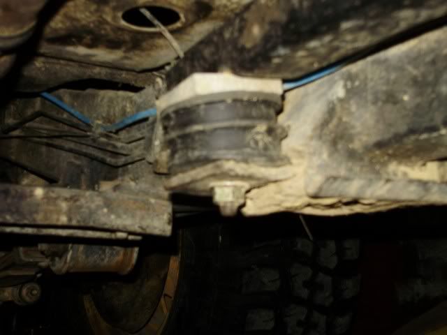

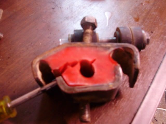

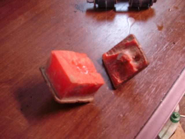

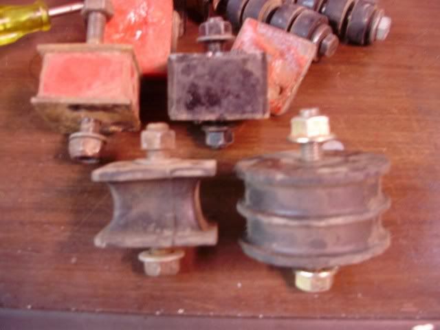

Been having no end of T.Case mount drama.
Keep ripping the Nolathane mounts in half, if they don't delaminate first :lol:
I tried some of the Bomb Proof mounts for a laugh, but those things are shit :lol: :lol: They don't sit straight, you can't tighten them up properly, and they don't allow enough movement to take out any shock loading from 3rd gear standing starts :wink: :wink:

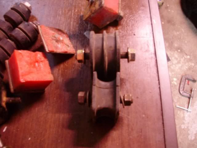

I went on the hunt for something bigger and stronger and RUBBER :lol: :lol:

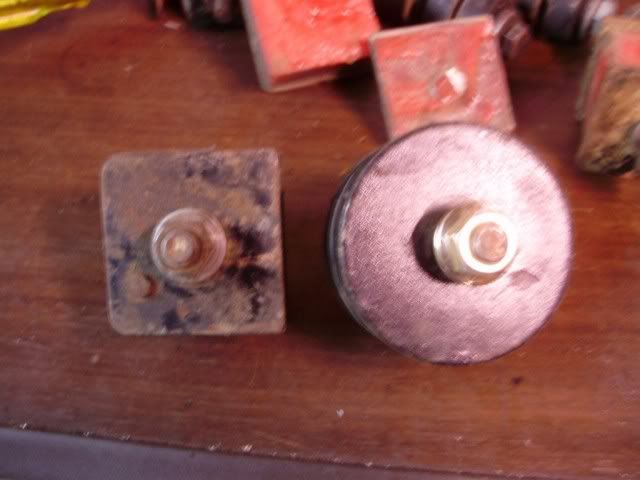

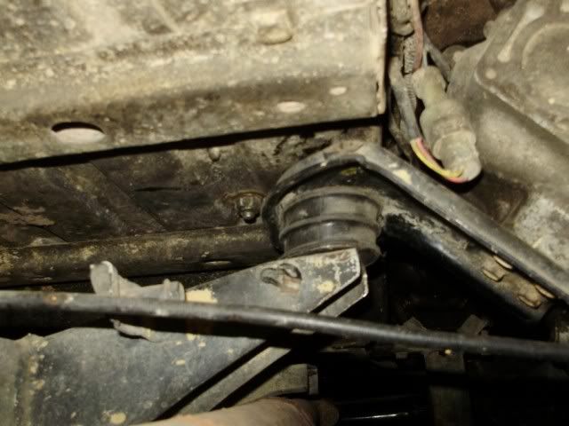

I'm giving these a go, they are LR engine/transmission mounts:
They seem really good so far, strong, soft and they fit well.
As you can see theres a hell of a lot more rubber in them than standard
they are slightly taller than standard
The top and bottom are fractionally bigger than standard, so you have to trim a small amount off each mount with a hack saw to make it fit

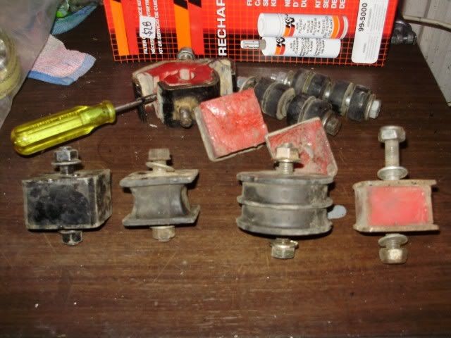

So I have a random selection of spares for the kit now, left to right:
Standard mount remade with black (soft)Urethane, standard rubber mount, LR mount, standard mount with red (hard) Urethane
Anyways, relocated the brake fluid reserviour (remember the silicone bracket :lol: :lol: )
And some blingy in the engine bay:
Also "borrowed" the rear shocks out of The 50 to increase the up travel of the rear suspension :wink:

Little vid clip comparison on how I have managed to get the suspension working...
Re: WEAPON
veery nice :) flex's good!
