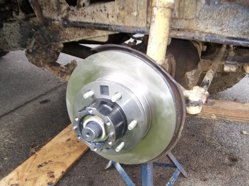

So, for those in the know... if I just buy new discs how do you get the studs out without damaging them. When I had the hub apart the other day I undid the two retaining bolts and tried hammering out one of the studs but I could tell it was just going to damage the stud. Do you:
    - heat things up?
    - buy new studs?
or is there a correct way to remove the studs from the hub/disc?

cooksworld wrote:So, for those in the know... if I just buy new discs how do you get the studs out without damaging them. When I had the hub apart the other day I undid the two retaining bolts and tried hammering out one of the studs but I could tell it was just going to damage the stud. Do you:
    - heat things up?
    - buy new studs?
they should hammer out, just make sure you put a nut on to protect the threads.

mickey wrote:they should hammer out, just make sure you put a nut on to protect the threads.
Yeah I did that but didn't smack it enough to get the stud out. I'll pull everything off again and give it a good whack ;-) I think I'll just put on new discs and get the job done.

Right... picked up one of the new discs last night (the guy selling them left the other one at his work) and pulled apart the RHS hub yet again. With the help of a much heavier sledge hammer I got all the studs out without too much fuss. Everything went back together nicely and the drivers side is ready to roll. Picked up the other disc this morning from his work and I'll put the LHS back together tonight. Everything's apart... just waiting on the disc. I'll also pick up the roll cage padding this avo.

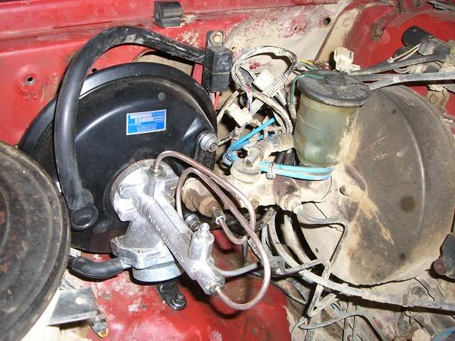

wopass wrote:found some pics, bit hard to see as its all covered in instabling but gives you an idea.
Hey - are you running a 60 series master brake booster set up here? If so have you retained the 60 series std brake bias set up that sits underneath the booster? I've brought one and have mounted the booster upside down and was wondering about using the bias.

Grrrr... fitted the 60 series master cylinder, booster, and proportioning valve but the brakes are even worse! Don't even feel safe driving it. Re-bleed the front on the side of the road and it made no difference.
Don't know why but I found it really hard to bleed the front brakes, it almost feels like the pedal is travelling its full length and hitting something. I'll have to pull it all out again and recheck everything. I'm officially sick of the brakes and may end up taking it to someone to sort.
muddy
Posts: 668
Re: FJ40 roll cage, power steering, and disc brake front end
Post by muddy »
The piston on the 60 series is longer than on the 40. I had to cut about an inch off the threaded part where it attaches to the brake pedal. The "U" bracket that goes on the pedal has to be wound pretty much all the way to the end of the thread. Otherwise the piston is in the compressed position when the pedal is fully up...

muddy wrote:The piston on the 60 series is longer than on the 40. I had to cut about an inch off the threaded part where it attaches to the brake pedal. The "U" bracket that goes on the pedal has to be wound pretty much all the way to the end of the thread. Otherwise the piston is in the compressed position when the pedal is fully up...
Thanks ;-) I'd trimmed the thread down when I installed it but I was going to pull it all apart again to check that the piston had it's full travel and wasn't partially compressed.

Tuesday night... I'd gone and shortened the shaft the other night from the pedal to the booster to make sure that it wasn't part way down. I'd also checked that the pedal had more travel in it and wasn't hitting something. took it for a drive and slight improvement,. Bleed the front brakes again and things getting better but still not great.
Today... Well, spent the avo trying to sort the breaks with a mechanic - firstly rechecked everything I'd done, bleed the master cylinder, each of the wheel cylinders... not much better - pedal feeling like it grabs initially then just doesn't get any better - as in no more bite as you push harder. He wasn't 100% sure about the proportioning valve so we tried things without it - locks up the rear without really trying. Brake clamp on the rear line and you push the pedal and every time it comes back with a feeling of it getting to a point then not grabbing any more. I was going to get a new 60 series master cylinder but he had a vehicle (surf) that I thought I'd try the master cylinder out of - similar brake configuration. Put it in, bleed the lines, same result with the rear locking way too early (no proportioning valve inline). Clamp on the rear and it had the same feel as before with the 60 series... doh! no progress.
No luck... not sure where to start. He gave me a name of someone to get their advice. I may start back with the basics and pull off the callipers to double check that none of the pistons have seized - I had checked them when I put them on but I'm running out of options.
One final thing - for those who may have already gone down this track - when you put the 60 series booster in did you redrill the hole through the brake pedal to bring the rod from the booster more inline with the centre line of the booster? I remember thinking that it was on a slight angle when connecting it up to the pedal.

bit slow on the reply here but yes.
