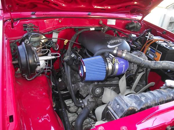

got all the front clip on and all bolted up, battery box is in and wiring all connected up and everything including the interior light has all fired up just the same as the day I parked the truck up prior to the rebuild, managed to play around with the heater ducting to get the GM computer to just fit behind the glovebox without having to chop the back out of it :D clutch is all finished, we had to mount the slave cylinder forward on the engine mount and use a long pushrod to keep it clear of the exhaust and mainfold and all the heat, its using an early 40 series 1" bore brake master cylinder to give enough displacement to seperate the twin plate clutch, steering is all hooked up and plumbed up, the P/S pump gave a few dramas to work it out after we had a few hundred gallons of fluid pissing everywhere all over the floor and spraying all over the shed roof, the pumps off a truck with hydraboost brakes which run off the P/S pump instead of vacuum and uses 1 pressure feed and 2 return ports and for some reason it didnt like the top return port being used for the steering return and kept aerating the system and pressurising the resoviour sending fluid everywhere :x radiator and hoses are all in and filled and the engines been run up to temp with coolant in it, both brake boosters are in and hooked up to vacuum and brake lines made up except for one small piece for the front brakes and that'll go in tomorrow along with some new front callipers then the system can be bled up and tested :D

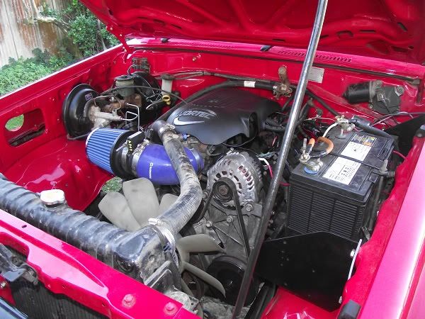

got the last of the brake lines plumbed in and bled the system up, had to shift the truck coz we dropped a washer on the floor underneath it and we couldnt reach it so we backed it out of the shed then we found we needed to turn it around so we took turns at taking it for a few skids up the road, found a problem with 3rd gear coz it broke traction and lit the tahs up going up the hill :shock: :D so we took it back to the shed and Sig reckons bigger tahs might fix it or slow it down a bit, cleaned the shed out, stuck it on the trailer and brough it back home again and by now I'd say Sigs prado is in the shed with the front clip half pulled apart ready for its engine swap :mrgreen:

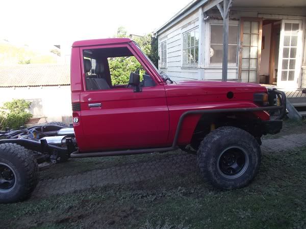

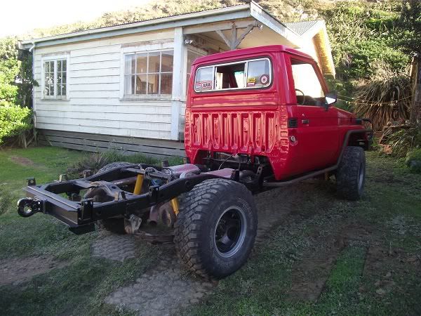

Got a bit more shit sorted out, bodys mostly bolted back on, the moulds they used for the fibreglass windscreen frame and roof wernt that flash and the body lines dont line up that well, shit there a lot better than what I had and there wernt any other options so I'm over that and give it a month or so and you wont even notice anymore :D , roof isnt bolted down yet thats going to be a bit fiddly geting the weather seal all lined up properly so thats a job for another night. Got the brakes all bled up and got a pedal, it used to pull up like a brand new commy with the extra VH40 booster but its not stopping quite so well yet, still a bit of air in the lines and the new front pads need bedding in, front callipers are new and dont have any siezed pistons but I'll have to check the rear callipers coz its sat for almost 3 years and I'll have to check I've got proper vacuum at the boosters, the engine came out of a truck and had hydraboost brakes running off the P/S pump instead of vacuum so we put a T into a hose off the back of the throttle body for vaccum so that'll need checking, if that hasnt got vacuum theres the blanked off port on the back of the inlet manifold I'll have to find a fitting for. Dumped the water out of the cooling system and refilled it with anitfreeze, tightened up all the joints for the brakes, P/S, clutch, radiator hoses, just about everything that held fluids had been leaking or weaping and took it for a good 20 minute fang, shit its like driving a 2012 HSV commy with a cruiser cab on it :D getting used to the bite of the twin plate clutch now, shit I thought the centreforce clutch I put in my 40 series was good but this is a whole new step up again, farking hard to take off without a small amount of wheelspin even when you just the let clutch out without applying any throttle :lol: still heaps of shit to do, lots of tidying up and clips and securing stuff and finishing off wiring looms and shit, need to find a bigger radiator and make up a shroud, proper aircleaner and snorkle, got another front axle housing to paint up and stick in it and have to get the C&P swapped over on my other diffhead and stick that in it, bullbar and barwork are pretty rusty and need sandblasting and repainting, the thing goes farking awesome... now I know what Sig means about those LS engines :shock: :shock: :D :D :D

Re: Sadams Flatdeck 6.0 litre chevy, runs & pulls 3rd gear s
Post by Drurban »
Sadam that is looking mint, too good to go out in the bush with it :lol:
But nice work there mate.
woot woot
finally some real wheels and tahs
looking saaaaaaweeeeeeeeeeeeeeeeeeeeeeeet
jealous much is me :mrgreen: :mrgreen:
