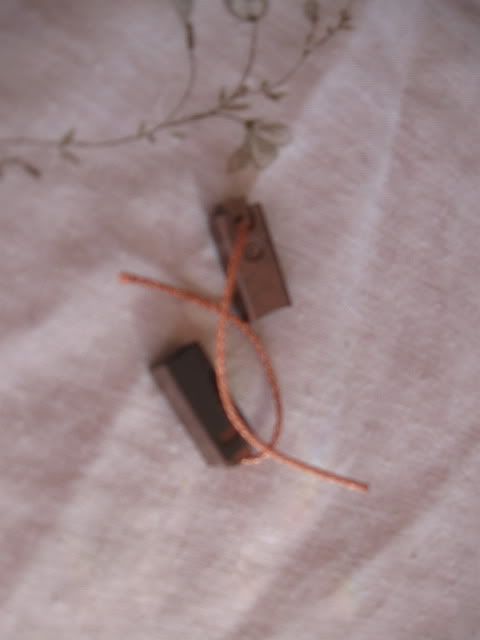

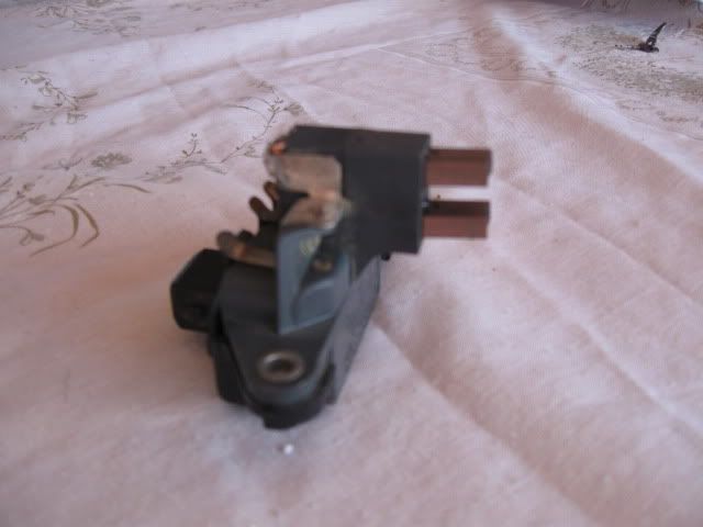

A bit of phoning around on Friday and the cheapest I could get a 2nd hand 5l V8 alternator for was $245 +gst.....is it me or are these people dillusional as to want a 20yr old part is worth???? a brand new spankers was $450, and I for one don't thinks an alternator for any offroader is worth either of those amounts :shock:
Soooo, pull alternator apart, asess problem, brushes and comutator, order new brushes...$5.80, have comutator turned down...$1doz speights....solder $4, total repair cost...less than $30.
I've attached some pics to show how easy the task is....anyone with the can do and a soldering iron can achieve :mrgreen:
Brand new set of brushes ordered from CAS
Cleaned up ready for brushes
Brushes installed in holder...only burnt my finger once :lol:
Again, i'm no engineer or auto sparky but have a go at your own mods/repairs it's just a matter of thinking about it, good luck
Tim
P.S yes that is the Mrs's table cloth....a coffee...one sugar thanks :mrgreen:
