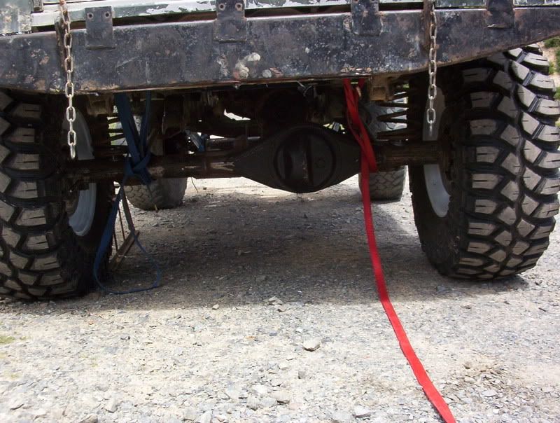

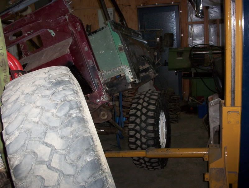

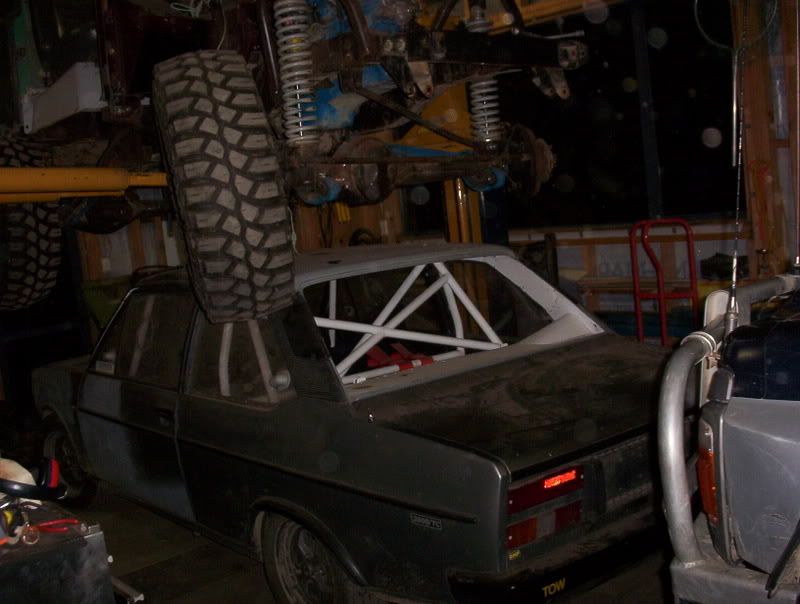

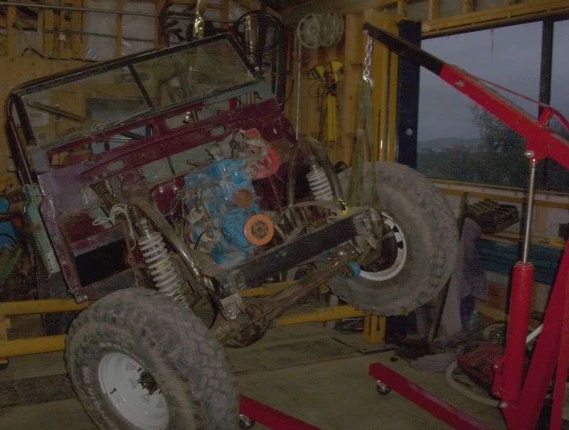

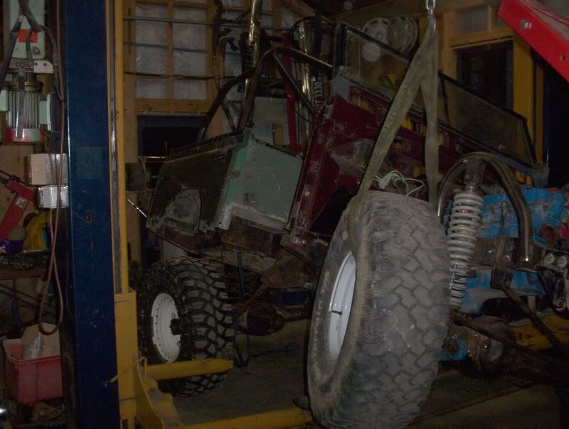

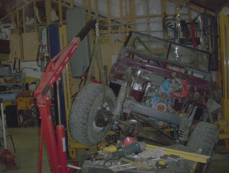

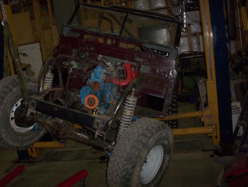

Okay, took some more pics today.

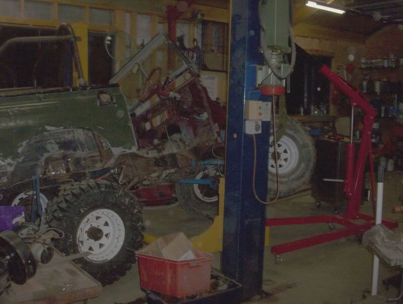

I rolled it outside and did a "moster garage" strip (stripped it in 5 mins). Unfortunately, I didnt take any pics of the strip. It was to fix the rear suspension properly.
Articulation pics taken tonight. I had to enhance them so now the quality isnt very good. The front isnt working very well, and will go higher. It just doesnt have much weight on at the mo.

nice flex on the rear 2s..

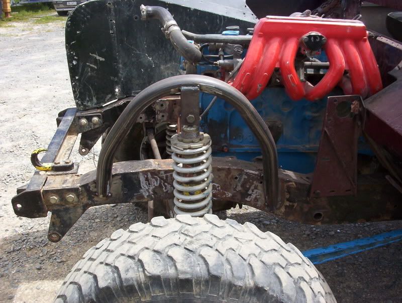

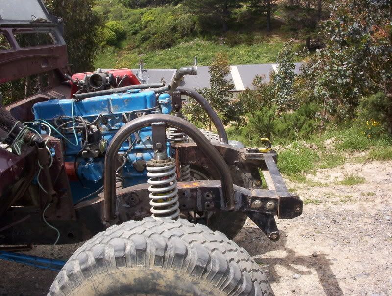

question.. how do the headers run? does the exhaust go back over the motor down the other side of the engine? (drivers) so as to clear the chassis rail..?
keep it comin fella.. :wink:

Nice flex in the rear :D :D
I was thinking you want a cruiser pto winch in front that'll throw a bit of weight on the springs :wink:

very cool, nice shock hoops by the way 8) oh yea and i like your rear shock absorbers :roll: :lol:
so how far till done? it looks pretty together i wana see it out terawhiti in 2 weeks :shock: :D

niblik wrote:question.. how do the headers run? does the exhaust go back over the motor down the other side of the engine? (drivers) so as to clear the chassis rail..?
thats not the headers lol.....that the EFI hahaha the headers arn't on it yet? correct me if im wrong tu :roll:

Thanks for the comments. I do really want a PTO winch, but since series gearboxes are made out of cheese, I may swap in another one later on, and dont want to pay money for a pto and then have to scrap it.
The red manifolds the EFI intake, and the headers were a very tight squeeze.They were VK commodore ones but had to be extensively modified to fit round the chassis so they are now more like block huggers :roll: .

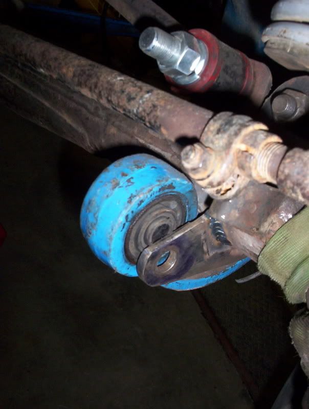

Will taking a bolt out of the PS radius arm help make the front move?

turoa wrote:Will taking a bolt out of the PS radius arm help make the front move?
Try it! Pull out the front left. Might not make much difference it looks as though your coils overs may be a bit stiff.

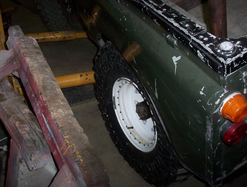

I wont try it till ive got some bigger offset wheels. The coil mount is diging into the tyre and I dont want to risk puncutring a $400+ tyre (they cost more in the 16" rim size).

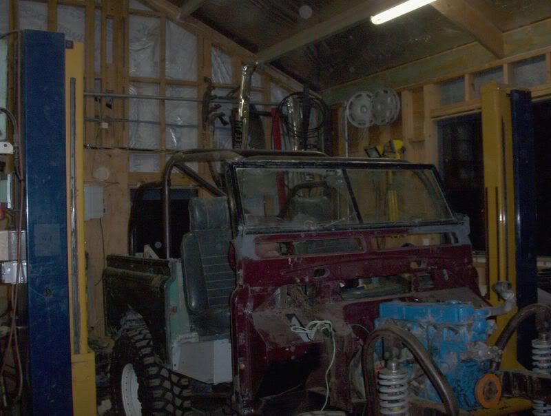

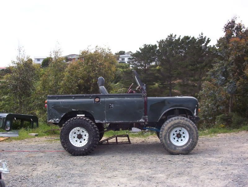

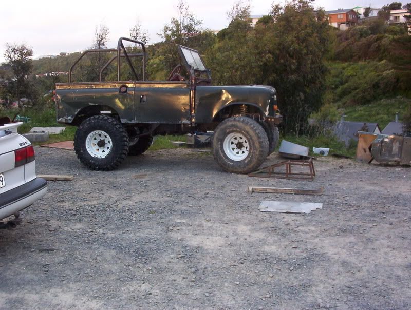

Well ive done it. I ended up putting an old 31" tyre on a nissan spare rim turned backwards :lol:
That bolt made a bit of difference
Hmmm....???
I think I might recognise that purple firewall :scratch:

Did the radius arm clash with the diff housing?
turoa
Pyro Junior
Posts: 3112
Post by turoa »
doddzee wrote:Did the radius arm clash with the diff housing?
Yeah it did.

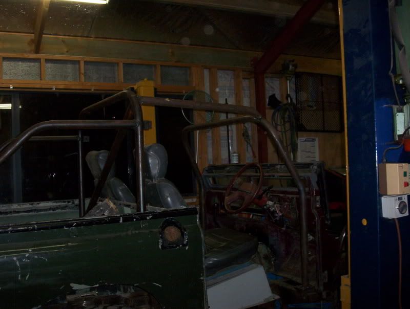

Aah ok then. This ones a stage 1 bulkhead. Thats why theres a hug hole in it. Its usually to clear the v8 manifold, but I dont have one of them, and im not using the girly plastic dash, so i just took the bulge ou, and it will have an alloy panel screwed over it, that houses the guages

Pics of front part of cage being made
