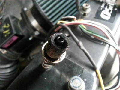

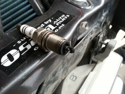

Pulled all my plug out to find the strangest of things, one of my new plugs is broken clean in half (if this was from me putting it in i would of noticed when i put on coil pack). The other thing i noticed was a sure sign of over fueling (attached picture).
So the fuel mystery continues for now
