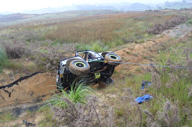

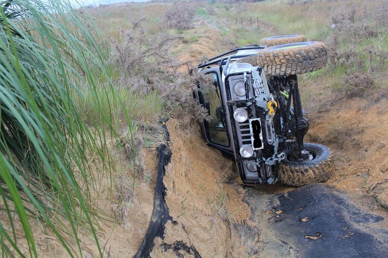

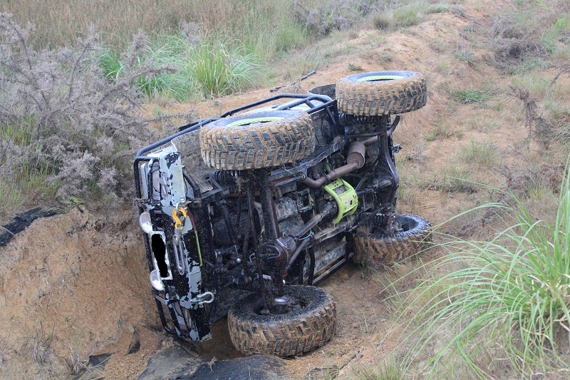

O SHIT !!! Rolled my truck!!
Mattrade
Posts: 386
Re: Suzuki+4age+Hilux Axels+coils+Exo Cage
Post by Mattrade »
Should have just kept watching tv.

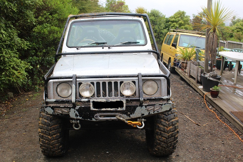

Post by Mattrade »

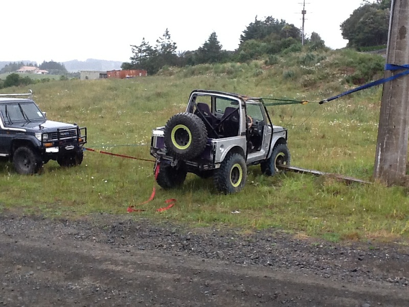

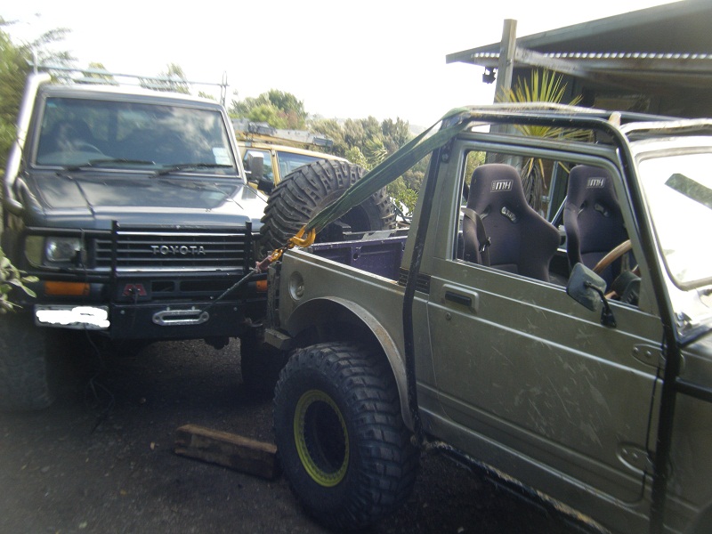

Pulled over by my bro's prado
Mattrade
Posts: 386
Post by Mattrade »

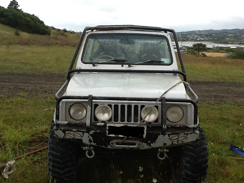

Rollcage saved my life for sure, but bent a little at the front croner, hoping i can straten it out. Then i will be fabricating a x over my windshild to stop this in the future.

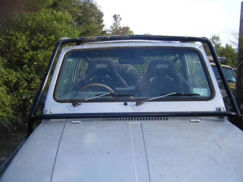

Mattrade wrote:Rollcage saved my life for sure, but bent a little at the front croner, hoping i can straten it out. Then i will be fabricating a x over my windshild to stop this in the future.
I have a single diagaonal across my screen with a similar looking cage set up. Its been on its roof, smashed into a root sticking out of a bank at about 30ks to dead stop etc and is still straight as, low end drivers side, and you dont even see it when driving. Has X in roof too.

Dirtydog
Posts: 1788
Location: Gore, Southland
Post by Dirtydog »
maybe having a cross thats removable accross bonet will help too, for the sides anyway.

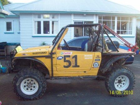

meatc
Posts: 979
Post by meatc »

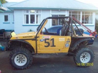

Just had a look back at your cage pics. With the X in the roof the only way it could of moved is sort of backwards. You really need to brace it from the main hoop back to the rear of the tray, at the moment there is nothing to stop the whole thing backwards. You can see mine under the highlift. It bends as it goes through the deck. On the bend there is another straight heading back to the base of the main hoop to strengthern it. If the braces could have continued straight it wouldn't have needed that. But I cut abt of chassis off :roll:

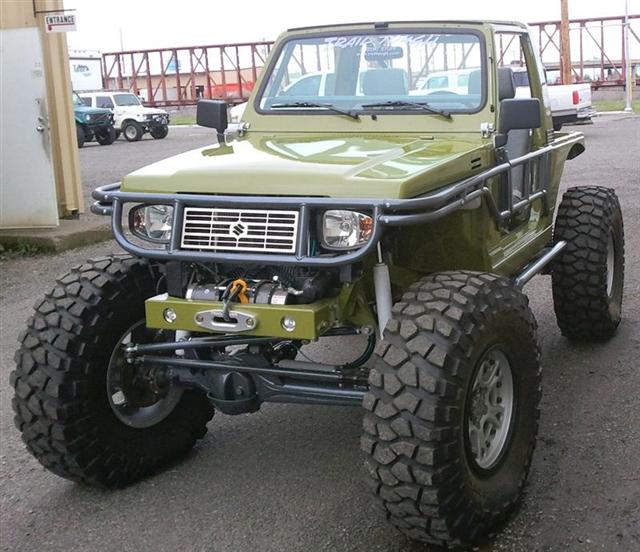

Yup i fully agree. was and still going to finish the cage like this one i found on google.

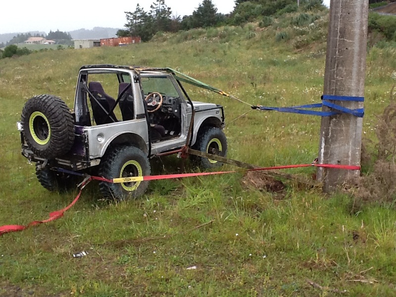

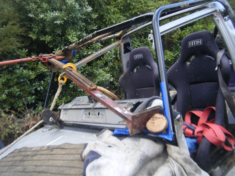

Gave it a go straightning out my cage worked a bit. Next plan is to put hi lift jack in side frame to see if i can crank the rest strate.
Mattrade
Posts: 386
Post by Mattrade »
Cranking out front to get it straight again. Hi lift started to bend so got winch on it to straighten it out. also had to bolt a extention on jack t make the distance....mish.
Mattrade
Posts: 386
Post by Mattrade »
After the front was strage again found that the drivers door wouldnt close, and that the hole thing had piveted around becuse lack of rear brace so got my bros truck out to pull it back.
Mattrade
Posts: 386
Post by Mattrade »
Straight as......I can get it :roll: But not bad. Determined to make is strong as hell now.

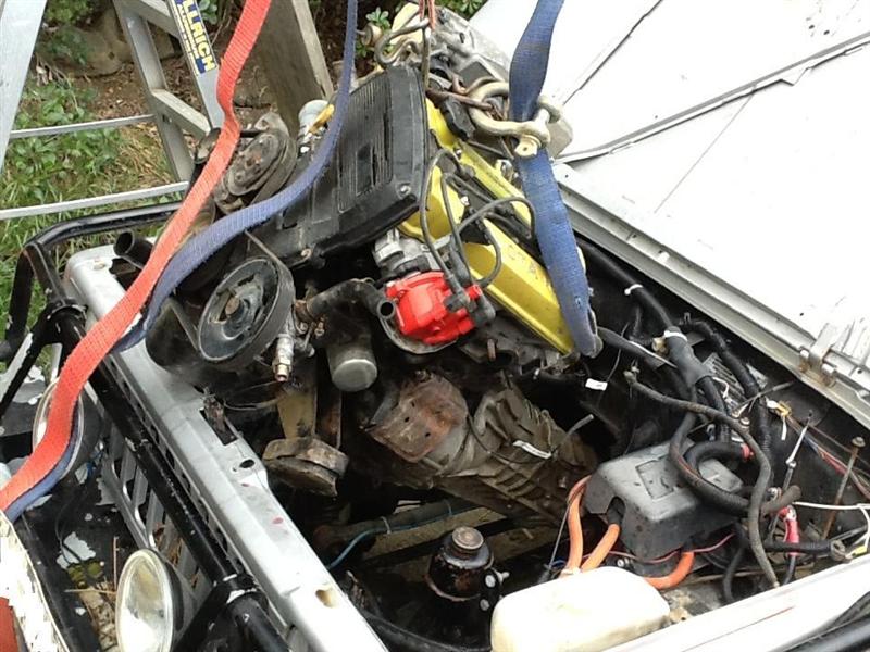

Post by Mattrade »
4age started to smoke and couldnt bring my self to replace it again so decided to upgade all together....

Post by Mattrade »
After much saving and searching i decided to go with a nissan 15 silvia.
Found a half cut from japan for resonable price and only 87,000ks on the clock.
Its a SR20det vvt blacktop with 184kw with a 6 speed manual so should fly :D

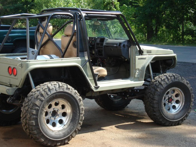

Found this on the web, thought it was a sweet idea. Lots of space for big tires. I think i might chopping the front section of the chassie just behind the suspention components and weld in maybe 200mm of chassie to push the wheel base out enof to fit engine and radiator. Any thoughts????

That's going to fly and do good skids.. Ha. Did you look in to using the supercharged 4agze from a levin at all? Might mate up to your box?? But otherwise could you not just move the rear axle back and the front forward?

Should be pretty good with that HP, I'm running a supercharged CA18DE (predessor to the SR) with a educated guess at 130KW at fly wheel, through auto box. Its more than enough for club stuff, but lacking for comp work. Wheel base is a bit longer then standard (front axle foward for fire clearance and rear back) and about to get a bit longer again and engine freshen up for more blow.
Not sure about the box you have but with the older 4 speed SR/CA autos you can lose 200mm ish out of tailshaft and use the spline on the output shaft that the handbrake pawl sits on. Thats how I made mine fit, custom adapted to lux transfer. But manual will be different.
Keen to see how it looks finished. I have kept front grill gaurds etc to fit comp rules.
Oh will be interested to see how you go for sump clearance also, oil pump on the SR hangs down a bit, making rear sump a bit harder.

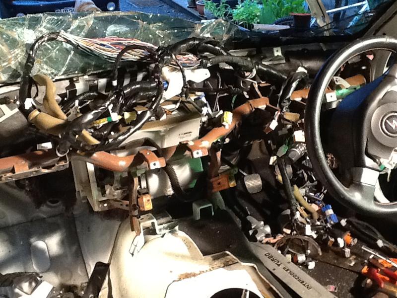

Post by Mattrade »
After all tested and running started stripping it all out slowly labeling everything i disconnected. So so many wires...
