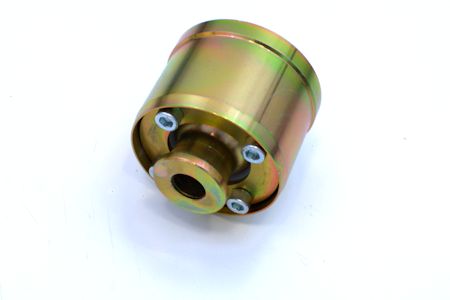

:lol: yeah, about that... remember this?
luckyme wrote:Upper bushing of front axle has shown some signs of wear for some time... I'm sure OME design is good for on road use, but offroad killed the rubber :lol: thats the only one bushing that stayed OME after the lift kit, all others been replaced with IRO stuff. Being the point that stops the axle wrap thought it'd be a good idea to replace it with something better, so went with home made :lol: propylux and double stainless casing around it. Will see if it lasts longer than rubber :mrgreen:
new vs old
in place
The good news is that the bushing held up very good :mrgreen: but when I was climbing *cough*...bouncing up some fairly steep bank with pedal to the metal the high tensile bolt decided to shatter to pieces. This caused the front axle to rotate and slide forward while fully flexed out, because of that the drive shaft pulled apart. And just for good measures the only original spring retainer(that i thought, why would i replace it with my own one a few weeks back :roll: ) broke off allowing the spring to pop out. Well, the landing after that not pleasant and fairly loud :lol: :lol: :lol:
The good folks from Auckland 4WD Club managed to put the spring back in while is was busy pulling out the driveshaft. Managed to pull the axle back into position with a ratchet tie down, chucked a screw driver through the now empty hole, tied it up with some wire and added some finishing touches with electrical tape.
Not saying it was a pleasant drive home, but we wobbled home safely.
the fix :mrgreen:

Hey man. With that bush you made is there some sort of spacer on the central crush tube to allow for flex or does the upper control arm touch the side of the stainless outer bush?
luckyme
Posts: 178
Location: North Shore
Re: Project Wicked Jane
Post by luckyme »
churchill wrote:Hey man. With that bush you made is there some sort of spacer on the central crush tube to allow for flex or does the upper control arm touch the side of the stainless outer bush?
I've chucked on some HD spacers ~5mm thick on both side cos with no steering damper I had decent horizontal movement going over bumps at highway speed :shock:
The IRO auxiliary damper kit should arrive in a few days :mrgreen:

Just an idea....... do you think the bolt shattered because the bush doesn't have enough flex? Its hard to tell how hard the bush is though, could be wrong. :D
luckyme
Posts: 178
Post by luckyme »
tomsoffroad wrote:Just an idea....... do you think the bolt shattered because the bush doesn't have enough flex? Its hard to tell how hard the bush is though, could be wrong. :D
Yeah mate, thats what I blame too 8) not my heavy foot :lol: :lol:
Im getting some flex joint with the damper kit from IRO in a few days, will see if that helps.
Thanks for the input though, always good to hear seasoned opinions, and I love your work, shame you are not up here :mrgreen:
