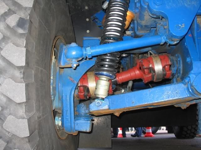

If you look at a Humvee or modular military IFS system, the 2wd steering setup is the same geometrically. So you can use all the wheel travel without the tierods 'binding'
But by all means go for it, experiment and see what works for you!
