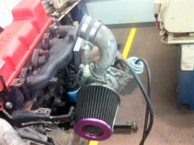

Some new goodies on the way for the truck.
Im quite excited to get this engine finished and in the truck.
I ordered the pistons today so they should be on the way.
The new / old exhaust manifold is on the way.

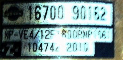

12mm injector is on the way

12mm nissan boost compensated pump?? Is that another bd30 goodness?

yeah the 12mm pump is bd30t stuff.

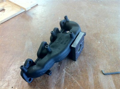

Im hoping to use that manifold to mount the big turbo. I may end up selling off my other setup and just running the big turbo if I can. Its not bad for a stock manifold huh ?

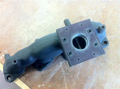

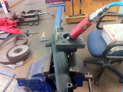

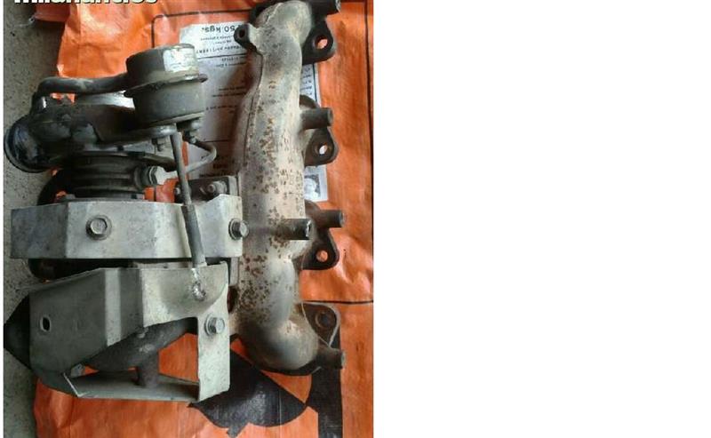

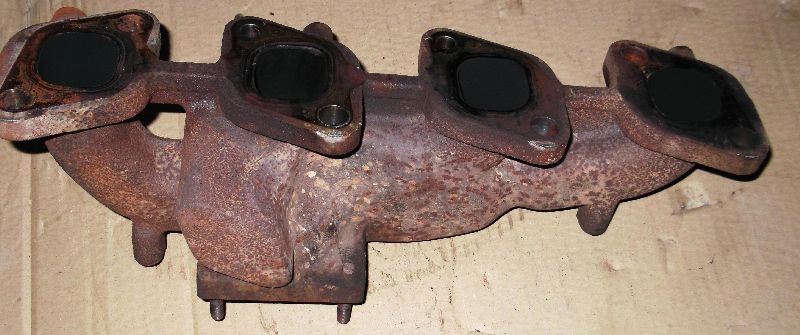

Yes I will have to make some sort of adaptor. or mill the face and and put a new plate on.

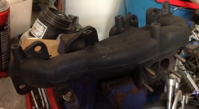

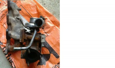

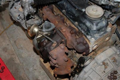

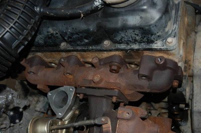

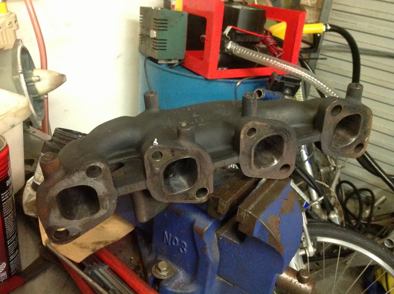

Here is another pic showing you the manifold and also a td27 manifold.
you can see the difference, one flows and the other one is a td27 manifold

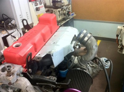

Im working on so many projects for this truck at the moment.

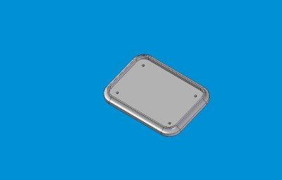

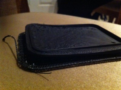

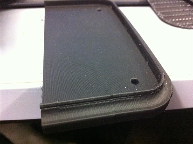

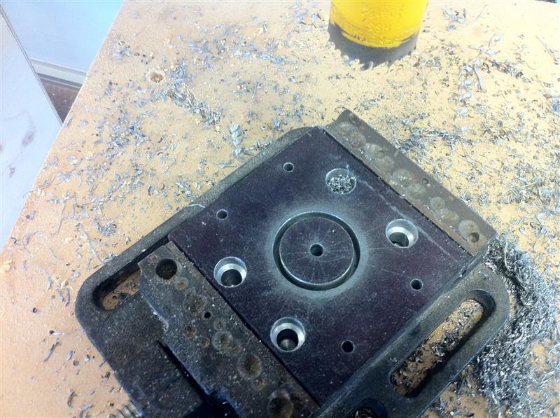

Here is the start of the case for my vnt controller. Since we have a 3d printer I will simply print it out and away we go. I just needed it to hold my arduino board.It looks like nothing at the moment but given time it will be all good.

The first print was a fail and I will have to sort the settings out.

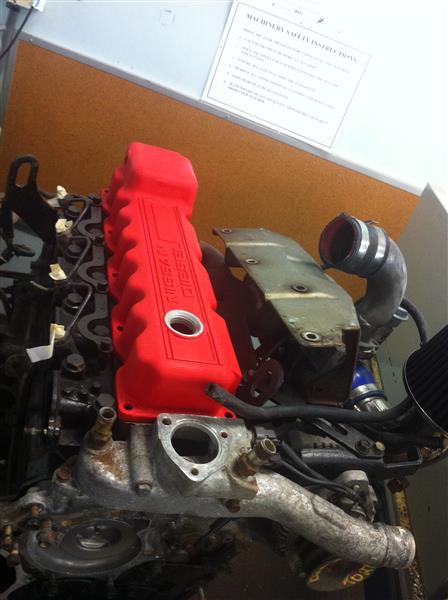

I also painted the alloy rocker cover the bd30 comes with. Im very happy the red wrinkle paint looks awesome

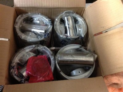

My new pistons also turned up so the rebuild will be starting soon I just have to finish stripping the block.

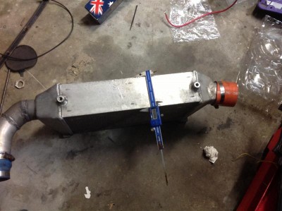

Here is the new top mount inter-cooler I will be running. I love body lifts it makes a huge difference to the room you have under the bonnet

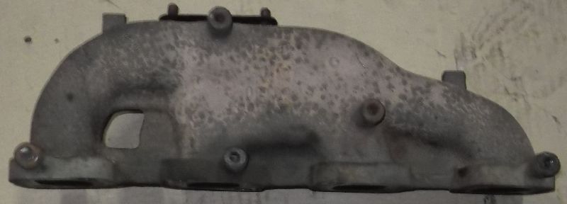

Well Got the finial part of the puzzle for the engine other than the rebuild stuff
Its the intake manifold
So much better than the stock one by a long way.
Im going to end up with two qd32 intakes which are a great add on to a td27 if anyone is interested.
http://www.desguacesanchez.com/piezas/m ... star%20(T5)/mes:0/jahr:0

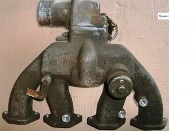

All you terrano owners look and weep with rejoicing. They actually do make a manifold for your truck that flows more than a maccas straw.

danielbeek
Posts: 106
Joined: Thu May 26, 2011 7:17 pm
Re: The navara terrano morph
Post by danielbeek »
Looking good...
Be great if you could dyno it back to back with a TD27T or QD32eti vehicle when it's all done. :P
So what is that latest intake manifold from?
With the QD32eti inlet manifolds, it seems there are two designs. The one that you show, where all four (long) runners bend 180degrees, and another where the runners collect into a chamber, and then a single pipe completes the 180 bend (similar, but still longer runners and better looking than TD27T one). Any idea what model/year do what?
slide
Posts: 895
Post by slide »
If I'm right, the 'long flowing' style are the qd32 N/A (d22 navara) and the ones that look similar to td27t are from the qd32eti (r50 terrano).
Vans (homy/caravan) are different again
wax
Posts: 510
Joined: Sat Nov 26, 2011 5:42 pm
Post by wax »
You pretty much got it right slide. the long runner one is a qd32 manifold
the other one isa bd30 intake manifold. I will be using the bd as it gives me room for the top mount intercooler.
I would love to dyno it afterwards I will hust have to take the big tyres off to do so as they will end up all over the dyno wall.
http://www.leboncoin.fr/equipement_auto/360049832.htm

Ah of course. Forgot about the n/a QD32. Any thoughts on whether the QD32ETI manifold would offer any advantage over the older TD27T one? Never seen one in the flesh but it looks a bit 'smoother'. The BD30 mani looks good (actually has runners..), but oh so rare.
Does that inlet pipe unbolt & allow turning it to point straight over rocker cover?
wax
Posts: 510
Post by wax »
Yes it does unbolt, but I'm going to make a better shaped one that flows better. I believe the qd32eti manifold is much like a td27 one. Not sure why they would do that, it may flow a bit better but stuff all

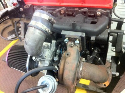

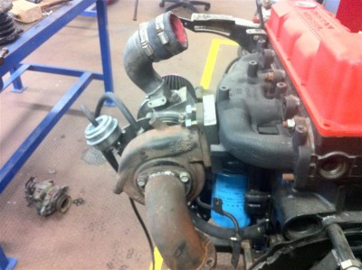

Well did some more work today the turbo is bolted on, port matched and ready to go. Im just waiting for the intake manifold to turn up and I can finish all the induction side of things

Opps they came out in a different order than I intended.
Any way the qd32 heat shield works just fine with a small trim so that was handy

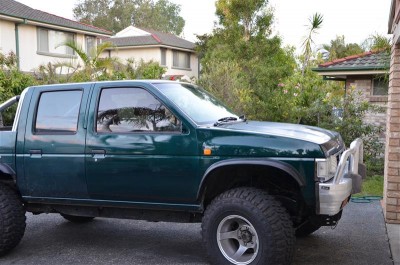

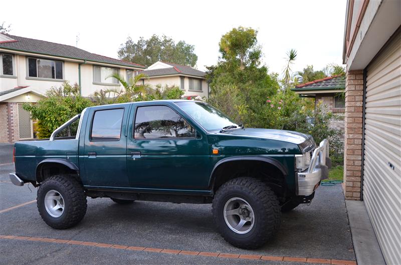

Well big day today removing old door and guards. Still havent got a new bonnet for it but that will be soon.
No big ugly snorkel on it now and huge rubber guards to keep the police happy. Im going to get some terrano mirrors for it. Im thinking the rear is going to need painting now as its all faded but all in good time

And navara's looking mean by the way looks good with the big tyres.
