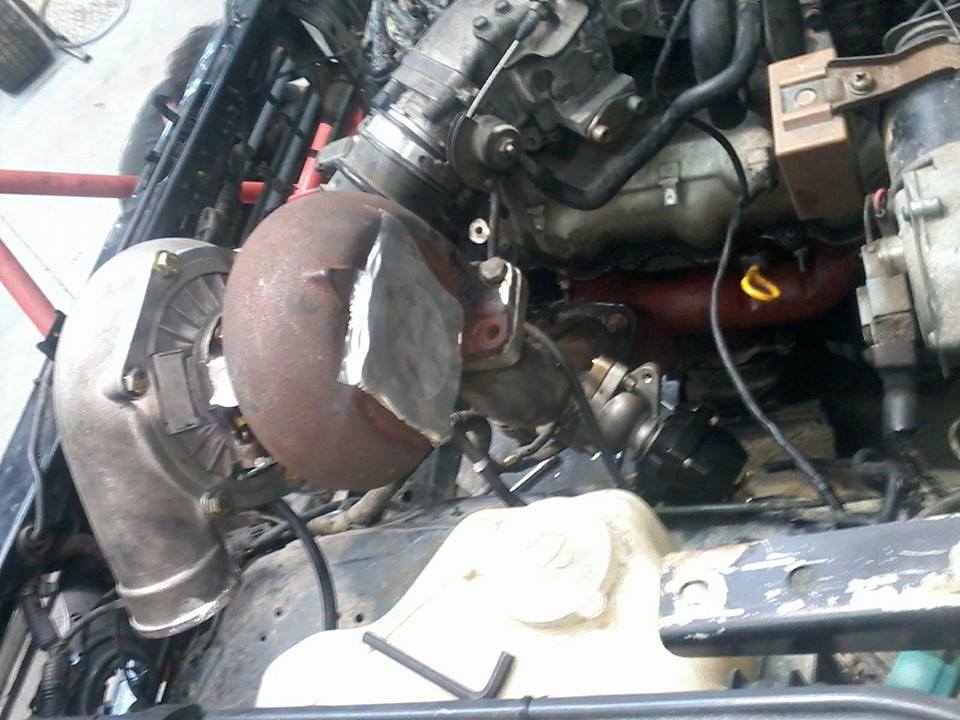

On the 1uz it had extra little ports on the heater lines at the rear,so I used those.. I've seen on td42 people tee off heater hoses..so I don't think either would be too much of an issue
Re: 1994 Pathfinder Build
I used heater hoses on my water cooler turbo no problems

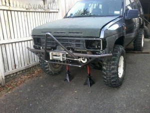

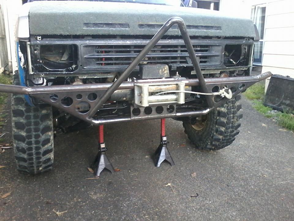

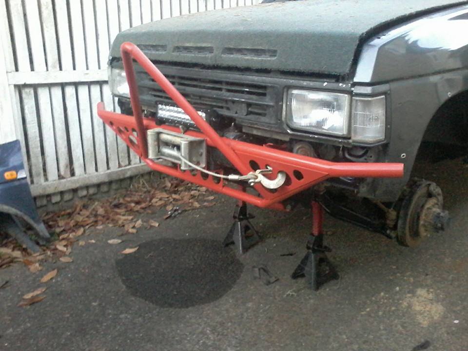

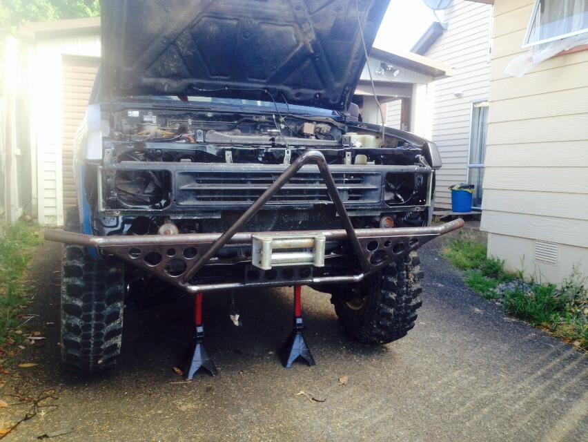

My front bar is now compelte... :D

lax2wlg wrote:Awesome progress
Tough little trucks these Pathfinders
Thanks mate! it seems to be taking forever though! Will be great to have it back on the road :D

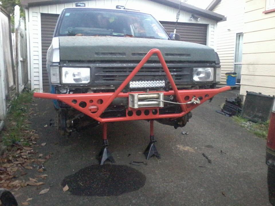

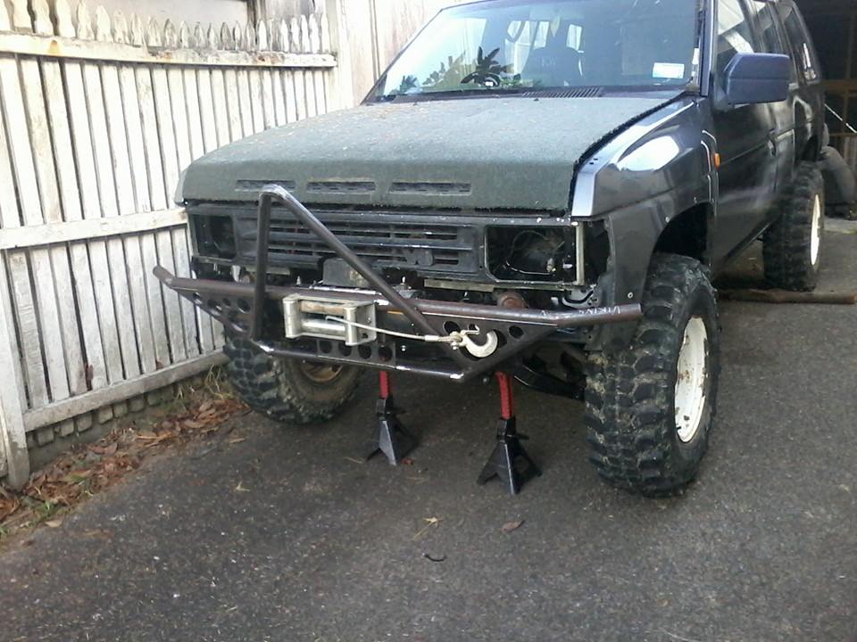

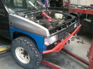

As for my actual truck.. I've bought some new Calmini upper control arms via offroad accessories in Christchurch so I am just waiting to hear back from them as to when they will be arriving! :)

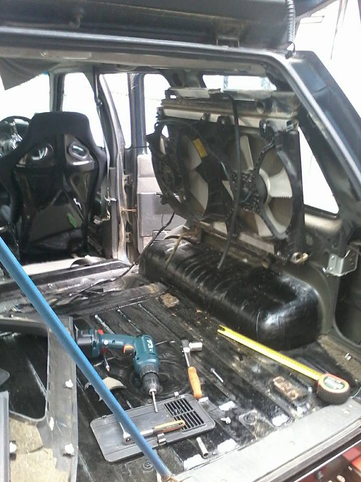

I've been running into issues with engine bay space. It may not be the most ideal setup, but i've got a nice little front mount intercooler now tucked in behind my winch, which is now set back a whole lot further. Because of this, I don't have room for my radiator. So i have now re-located the radiator to the back of the truck
I will be removing the window on the side and replacing it with "lexan" sheet and a NACA duct to assist with the cooling. It has dual fans which are on separate circuits so that they can be run individually. I'm guessing it's probably going to turn the truck into a mobile sauna but i suppose we will soon see how it performs ! :lol:

Good work. Are you keeping it road legal?

pretty sure there are legal issues with hot water in the cabin with out a firewall.

To help with heat issues in the cab, you could have the fans on the outer side pulling the air through the radiator and then out of the "window" maybe?

Since your doing that. Weld in a bulkhead behind the rear seats, with a window, so its then like a ute with a canopy. U could even properly seal the side pockets then you could hose it out. Get rid of both rear side windows for air flow etc

It's going to be "Road legal" :lol: if you get me haha. The only driving it will ever see is bewteen home & the bush. So i'm hoping i won't have to much trouble with the law. I can get it a warrant with no issues though. I would like to see what it would fail on for a cert though - if it's going to be too much then it will become a dedicated trailer truck. I've made sure that everything is built correctly without cutting corners so don't get me wrong, i'm not going to have it on the road if it were to ever put anyone else in danger!
I can imagine that there would be some sort of issue with having the radiator where it is though like sheepy said if it were to be completely road legal.. Haven't really thought ahead as to what other options there are with it. Would like to see how it performs first like this before worrying about that i guess

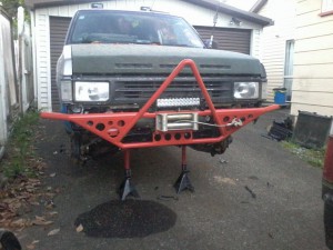

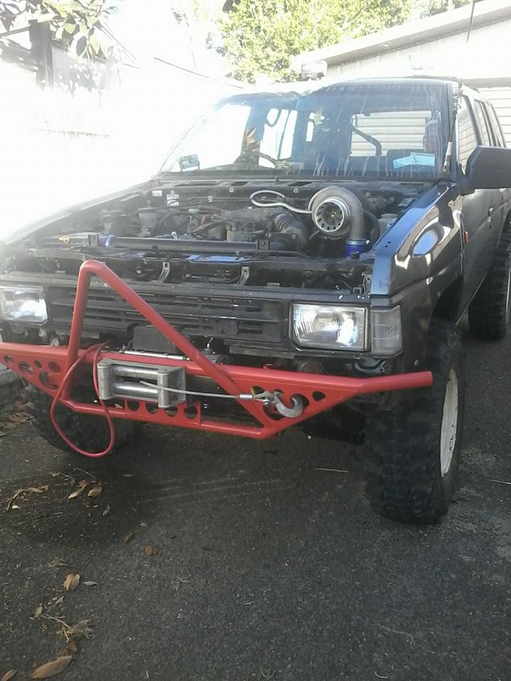

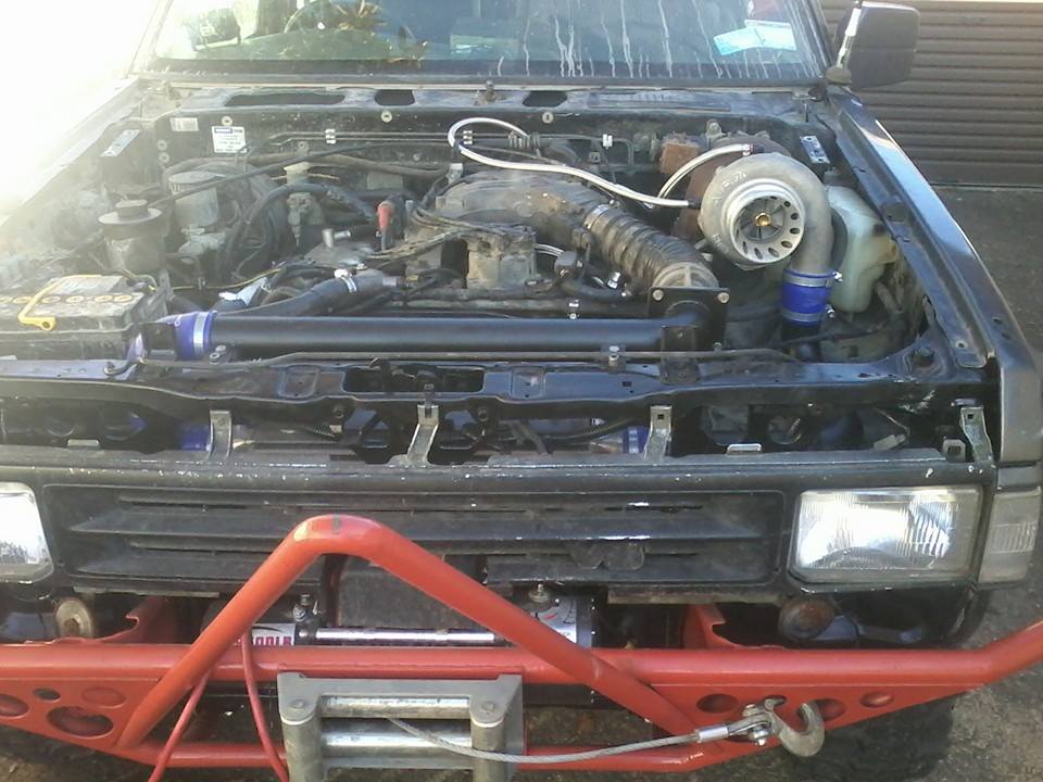

Here's a couple of photo's of how it's looking at the moment! I bought some new headlights and corner lights so it's starting to look pretty fresh!

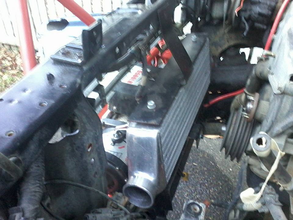

And the intercooler setup so far...

Sheepy wrote:pretty sure there are legal issues with hot water in the cabin with out a firewall.
the heater pipes and radiator sit under the dash inside the cabin :D

Ever seen a hot radiator tank burst..... the heater core under you dash is surrounded by plastic....even if it did rupture, no direct line of fire for the hot coolant.

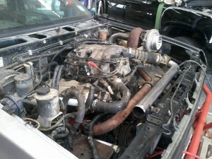

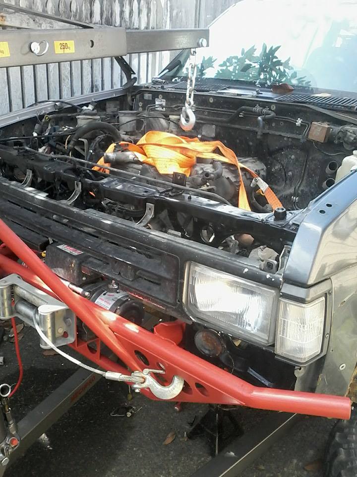

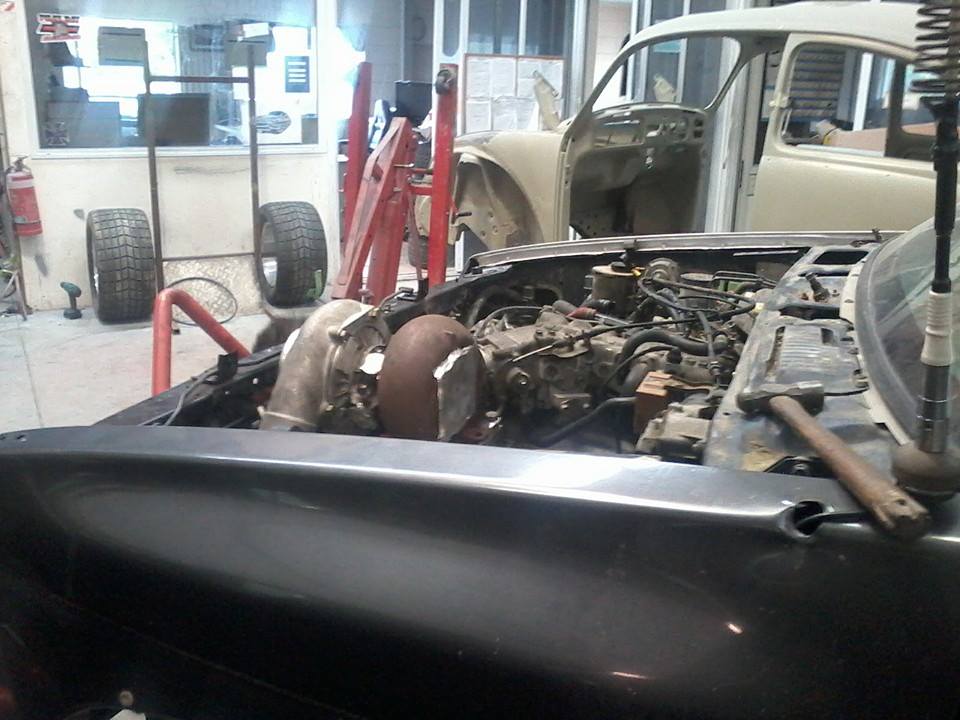

Having a joyful time removing the old engine.... F*ck! Whole subframe has to come out so the blody sump can clear the front diff.... What a joke... :oops: so pissed off!! :evil: :evil:
The new engine is all ready to go in now though. The old one is 3/4 of the way out but i lost patience with it and gave up! The shaft on the gearbox has only just cleared the splined section and is getting caught up on the last little bit but can't go any further foward with the engine cause the sump catches on the front diff and the gearbox is slid back as far as possible without completely taking it out! Got in contact with a friend's dad who's always keen on cashies so he's coming to give me a hand with it cause i've had enough of it already! :evil: I've done a fair few engine conversions but never stumbled uppon one that is this much of a mish! - maybe because it's mine & not someone else's ? I dunno , but i recon it's a very poor design nissan! not impressed ! Definitely will not be doing this again any time soon :lol:

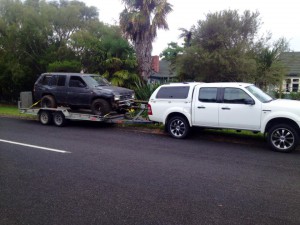

I gave up on the idea of putting the motor in by myself on the driveway! Had the truck transported up to Real Rides Ltd in Silverdale. A good friend of mines dad owns the business and he said he would be more than happy to help!
So the truck arrived up there on Monday afternoon. By the time I made it up to the workshop just before closing, the old engine was out and the new one was almost ready to go back in.

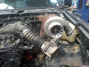

There's been a few changes to the setup so far that make a little more sense. The radiator is staying up in the back although the piping will now be routed through the floor bellow it and under and alongside the chassis to the front. The drivers side exhaust manifold has been flipped so that it too is now forward facing like the turbo manifold to minimum the length of piping needed to join the two banks together. The new engine is all in place now with new clutch and all the other crap. It's almost ready for startup as soon as the exhaust is finished and I get it some new engine oil & a filter.
Made alot of little changes... Alternator & power steering have all been relocated and other bits & pieces ...

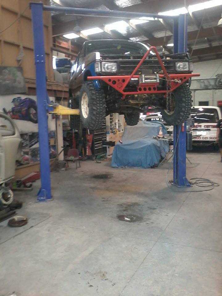

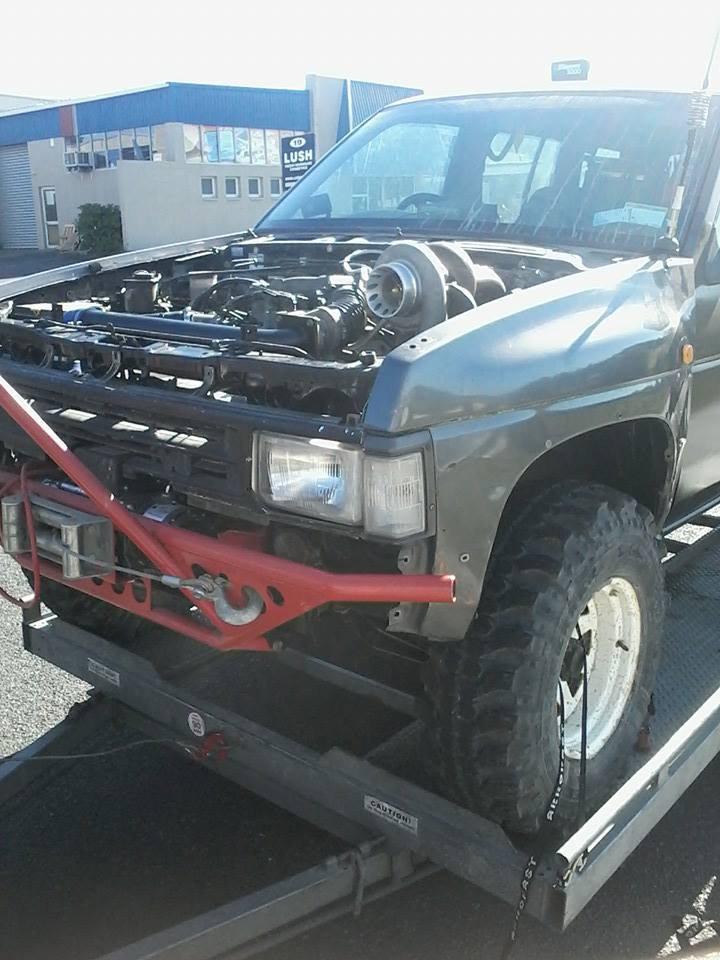

I can now announce that the truck is done! well, the truck will never be "done" but the engine is in & running :) kayton up at Real Rides Ltd finished the truck earlier today & #### me does it haul ass.... Definitely made the mistake of running such a large turbocharger as it does come onto boost a little late but once it hits it around 4500rpm it struggles to keep traction on the 33's in the dry... So i think it is fair to say that the power increase so far as been fairly significant for only 7psi!! I will try link or upload a video of it running for all of you, for the meantime it is just pictures though!
Still have heaps of bits & pieces to do before it can go out and play in the mud! Will keep everyone updated as i make progress! :D

Good to see actual progress with something that initially was a big task and a bit outside the box.. All to often projects start off big and then slowly fade away ( mine included)
Your motivation should be huge now its running.
Shame tho about max boost at high revs, not ideal for wheeling, hopefully you can sort that

Thanks man! I really do appreciate all the help & information that everyone has given me to achieve this! I'm really really happy with it right now! Unfortunately, already i have run into my first problem.. I replaced the manifold studs & gaskets & already the drivers side bank has blown the manifold gasket out at #1 cylinder, so it's loosing a whole lot of power cause of that leak & it sounds like shit too! I believe this is probably contributing to it not spooling up very well too! :evil: So i'm a little gutted about that.. But, onwards & upwards! It's only a minor set back at this stage, so i will now double up the gaskets as recommended by a few people.
I was told at the start that this turbocharger wasn't going to be ideal. But i'm still not admitting defeat! I will make it work!! haha

You might need an expansion joint in the exhaust cross over pipe between the two banks, when the pipe heats up it expands and might force the two manifolds apart causing the blown gasket...

I can completely understand where you're coming from there! Just picking brains at the moment, but would it not be the same as the factory one then? Cause that doesn't have a flexy either? :idea:

Check this out, if this is the right manifold there is an expansion joint in the middle. scroll a little way down the page:
http://krasnoyarsk.baza.drom.ru/nissan-vg30det-kolektor-i-forsunki-12045535.html
according to calcs with a 600mm long pipe at 700 degrees the pipe lengthens by 5mm over room temp length.
