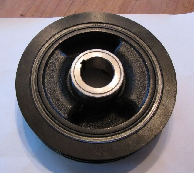

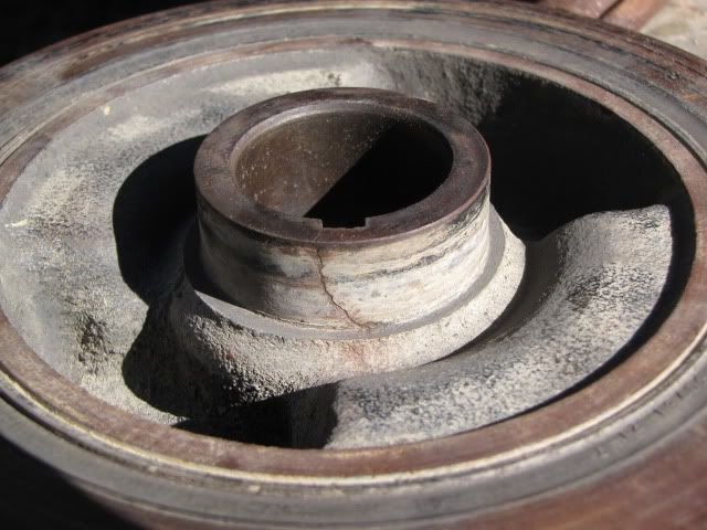

Another mod coming up. This morning found my Crankshaft pulley is cracked.
This is the second one so will get a sleeve made up to strenghten the new one and hopefully stop it happening again.
Cheer Richard

Hi Richard, what is causing your front pulley to crack ????, is it because you are driving the supercharger off it ??.

SMOKEY wrote:Hi Richard, what is causing your front pulley to crack ????, is it because you are driving the supercharger off it ??.
On looking back through your build thread I noticed your top of diff wrap/tramp bar is fixed at both ends, how do you allow for the spring shackle movement ????, have i missed something or is this a cunning plan ????,
COULD WE PUT A TAIL ON IT :?: ,
FITZY.
Hi Fitzy
Yes the Supercharger is causing the Cracking when I turn it on at up to 3000rpms.
I am having a sleeve made today to strenghten the pulley. That is not the answer though.
The main problem is that the supercharger is shock loading the bracket mounts and the Pulley and causing the cracks.
I have decided to spring load the tensioner to absorb some of the shock and I think that will solve the problem.

Got the new modified pulley back today so should be alot stronger
I will check out one of those Cummins adjusters Fitzy. Thanks for the info. I have already started to modify the old one and because I am running a trip this weekend for the Nelson Club might have to use a make shift setup to go on with.

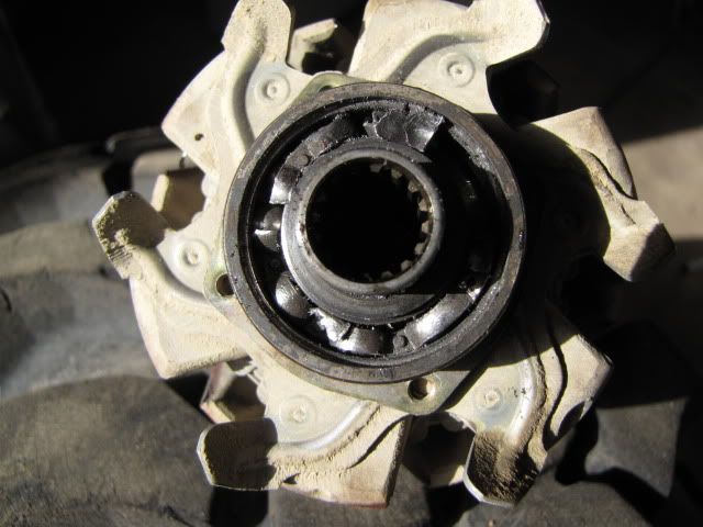

One stuffed alternator bearing. The result of rallywood bog
Cheers Richard

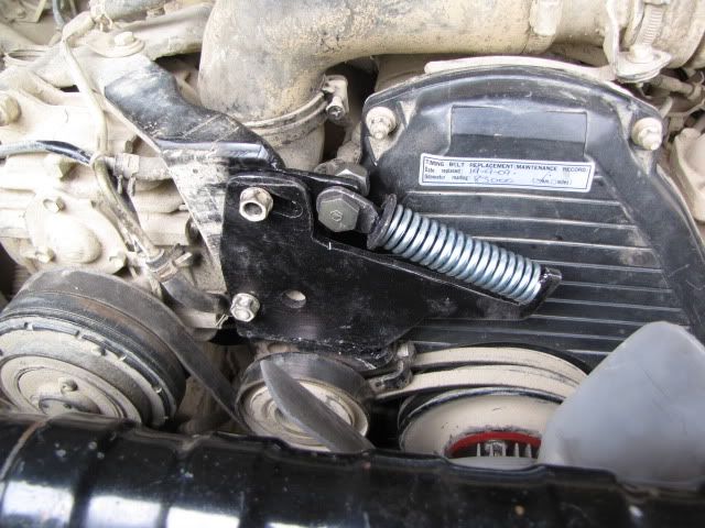

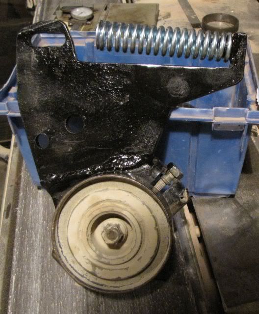

A bit more progress today on my spring tensioner for the supercharger belt to stop the shock loading on the crankshaft pully.
All I need to do now is make a screw adjuster for the spring and hopefully the spring will be strong enough.
Cheers Richard

More progress today on the tensioner and the spring seems to have the right pressure. Just need to work on the hinge bearing now.
Cheers Richard

Post by Bulletproof »
Got the supercharger spring loaded tensioner finished today.
Works well and takes the shock loading off the crankshaft really well.
