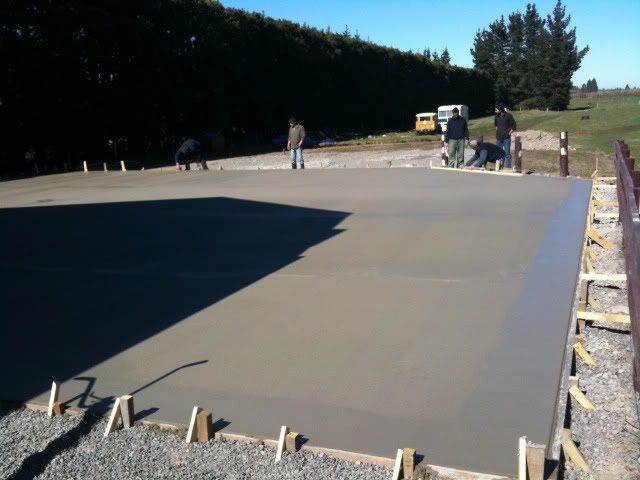

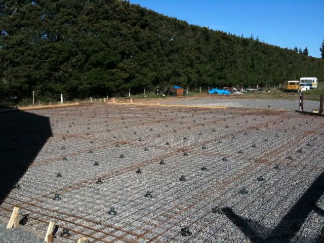

Me brother has just had the 16 X 17m concrete pad laid next to the barn today. Just a small degree of a run off added for rain, but it's been made with mind set to burn rubber. :twisted:
But yeah, really, it's just a work area off the barn. Not a burnout pad. :lol: :lol: :lol: :lol: :lol: :lol:
Man it's looking good!! A week from now!!! Rubber burning time.
I'll be throwing up plenty of youtube vid. Some of the Cruiser smoking up for sure. :wink:

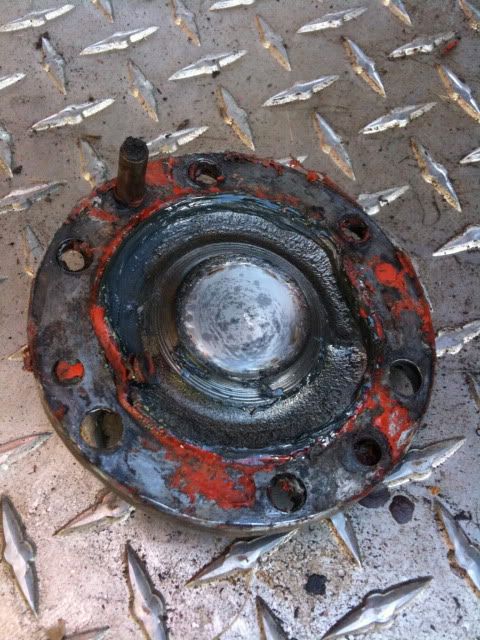

Broke me right rear axle trying to smoke the tires to many times today. :lol: :lol: :lol:
:cry:
petefj40
Ms Daisy
Posts: 4218
Location: The Mainland
Re: petefj40's build/mods
Post by petefj40 »

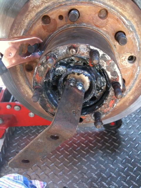

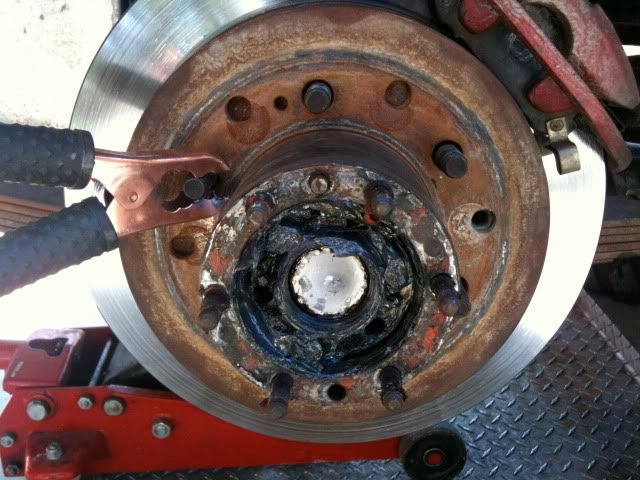

I sheared the hub off the axle. :lol: :lol: :lol: :lol:
Had to tack on a bit steel to pull it out.
So if anyone has a spare right hand rear axle in Chch I'd be happy to pay you good money for it.
Cheers.

I would be a little worried about your bearings now after having a welder earth through them

Jezza wrote:I would be a little worried about your bearings now after having a welder earth through them
Good point.
Something extra for me to watchout for.
I was as brief as I could welding. I didn't want to heat up the axle seal.

i would of put ur earth onto the piece of steel you are using as a puller to avoid the bearing issue
plus the chance of it arcing the axle to the spider gear
but yeah there was a fella in chch selling a complete full floater on trademe maybe worth a shot

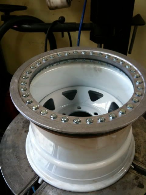

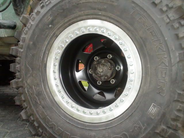

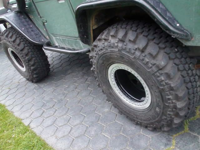

The bead lock rims will be ready to go on today!!
They were powder coated black and the alloy locking ring brushed up all shiny. :mrgreen:
petefj40
Ms Daisy
Posts: 4218
Post by petefj40 »
They just need mud on em now. :D

Very nice pete :wink: , but yes a little too clean :lol: :lol:
dont be hitting rocks etc with them
they will break easy

Being straight up. The silver on the rims is taking me a bit to get used to.

Post by gary_in_nz »
bloody hell thats a nice piece of kit to add to a nice truck. who made those up and if your allowed what are they worth a piece??
petefj40
Ms Daisy
Posts: 4218
Post by petefj40 »
hi Gary.
$450 each mate. Included powder coating/fitting/balancing. But if you supplied the rims it would be cheaper.
Rick at 4X4 ACC sorted them out for us.

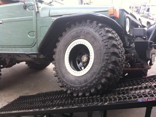

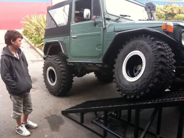

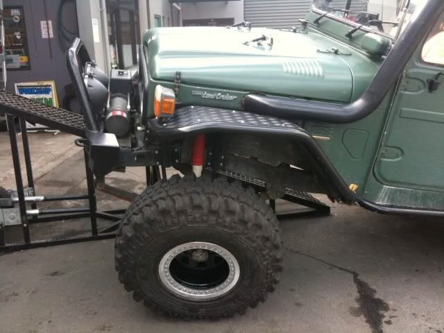

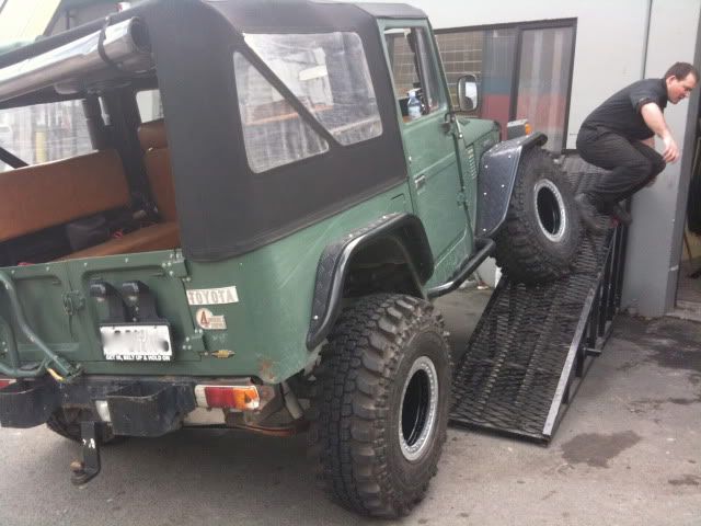

Was on the ramp today.

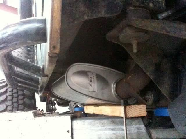

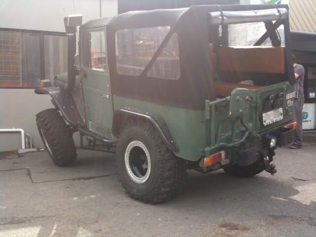

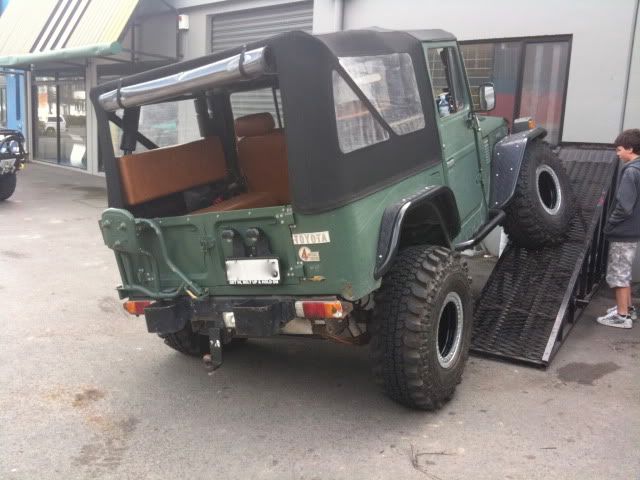

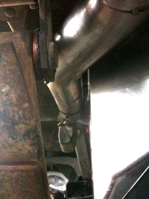

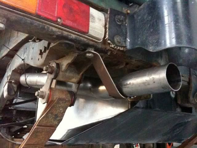

Some pix of the pipes new location. This is the left side. The other side to be modeled.
petefj40 wrote:Some pix of the pipes new location. This is the left side. The other side to be modeled.
dont bother with the other side dude
trust me single all the way
sounds sooooo much better

those mufflers aren't the lowest part of the vehicle are they?? (could get messy!!)

i agree with skid on that pete .if you are going all the way to the back 2 into 1 sounds the shiz when on song :D
