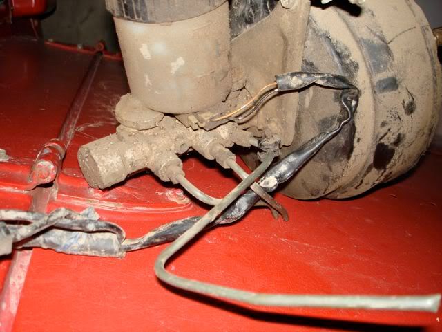

Can any one tell me what the three pipes are for on this 92' terrano brake master cylinder which is front/rear brake :?:

Front one (away from big booster) is driver's side front
Back one is passangers side front
Middle one goes to rear.
