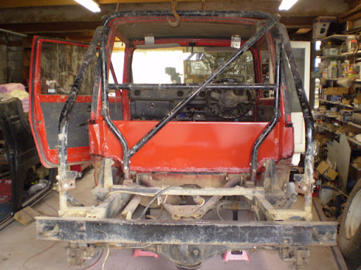

Well after another crapping day at the fun trials on Sunday , great day , just more fuel issues . Had to put another fuel pump in as it died lining up for the first hazzard . Then all day it would die and come right again . The conclusion is my pick up in the tank has packed a sad . I suspect it has folded over on itself and started blocking , either since I ran it out of gas or after the bonce on its nose at the second trial . Pick up was welded into the tank so it would have to be cut open to have a look , so decided I may as well make a new one .
An hour and a couple of cut off wheels later I have access to the tank .
I feel much better now . Althou I spent the day at fire trianing and on the way home thought I could do with some more practise , alas no , it will have to keep going for another year or so now . Too busy to build a new one .
Removing the back will allow me to fix a few small things that have been building up , but none of them on there own justify it . The rear axle has 50mm bump stops to stop the a arm coming up through the floor , problem solved :)
The battery will move to the back , to give me space under the bonnet for a future mod, wait and see .
The tow hooks can get mounted upright since the rear tailgate has gone .
And the body was getting beaten up on the corners so its out of the way now and the chassis can be shortend a bit .
And most importantly I can mount a tank behind the seats and not have it in the tray , a fire under the floor is better than a fire around your feet . Will go and work on tank shapes and see what I can fit in .

Well got the back panel in and painted this weekend . Made a cardboard template for the new gas tank . Thanks for the offer Yorick and others but to get it to fit the space its going to be an odd shape . I want it standing up as much as possible to keep fuel at the pick up on angles etc . Will post more pic's of it once its made and in place .
