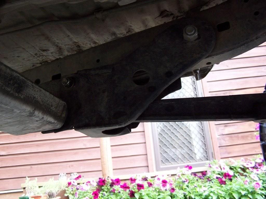

Some front end pic's of bulletproofs lux below.
Almost make me want to sell the Safari and buy a Lux
