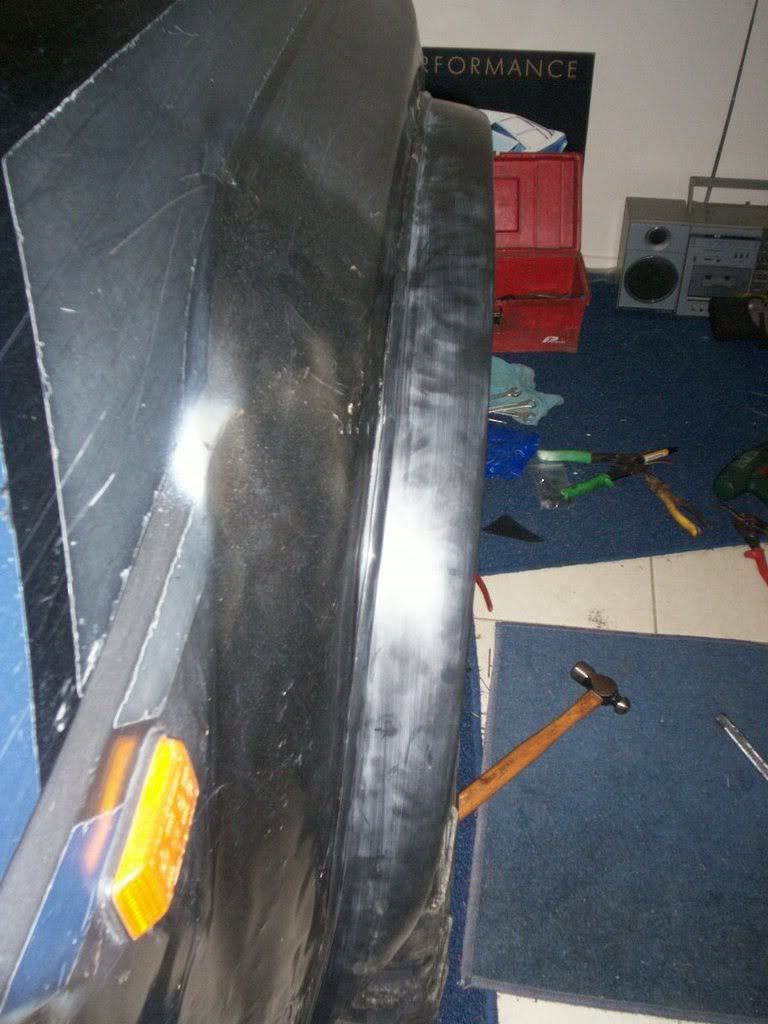

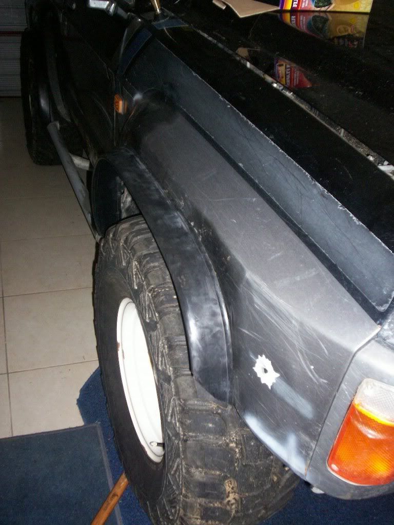

have got some rubber flares for the trip to ralleywood , that wire support for the outeredge what a pain to fit :shock:

Another option is conveyor belt offcuts - try Blackwoods, they have a conveyor manufacturing division.
daneo
Posts: 28
Joined: Thu Mar 20, 2008 12:10 am
Re: Flares
Post by daneo »
I had trouble feeding the wire through mine too, i ended up tearing the flares a bit because i was forcing the wire through to much. Ended up installing them with a couple of screws first and getting the right cutout shape then taking them back off, squirt some wd40 down both ends of the flares and then feed the wire through when they aren't mounted on the guards, takes a little longer but much easier, :wink:
