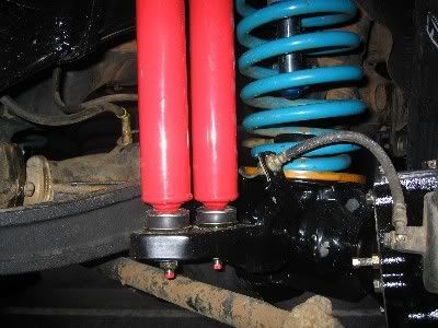

Here are a couple of photos I found on the web a while ago. I dont remember the site they are off.

tgaguy1 wrote:Here are a couple of photos I found on the web a while ago. I dont remember the site they are off.
Thanks for the pics.
It looks as if the main spring is adjustable as well. Might be a good idea

Bulletproof wrote:It looks as if the main spring is adjustable as well. Might be a good idea
Thank Richard
Normal coils I think, but adjustable bumpstops

I don't think that one has adjustable spring perch's. It does have some of those nice hydraulic bump stops though. There would be enormous stress placed on the housing when being driven in anger with those shocks hanging out the side :shock: (needs lots of beefing up from there).
Adjustable spring perch's are a good idea though Richard, can be of use if you are using really soft spring rates. I made some for the back springs on mine, but don't actually use them much.
Another thing for you to try is to hook your winch to the housing and pull everything together. The yanks have been doing this in their rock rigs for years, seems to work alright, but I have never tried it.

rokhound wrote:I don't think that one has adjustable spring perch's. It does have some of those nice hydraulic bump stops though. There would be enormous stress placed on the housing when being driven in anger with those shocks hanging out the side :shock: (needs lots of beefing up from there).
I have an adjustable perch on my rear centre spring and the idea of adjusting the front apeals to me because Hilux always sag on the front drivers side.
Bad design Battery , steering box , fuel tank , driver all on the same side so to put extra pressure on the front spring would be an advantage.
