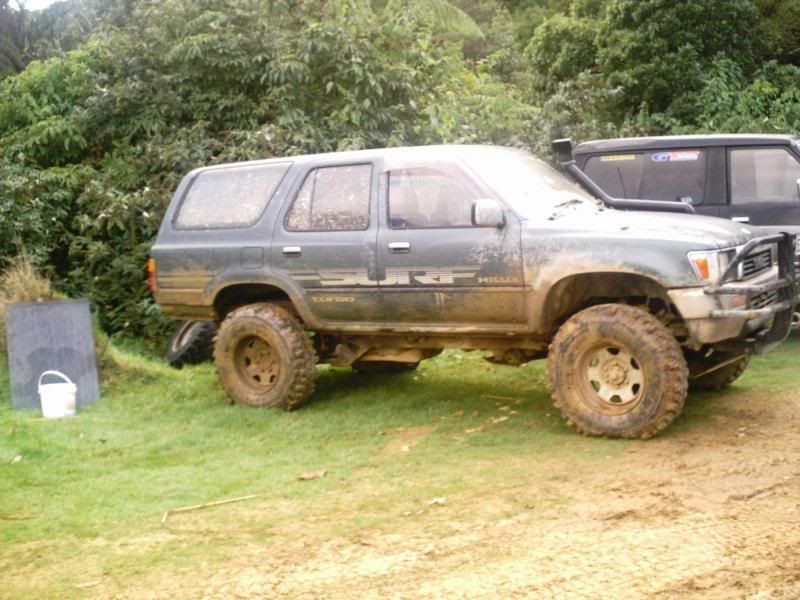

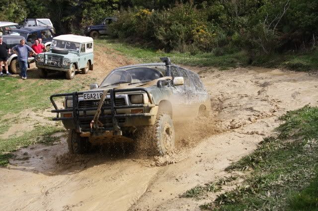

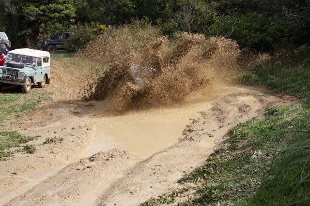

Post by taz01 »
yep gonna get flak for this but its a
91 ln130 ifs model
2.8 non turbo engine
front auto locker (lockrite)
steel snorkel
60mm body lift
34 inch super swampers 2x new 3x 15mm tread
5x 30 inch road tyres
cd/mp3 player
bullbar ,tow hooks
wof til oct
reg til april 09
$3200
