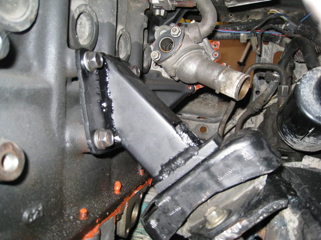

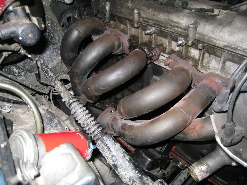

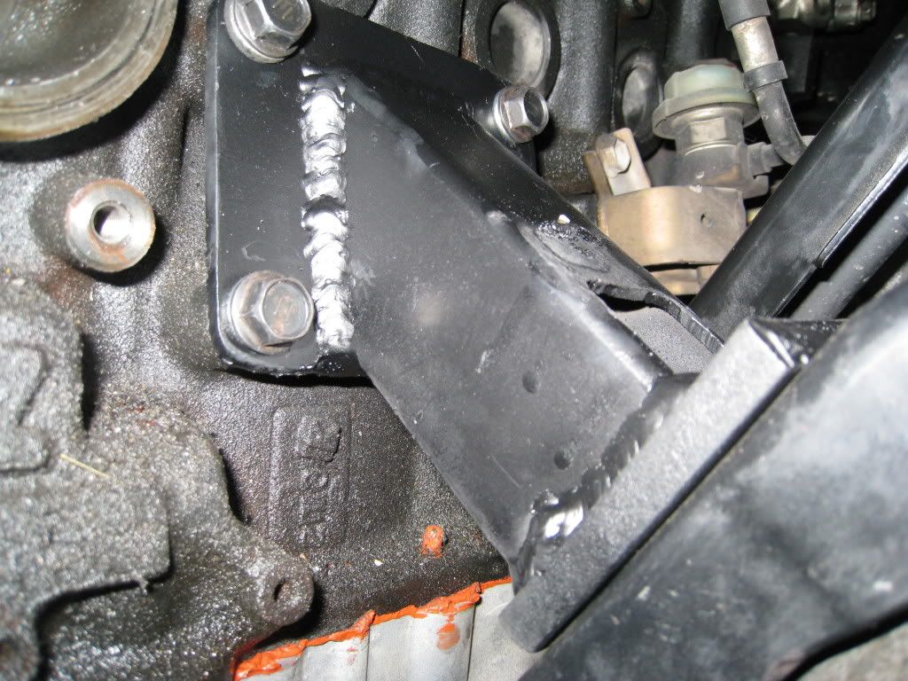

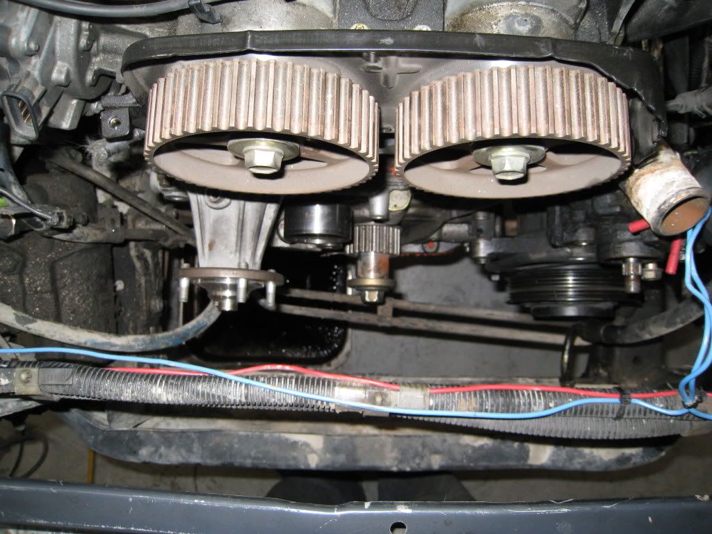

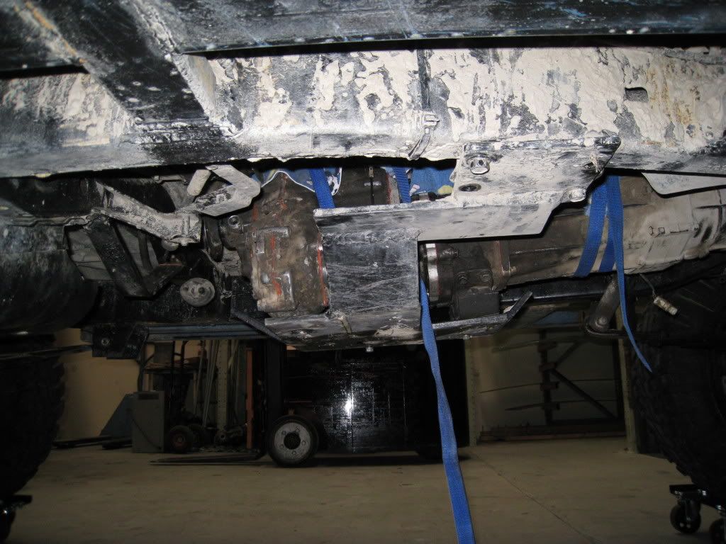

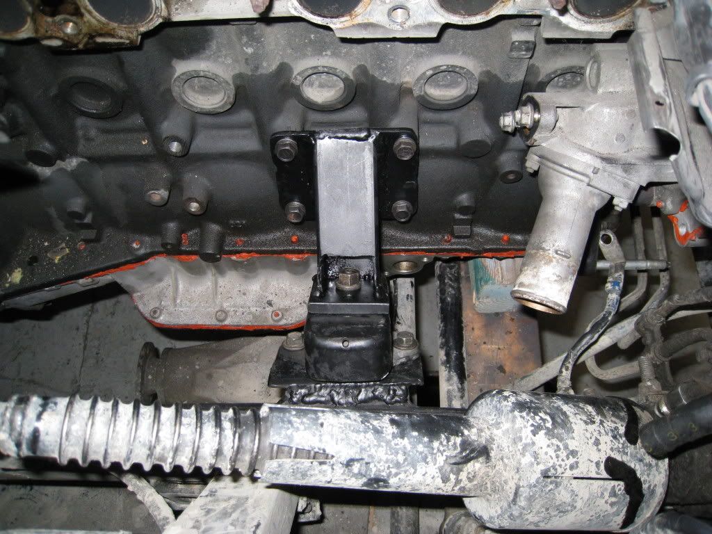

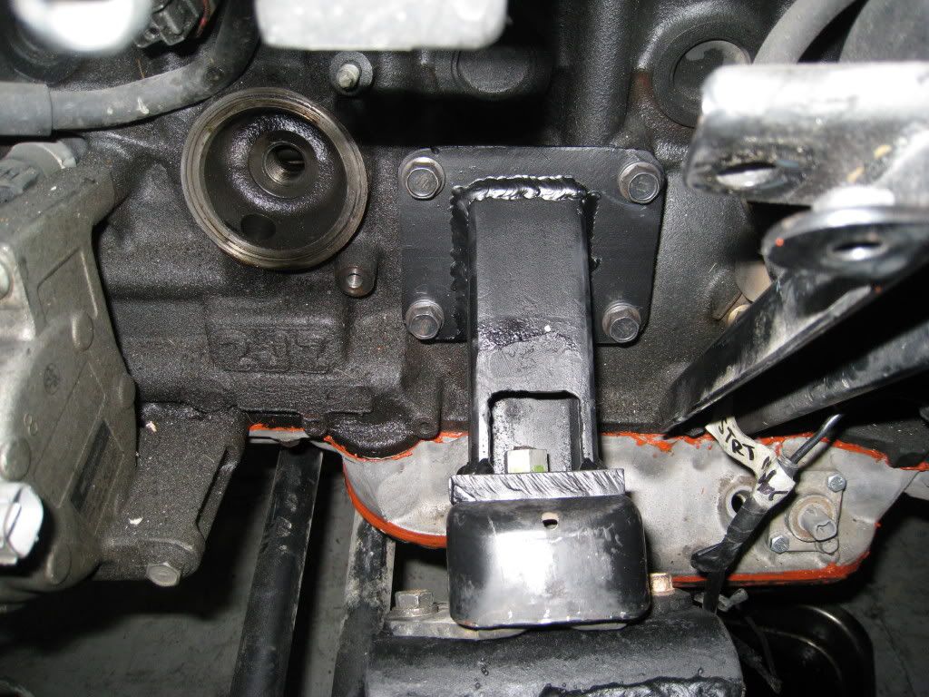

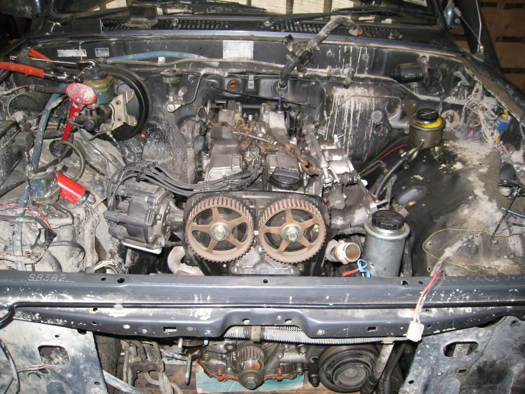

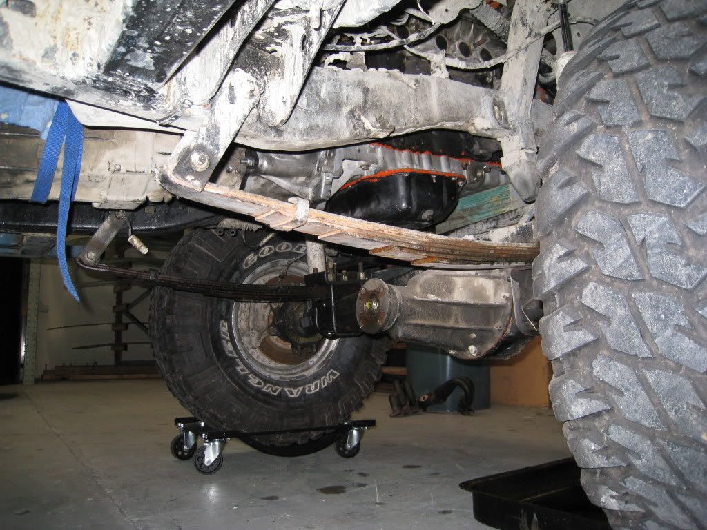

well managed to take firday off work this week because of the rain so managed to put the new fly wheel and clutch onto the 2jz. we also managed to get it all boulted together and get the motor and box in the hole in one go thanks to cool tool number 6 . we spent some time shaging arround thinking about the engine mounts and how to make the up which we mucked arround for a coupple of hours got it looking good then found the fork lift hav lost some pressure and the motor had droped :roll: :roll: :oops: :oops: :oops: . so I returned today and got it all set up and made some new mounts and got a few little jobs out of the way . here go some pics
the engine mounts
how much room I have for the radatior
had to modify my hedders to make them fit on
my dual transfers and low profile crossmember
mid bowl sump

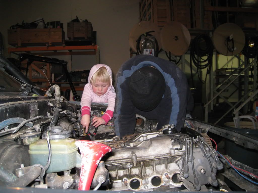

Then the wife turned up with my apprentice :lol: :lol: :lol:

Steve_t647
Posts: 998
Re: CTR's new toy
Post by Steve_t647 »
Engine mounts look really clean, as it is for rock crawling do you intend to add some limit straps to the engine mounts for "if" it gets upside down? Are you still thinking LPG?
Keep up the good work and train up the apprentice well.
Legal disclaimer: Any information I may have provided is worth exactly what you paid me for it.
Chopper01
Rock God
Posts: 494
Location: CHCH
Re: CTR's new toy
Post by Chopper01 »
yea I will put on some limit straps just incase the rig is on its lid the motor wont fall out :mrgreen: :mrgreen: no I wont be going for lpg in this rig as its a injected motor

Steve_t647
Posts: 998
Re: CTR's new toy
Engine mounts are bolted each end but the rubber mounts in the middle are good when gravity pushes down (in them compression rubber for shock absorbing effect). Upside down you stretch the rubber and it will rip.
Chopper regularly drives extreme angles and savage jaring that will cause these rubber mounts to rip and tear.

Post by Jafa »
Limit straps on your engine mounts because of the extreme torque generated by low gearing, ie dual transfer cases and low gearing in the back case. If you jam a wheel and try and drive out the torque transfers through the drive train and will rip your engine mounts in no time. Thats why we build engine mounts like this

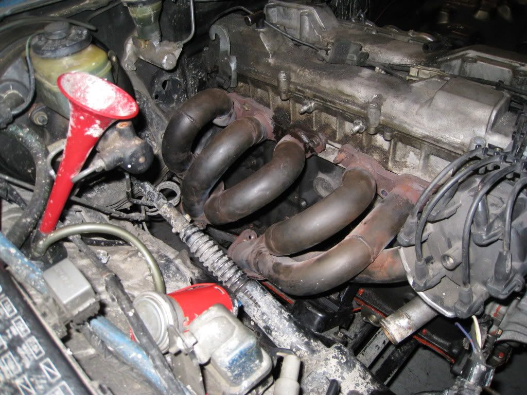

Post by Chopper01 »

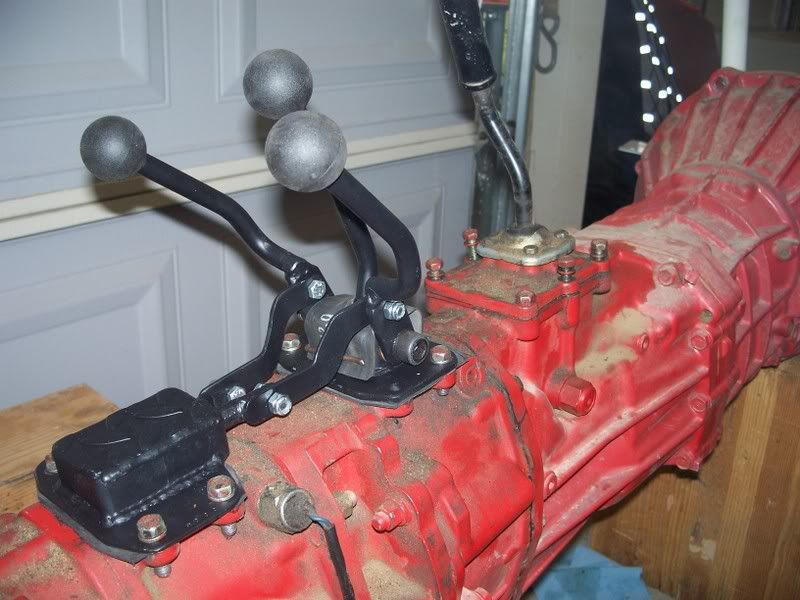

did some more work on the exsaust today trying to make the exstractors fit
but was looking on pirate and found these shifters
I think I will have to make a set for my shitter :twisted: :twisted:
