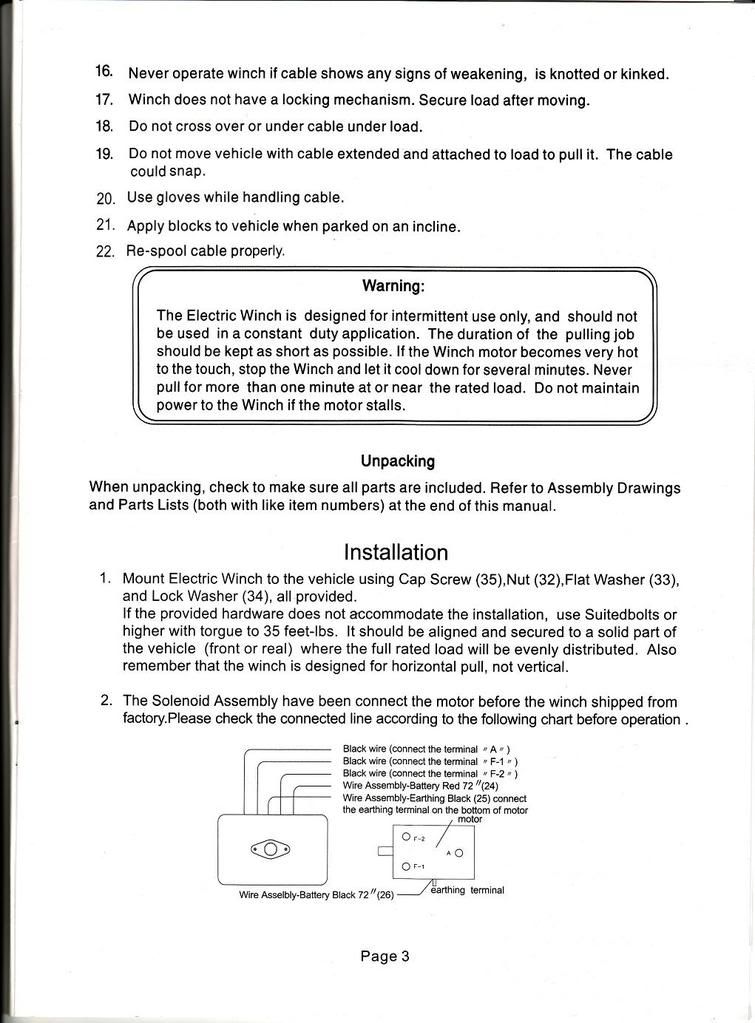

hope this is what you want it is for my 9000lb winch

I need the wiring from the solenoid pack to the winch motor, and what each terminal is on the winch. I'm assuming the bottom terminal is ground as on the previous diagram, but my wire colors are red, blue,yellow, and a long red one which i think goes to the positive battery terminal.
Re: Runva winch wiring
Looking at top with the winch sitting as it would be attached to a vehicle, red on top of yellow and blue towards the outside. Make sense?
Black goes to ground and the long red one to the battery positive.
