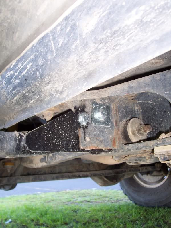

Just wondering if you guys have any pics for mounting sill bars on a swb safari having difficulty with it. heaps of room for a mount at the rear just the front im having trouble getting my head around.

there is diy instructions on mudrhino.com. have a look there mate it will give you ideas
Re: safari sill bars
ARB style mount two bolts you see a third is inside the two plates

I made front brackets to fit around the chassis rails - you have to undo the swaybar plates to get them on, and they need to be a separate part from the sliders (ie: they bolt on) so you can wiggle them on, but I thought it'd be stronger than bolting to the bodymount bits (mine were already bent to somewhat).
Theres more photos here: http://www.flickr.com/photos/tel1_nz/sets/72157606465597927/ or PM me and I'll email you a word doc with a few notes as well as the pics. There's plenty wrong with my sliders, but (even a bit bent) they still work fine. There are easier ways, but I was having a play with learning welding as I went, and had a lot of fun making these.
