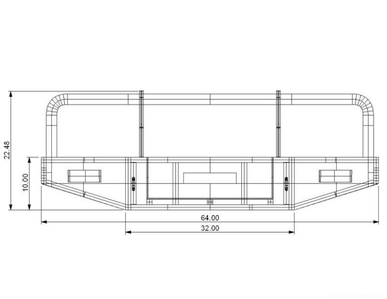

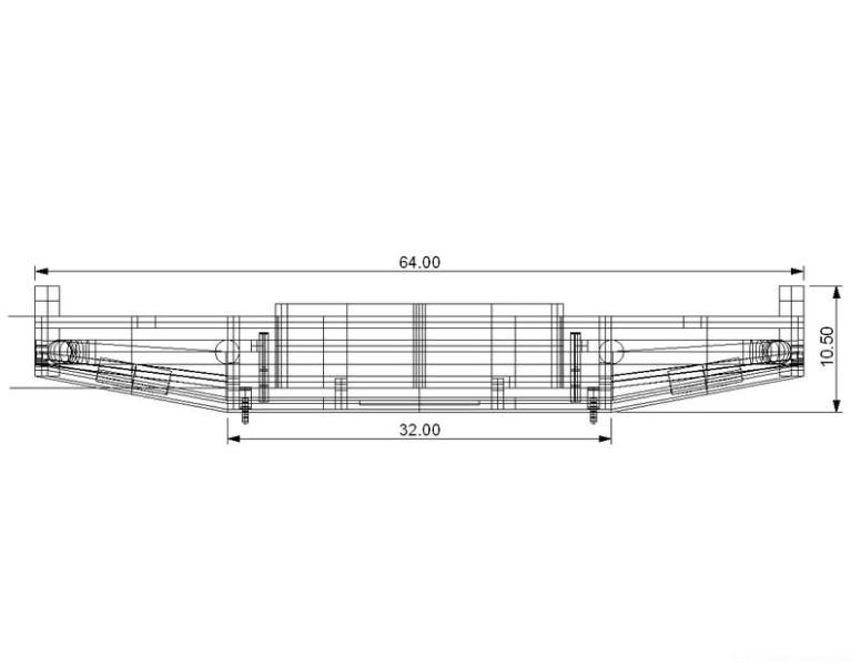

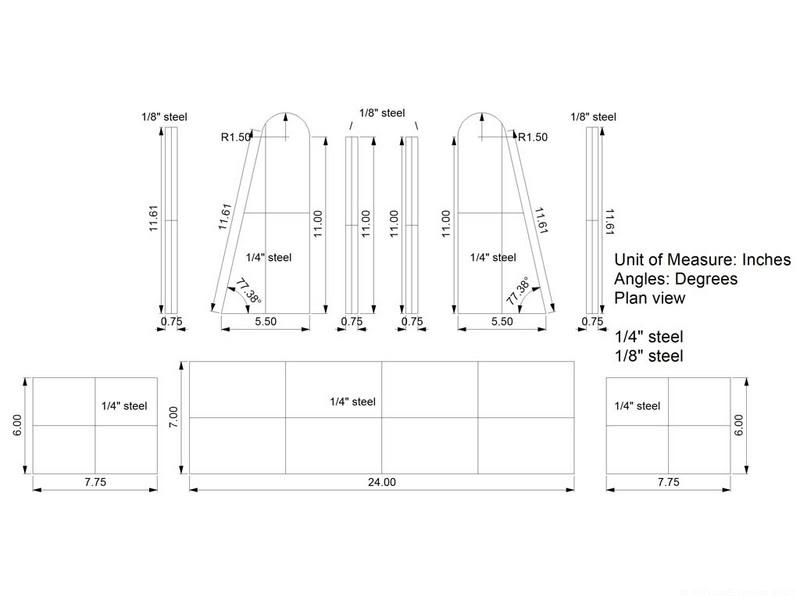

so you are PTO, i could try find my plans i made for my winch mount, for an electric mount on a safari.
bit of a hack and slash, but gets it way out the way
tgaguy1
Posts: 746
Location: Tauranga
Re: ARB winch bar
Post by tgaguy1 »
Try these.
