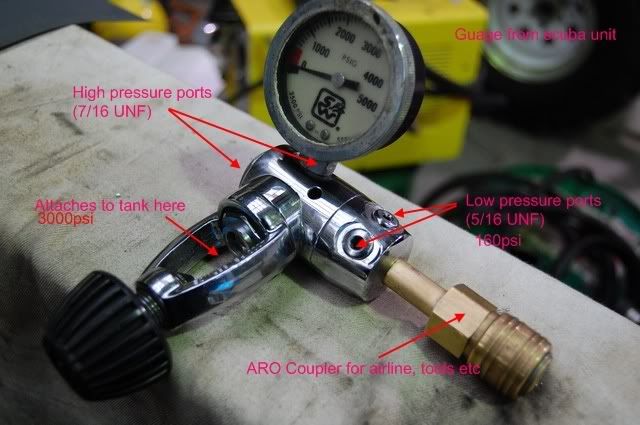

Would be good if you could post a pic of your setup.

Tu's here is my setup, although a slightly leaky one
I got the dive shop to check the low pressure side and it was already set to 160psi
You will need to turn an adapter to get your airline coupler to fit, if that's how your gonna run it. The thread for the low pressure side is 5/16 UNF and it has a groove for an o-ring to seal it. Get Howie to turn something up for ya if ya need to, its easy as, bout half an hours work. The guage is the one that came with the reg, just got rid of the flexi hose

Hi, I've got one of these setup basically the same as Jafa but the airline fitting is on the end of the flexible pipe - that way you just get the fitting you want crimped onto the end (mines an aro but I've been about to swap for a nitto for months). Mine's setup for airing up tires, as a stopgap until I get the aircon compressor mounted, but the todo list keeps growing. Anyway, to the point - I'm not going offroad for a few weeks by the looks of things, so if you want to borrow it for testing purposes you can have it for a few weeks. i might be able to bring it to club night, or if you don't need the bottle I can bring the reg into work at Wgtn and maybe get someone to arrange a meet. cheers,
Terry
Terry
