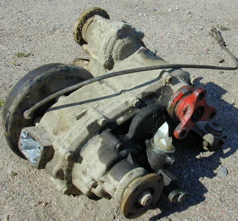

This is probably the only PTO winch you will find for a Suzuki (without putting a Landcruiser gearbox / transfer combo into it)...
Doesn't matter if the engine isn't running, the battery is flat or you need to winch somewhere other than forward.

If you can find one of these you'll be half way there....

2MEKE wrote:If you can find one of these you'll be half way there....
Where did you manage to find that ive seen them in the sj410 parts catalogues but never seen the real thing, what kind of zuk did you get it off ? 410 flat deck/
Re: pto winch into samurai
That pic is off the net somewhere. I've seen it before too.

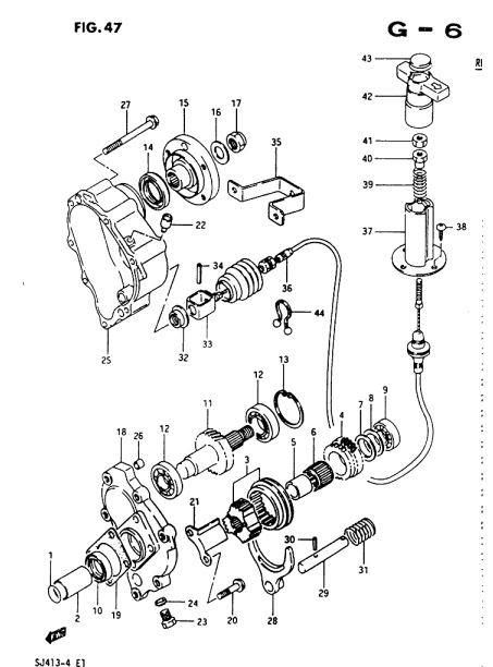

Here's the page from the parts manual for the PTO:
I talked to Shane, the owner of Te-Puke partsworld about them once. He said he's only ever seen one. That was before he bought the business and the previous owner was showing him round. Apparently there was one there, but when he bought the place it was gone.

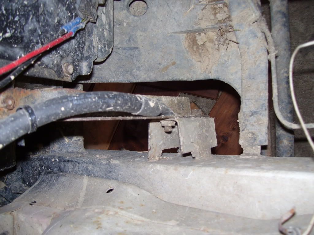

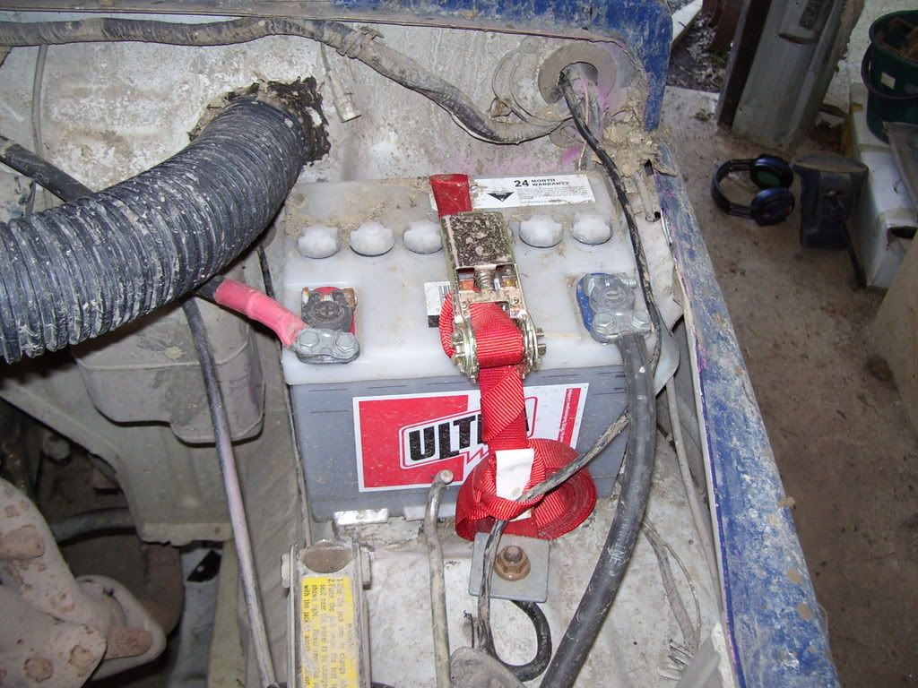

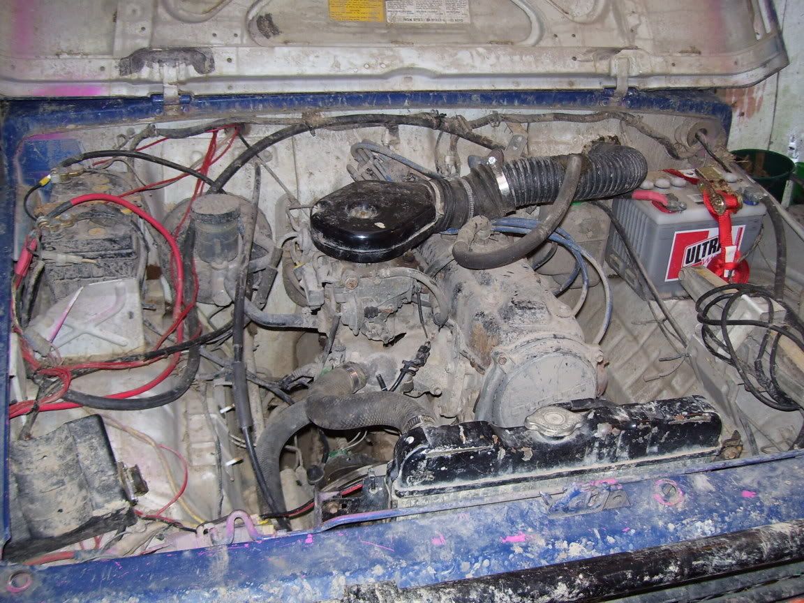

one of my batterys are earthed to the chassi and the other is on the radiator bracket i grinded away the paint before bolting together so they should be fine il try take a pic of my setup tomorrow, the alternator i have on my truck was quite noisy i was told it was the bearings so will replace alternator tomorrow.

new2zukes wrote:one of my batterys are earthed to the chassi and the other is on the radiator bracket i grinded away the paint before bolting together so they should be fine il try take a pic of my setup tomorrow, the alternator i have on my truck was quite noisy i was told it was the bearings so will replace alternator tomorrow.
Is that radiator bracket welded on or bolted to the chassis? If it is bolted you may have your earth problem there, shift it to the chassis somewhere. if it is welded to the chassis then maybe the cable is too coarse / small for the ergies (technical term - yeah right) you are trying to pull through it (or over it to be correct). Power transmission is about surface area (the electrons travel along the surface of the wire not through it) not diametre when talking about cables so lots of little strands is better than a few big strands.

Do you have an earth cable from the battery straight to the winch motor? If not thats the first thing I'd look at.
Ben

Earth to the body, Earth to the Chasis Earth to the Motor all this from the battery that is already earthed to the chasis (this can be done with one cable) and Earth directley from the winch motor to the chasis

Regarding upgrading the alternator -- this wont fix your problem. Even a 100A alternator will not be able to keep up with your winch when in use - not even close. Your winch should run fine on two batts. I have been using my Warn M8000 on just one 550cca battery (i.e. pretty small) until recently (now have two of the same). Went fine, a little slow under load but did the trick.
I'd say either your batteries are on their last legs, or your wiring is too small. You need some BIG cables going to your solenoid box. Check if any of your cables get hot after running the winch under load. If they do, they are too small.

one of my batterys is 330 cca and the other one is 450 cca the following pics show my setup. both batterys are no more than 3 months old so that shouldnt be a problem the wire im using to conect the batterys is very large but has lots of small strands. i agree the leads going to the winch are a little small and i will earth my winch direct to the chassi. if i do this does the earth still need to run threw the solonoids?
