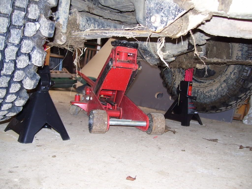

1) jack the truck up and place axle stands under the truck.

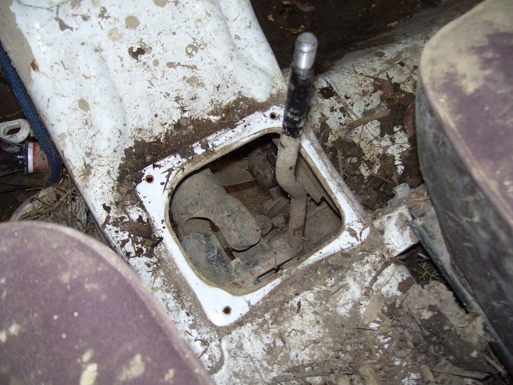

2)remove 4wd leaver thingy (didnt no what to call it but its in the pic

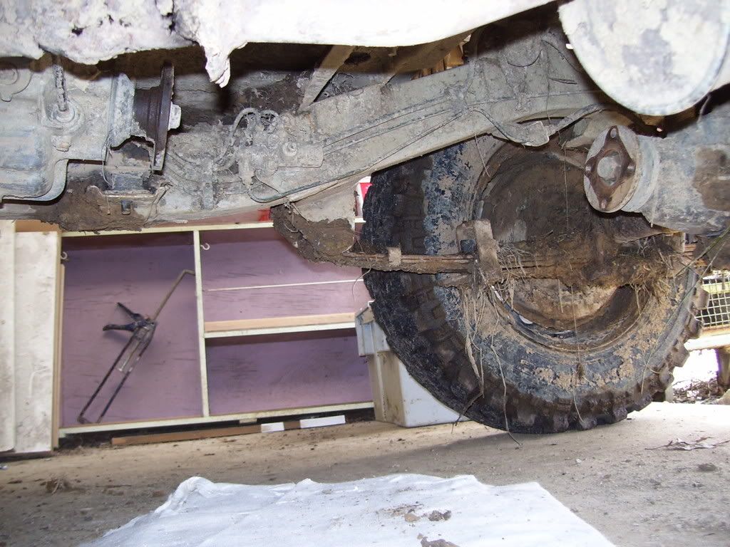

4)remove rear driveshaft bolts and remove driveshaft, you will need this when you redrill flange holes.you might need to get agressive when you take it off as i had to hit it hard with a hammer and a screwdriver to break it free.
5)then remove front driveshaft and gearbox driveshaft its the same as taking the rear driveshaft off.

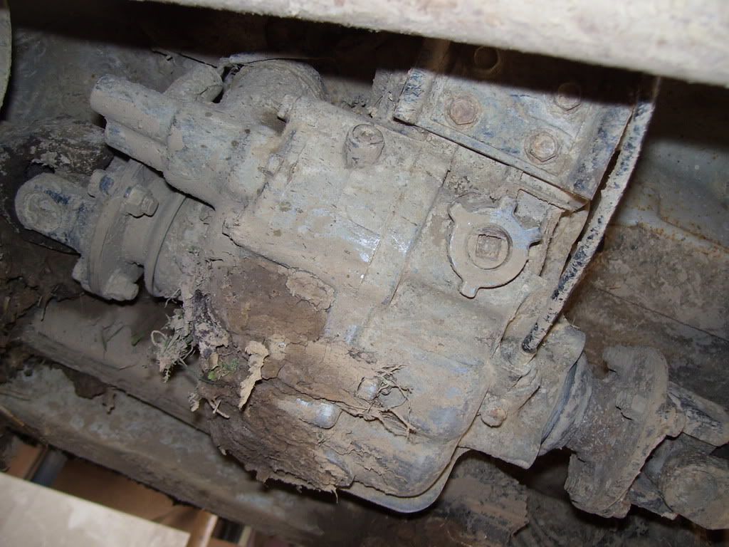

7)remove mounting brackets make sure you leave the long edge of the mounting bracket attached to the t case its the one on the right hand side when facing frontwards.

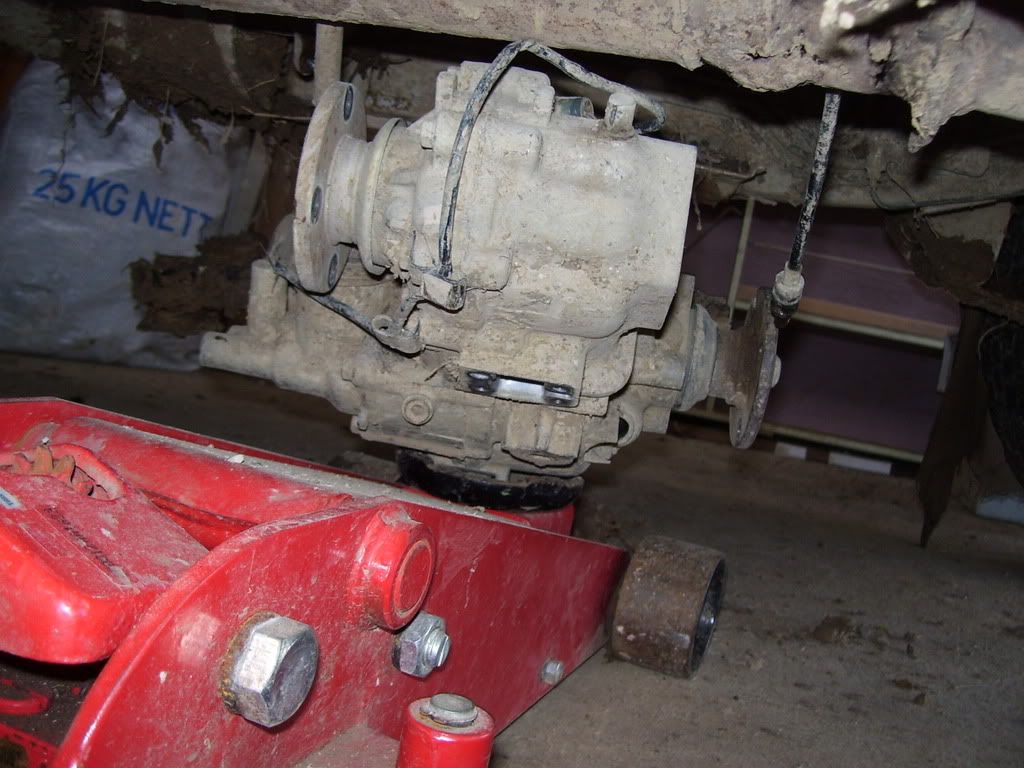

8) use your trolly jack to lower the t case to the ground as it is reasonably heavy.

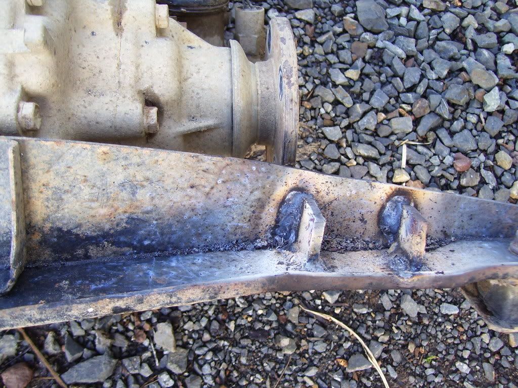

9)weld little bits of steel in the mounting bracket as it will bend after some time and will make it very hard if imposible to get in and out of 4wd.

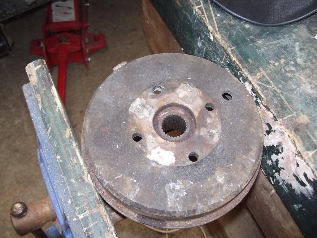

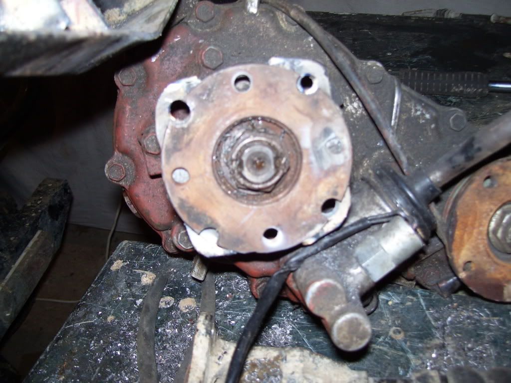

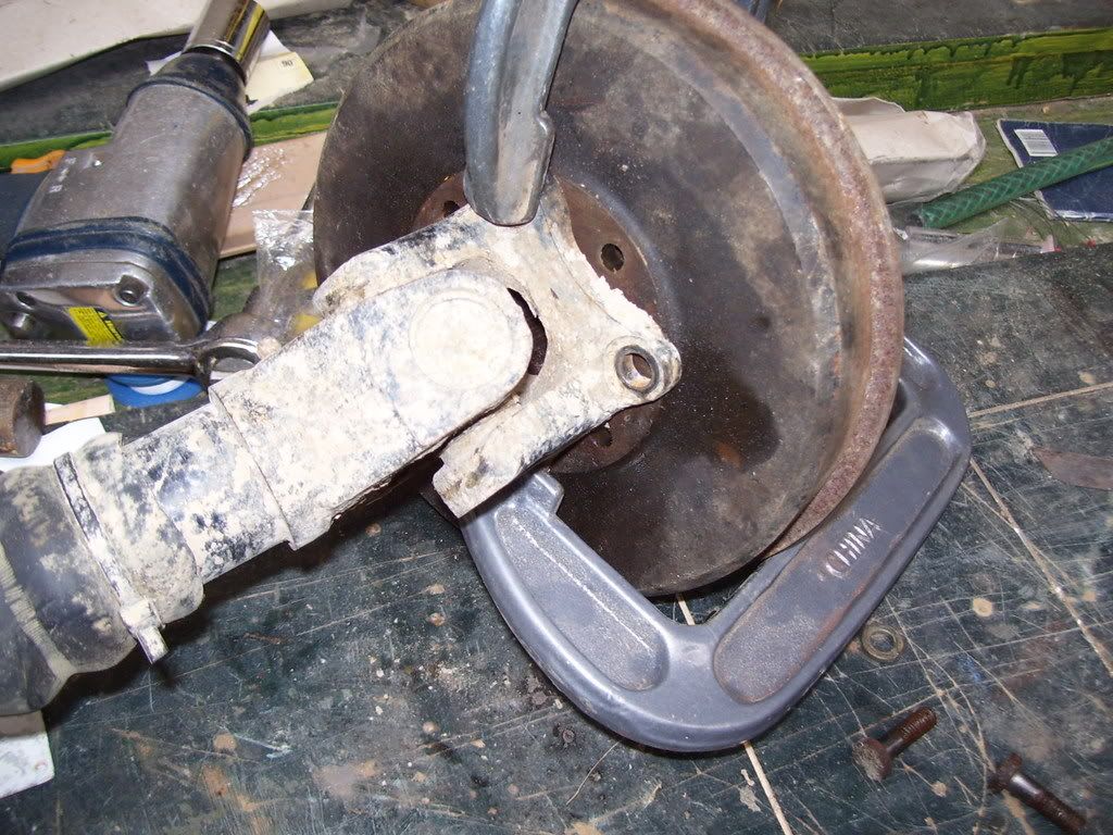

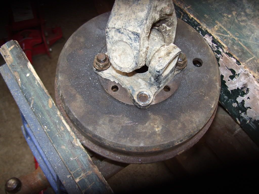

10)take drum off your 410 t case and redrill wholes for samurai flages use clamps to hold in place then weld other holes up.
11)i bought a 410 gearbox to t case diveshaft so i didnt have to alter as many flanges, but the front drive shaft i had to redrill the holes,BUT you run out of meat on the flange so i welded a bit of 6mm pl8 on the other side of the hole. might make it a little out of ballance but i think it will be ok and someone please correct me if its rong:).

Instead of Drilling out the transfer flanges to fit the Samurai drive shaft flanges, you could have just changed Samurai ones for 410 flanges (Square shaped).
Then it would have been a straight bolt on procedure.

That 410 transfer case was the one I had fitted into your LWB UBZ :wink:, It bolted straight onto the 413 driveshaft, but the wide track samurai had bigger flanges which would not bolt up to it.
ie in my experience:
'84 410 and 413 are same size flanges
91 WT Samurai and 413 are different size flanges (I don't know about the UJ's).... (and also used different size bolts)
Possible the narrow track samurai/sj413's are the same size?
Someone once told me the flanges from a coily samurai t-case fitted onto a 410 rockhopper case... So may have been possible to swap the samurai t-case flanges onto the 410 case, but i think that is a bit more work and renders the Samurai case un-useable to sell or as a spare without swapping them all back...
These spacers fit 413 and samurai (hence the 2 patterns drilled into them)
But oh well :) as long as the metal you welded on is even on all sides and the holes are centered it shouldn't be a problem (except at high speed) if its not all centered you'll wear out the t-case mounting bushes and will have some vibration...
