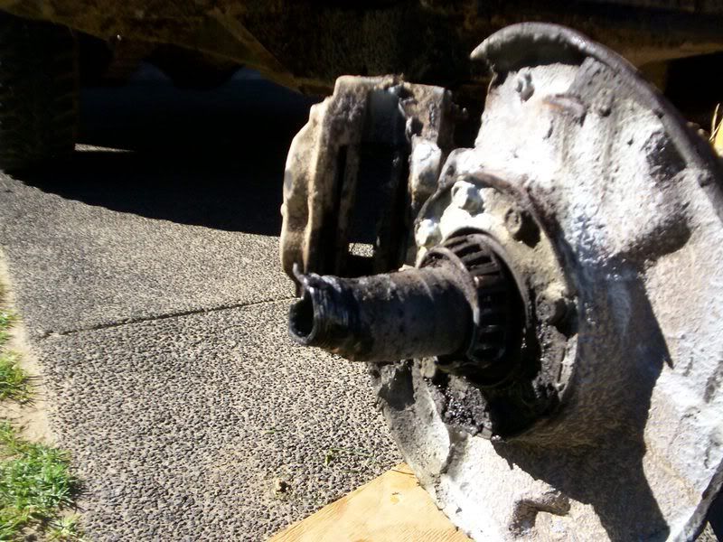

tomorrow reassemble a 40 front axle another $400 for new brake calipar :(

this front axle

well on luck on the 40 as it a nightmare of bad engineering

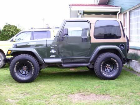

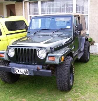

2nd attempt at this..... damn fandangled technology!
Took the 33's off the stock rims on the brides TJ and popped em on the new, matt black mangels.... and i rekon they look farking mean with only a 2 inch lift. Sure the flares are going to cop a flogging when the suspension is flexed, but what the hey!
Then, cranked up the front of mine and took out the stoooopid spacer that had the front up at a 5 inch lift and the rear at 4. Re-aligned the front and rear track bars, and then got the draglink centred also. Drives a damn sight better on the road now, no crabbing to the left and a heap lesss "float".
What to do on the brides one next.....??????? Body lift, winch, discos.... hmmmmmmmm

Post by TJ »
xj wrote:What to do on the brides one next.....??????? Body lift, winch, discos.... hmmmmmmmm
I thought you were selling that one! What happened? BTW, like the look of the rims. Where did you source them from?
I was, but no-one was prepared to part with the reasonable amount i was after, and i want prepared to give it away.... so the new project begins.....
Rims are courtesy of another Jeeper that had them sitting in his shed, they were a bit banged up so some primer and some engine enamel and they came up good, i dont suspect theyll stay looking like that for long though. Looking at trying a different angle on flare extensions next week. Ill trial it on my one first, and if it comes up ok ill do it to the bosses one too. rather than buying the 7inch replacement flares, im going to cut the vertical plane off, and attach a strip of conveyor material to the remaining horizontal plane. Although Ill lose the side indicator.

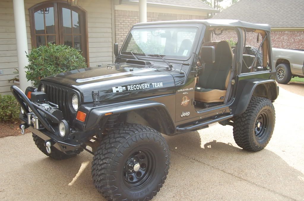

Post by TJ »
xj wrote:Looking at trying a different angle on flare extensions next week. Ill trial it on my one first, and if it comes up ok ill do it to the bosses one too. rather than buying the 7inch replacement flares, im going to cut the vertical plane off, and attach a strip of conveyor material to the remaining horizontal plane. Although Ill lose the side indicator.
How about something like this for side indicators and flares?

Post by xj »
They look like modified stock ones. Still wouldnt help my width issues. I think i might just bite the bullet and get the wifes wagon the real mcCoy and butcher my ones.... otherwise i can just see a right clusterf**k happening.
