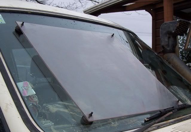

While we are still off topic ... Its all about learning ...
I love this Idea copied from "bulletproofs" hilux specs about half way down ...
Bulletproof wrote:A permanant accessory of the hilux is a 500x500x4.5mm piece of polycarbonate for extra safety when extreme winching.
I have put 4 suction rubbers on each corner to stick to the windscreen and the advantage is you can see what is happening to the winch wire.
Polycarbonate is used in aircraft windscreens and is virtually unbreakable.
All I'm trying to do is spread the impact and slow the missile down with something virtually unbreakable, and it has to be better than nothing at all.
When polycarbonate roofing came out,placemakers left a sheet on the drive thru floor and let all the trucks drive over it and it still didn't break so is pretty tough.
A person still needs something over the rope to kill it as well.
Richard
Cheers Bulletproof
Prevents this ...
Sadam_Husain wrote:its scary shit when those cables come at you :shock: :shock:
Even if the force collapses the whole windscreen into the truck I guess its better to have a bit of poly wraped around you than the sharp end of the cable :oops: :oops: :oops:
