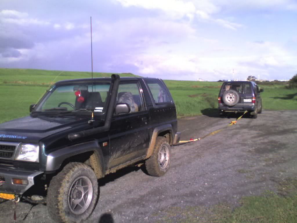

i have these Zook rims on my Daihatsu and the only differance i can see is the zook rims have slightly more offset (this gives me about 50mm wider track. (25mm each side)
have also put the original Daihatsu steel rims on my wifes old vitara to move it around the workshop however the daihatsu rims are fuggly :) btw I believe Jeep, F100 and Lada's all have the same stud pattern.
