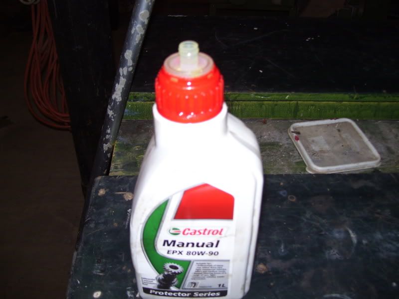

hi i replaced the diff oils in my zuke today if you are just checking levels then open the top bung hole thing put ur finger in hole and push finger down if there is oil on you finger when u pull it out it is up to the right level if there isnt top it up. i just bought a 1l container with a little hose comeing out the top it was reasonably easy just u can only use half the bottle then have to top up bottle again to fill up some more see in the pic of the bottle below. you need 80w-90 gear oil for the open diff and a special lsd oil for the rear. i just used the one in the pic seems to be fine. think thats everything oh and make sure ur on a flat level serface or the levels will not be true.
