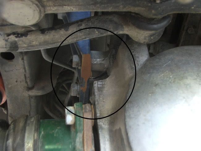

i will post pics tomorrow for the reason we want that diff!!! bugger :lol:
might have a good way of strenghtening the alloy ones too. wait until de-ranged has done his magic, then try to break it again i suppose :?

nah, i broke the front drivers side mounts of the casting, twice :evil:
that other mod i think is the wrap-around one on the pinion housing??? getting something similar made for mine. they just dont hold up very well ay???? got 3 housings and 2 diffs now for spares, oh and a spare complete rear axle and diff just incase :lol:

I got a alloy plate welded across the top of mine after breaking mount on drivers side seems to work so far will try to put photos up tomorrow .

Here ya go, stage one diff brace oh and a wee bit of armor just cose we could :lol:
http://www.offroadexpress.co.nz/Forums/viewtopic.php?f=23&t=14042&p=172624#p172624

if you are going to thrash shit out of your scudo you are wasting your time with the std front diff, over the last 3 years i have broken 7 front diffs, broken spider gears , smashed housings , torn the whole pinion housing off the diff head, torn the rh side bearing housing off , ripped the teeth off the c+p, i have braced and plated the diff head, made a brace that held the diff against the cross member , nothing lasted, i welded the rear diff which helped by being able to go a bit easier on it , and then broke it again at a round of our club champs, i had run out of good spares by then so built a locked front diff and that is still going at this stage, it is no good when there is heaps of grip but is great in winter when wet and slippery, i drive it in lo 4wd but with the hubs unlocked and lock them when needed, in that time i have only broken 1 cv and blown 1 auto hub before i changed them to manual ones, i was going to sas it but then they dont have the gearing or grunt to run bigger rubber so it lives under a tarp now and i use my v6 paj and the scudo comes out when some one needs it or my 15 yr old nephew drives it, i ended up with a vege crate of broken bits that the scrap metal dude gave me enough to but a bottle of jack daniels with, plus now i can change a scudo front diff with my eyes closed in about 30 mins :D ,
