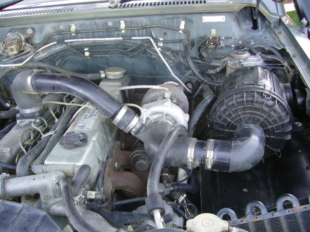

Heres some pics of the J pipe set up on my GQ
Turbo is a HT-18
viewtopic.php?f=18&t=6316&st=0&sk=t&sd=a&hilit=hair+dryer&start=30

Current set up,changed to different air filter set up.
Shane
doby
Posts: 129
Joined: Sun Jul 01, 2007 12:00 pm
Location: auckland
Re: td42 turbo manifolds
Post by doby »
Where are you geting your oil feed for the turbo from?
GQTROL
Posts: 513
Joined: Tue Aug 10, 2004 12:00 pm
Post by GQTROL »
Looks like from under the oil pressure sender.
