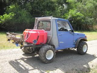

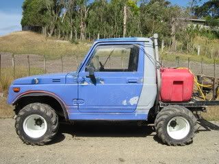

Don't laugh at my little "Barbie" truck.
It does its job well but I just have to get around to finishing it next Winter. The spray tank slides of and a flatdeck slides on in its place.

Thats awesome!!!
Can those tires be used on the road?

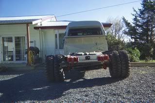

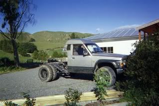

flyingbrick wrote:Thats awesome!!!
No !
They are only cheappies but you can get speed rated tractor tyres which are legal for the road. My mate has 6 ( rear duals ) of them on his spray truck which he finds works better for his needs than Simex's 90% of the time, mind you he is over 4 tonne's when loaded up. Compared to the Simex he finds they hang onto a hillside better, drive better on the road and don't wear nearly as fast. They are about 33x13.5's ?? and it looks really impressive comming down the road because it is over 8 feet wide.
He runs the worn sets of tractor tyres on his SWB GQ in the Winter and they are real fun to play on.
These pics were taken when he was building it. It was professionally modified and the custom built spray tank tucks under the cab extension.
Must get some more because it is a really nice and impressive looking rig.
