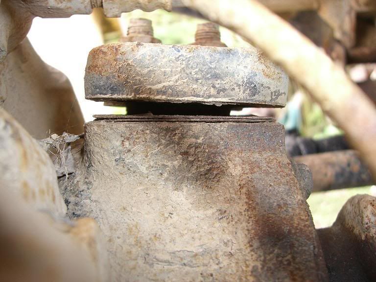

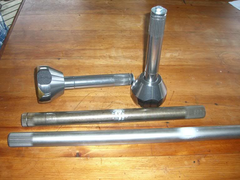

Had problems with my top kingpin studs coming loose since I pushed my rim offset out about 75mm per side, managed to catch the passenger side before the steering arm fell off but had a broken stud to get out. The farking ezi-out broke in the stud of course and then after getting the broken bit out of course I ended up drilling right through the stud with a bigger drill bit filling the swivel housing with metal filings so after getting the broken stud out I thought I may as well pull the whole swivel housing down and clean all the nasty bits out and stick in one of the longfields thats been sitting in the shed for past 9 months. So the kingpin and studs are all sorted, passenger side longfields in and the swivel housings cleaned and re-greased so I might stick the other long in next year
