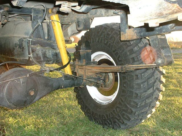

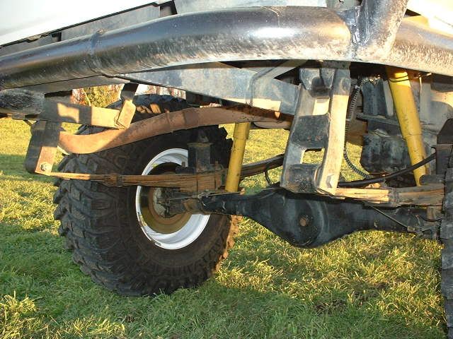

photos as promised

the photos are of my lux and have never had a problem and im not exactly nice to it :twisted:

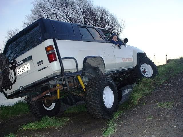

Mine were in a similar spot on the old rig, axle rotation wasn't a problem at all, pins were welded to the front of the axle housing, and the backaide of the chassis crossmember, C section is really good for that task
flex was pretty good as well.
I've aged a little since that last pic was taken :)
