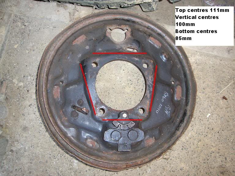

by Sadam_Husain
Jafa wrote:Ahh I see, well there ya go. Mickey, measure the pcd of the bolts that hold it on
This is the bolt spacings on my full floating cruiser diff, is that what your brackets are setup for jafa?
Re: Toyota MR2 Caliper Coversion kit
Posted: Fri Apr 03, 2009 5:55 pm
by haynzy
nope they wont fit that but im sure he could make them work :wink:
Posted: Fri Apr 03, 2009 5:58 pm
by Sadam_Husain
haynzy wrote:nope they wont fit that but im sure he could make them work :wink:
That clears up some cruiser confusion, cheers Haynzy :mrgreen:
