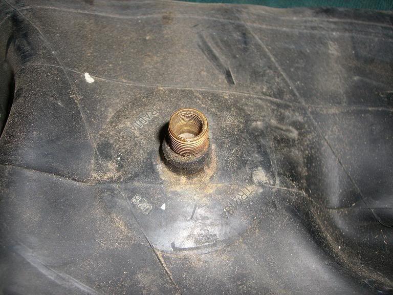

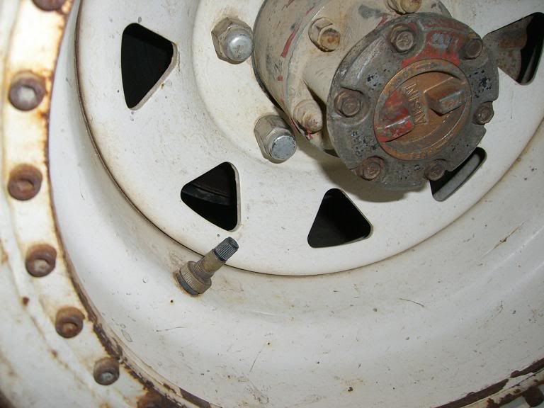

ohh and for tractor tubes you need to drill out the valve stem hole as the heavy duty bladders have much bigger stems :wink: but take normal schroder valves so no drama :mrgreen:

Re: running tyres at low pressure without beadlocks
and if ya decide to run with the tractor valved tubes, its a better idea to drill a completely new hole closer to the centre of the rim and weld up the existing hole as it suits the tube better and causes less stress on the valve area

skid wrote:and if ya decide to run with the tractor valved tubes, its a better idea to drill a completely new hole closer to the centre of the rim and weld up the existing hole as it suits the tube better and causes less stress on the valve area
true that, i diddnt but yes it would suit the tractor tubes better... will do that when/if i ever take the tyres off :wink:
xorph wrote:why are the tractor tubes so much better?
Tractor tubes are heavy duty rubber not that condom thin stuff they make standard tubes out of. They have 16mm reinforced valve stems with locknuts and dump valves instead of the standard 12mm valve stems. You redrill the valve hole further into the centre of the rim so its not sticking out where it'll get caught on roots and stuff that'll rip it out :mrgreen: :mrgreen:
