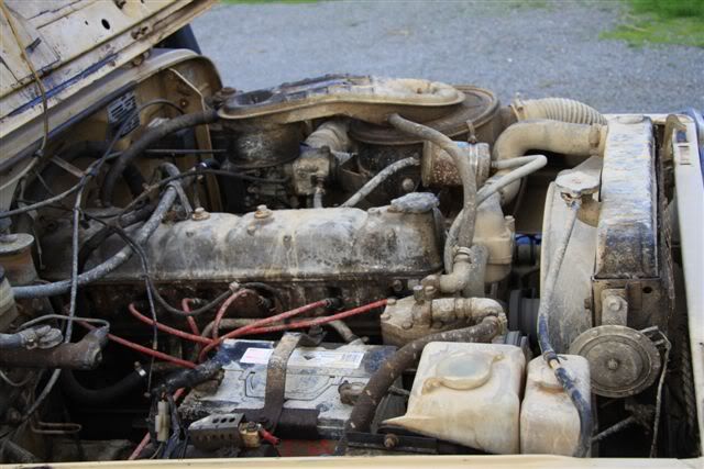

James here, The 40 I got off Curly has had that done.
This is the only picture of the engine bay I have unfortantly, But the aircon pump can be seen behind the battery and Washer bottle.
I'll try and get a better picture tomorrow If no one else get's here before then.

HI, Im the mate with the 40 trying to do the aircon thing.
would be good to see how its hooked up and mounted. Thanks for your help

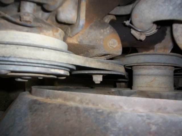

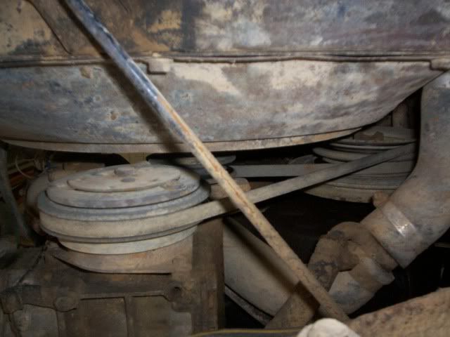

Re: Using air con for compressor in fj40
The 3f motors came out with twin belt pullys
TWO VIEWS FROM THE TOP OF THE ENGINE
thanks heaps for that...making a bit of sense now!
