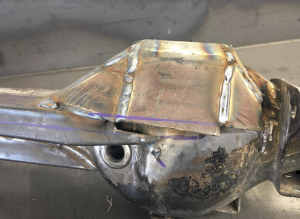

i thought id show you what ive been doing when i get bored haha this is a spare rear housing for my dads GQ nissan that we are going to put under it when it comes back home which should hopefully be in a few days :D
heres what it started as
these show kinda what it looked like
my good friend the hole saw to move the drain hole so i didnt cut it up
housing all cut up, no going back
just a test fit
bent up and welded together then painted
so all i have to do now is move the shocks up to stop them getting caught
(not that it ever has cause its got 37s and soon to be 40s or 42s :twisted:)
so it gained about 17mm at the back and 14mm and the front which is nearly equivelent to having tyres a inch bigger.

Now this is an interesting concept to gain more clearance under ya diff. IOf you are ever bored down chch way I have two diffs you could shave for me. Looks like a big job though.

it wasnt that big, it was like 5mins to strip, 10mins to cut, another 10mins to tidy up, 10mins to cut and bend the plate, 10mins to make it fit perfectly, 5mins to weld then paint. so it would have taken around about an hour maybe a litle bit more

will you still get the same amount of fluid in there or will the filler hole need to be moved higher?

its only lost about 15mm of depth so that wont be a problem

if its a road truck be aware you do warp the housing doing this... I've done a few and the worst one moved 10-12mm off line
There are ways to limit the warpage like doing short stitch welds and letting the housing cool between welds
I've now got a jig to measure and true them

how much oil is going to be left in the housing with the drain bung that far up the housing compared to before...looks like a fair bit?

If your concerned about that just swop one of the bottom studs for a bolt and use that as a drain... its whats normally used as the drain when you do this, when I do it I drill out and tap it for a larger bolt :wink:

thats exactly what ive done :D
