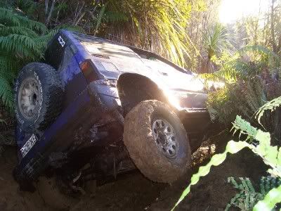

I'd also like to help Tom (Escudogirl) out by machining him up a set of body lift spacers.
can anyone here give me some measurements/link to a DIY or something showing measurements?
He's a bit low atm... as shown by this pic.
Thats a rock under his sill.
Just off the side of the picture is 3 out of 4 people laughing their asses off.
Tom was the one not laughing

hahahahahahahaha i was waiting for this photo to end up on here, and its ESCUDO BOY!!!
