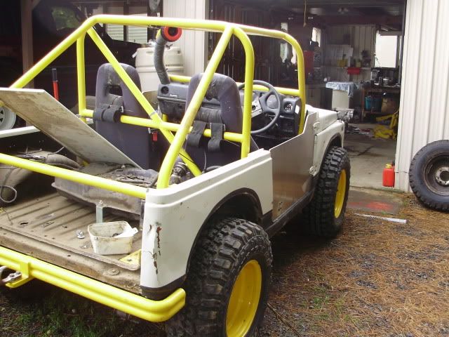

First off, i thought about The 50, i have all the bit's to make it quite a bit better than it currently is, stronger axles, several engines to use for a rebuild, tripple carbs and expansion chambers etc etc. One day i might get off my arse and do it :lol: :lol:

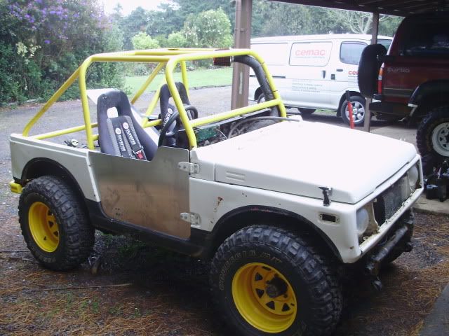

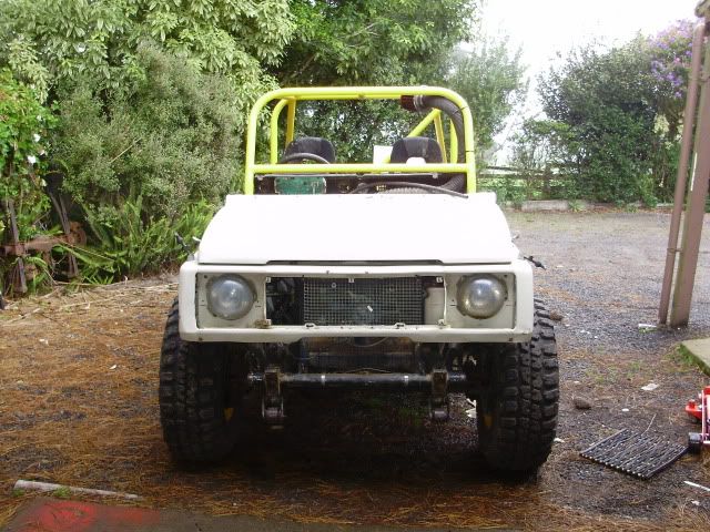

Some how or other i ended up with this:
Its done a couple of seaons running A Class, so was getting a bit scruffy, and in need of some minor mechanical TLC.

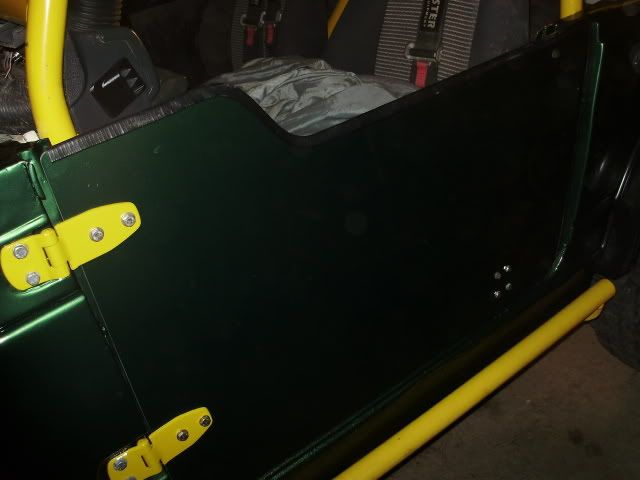

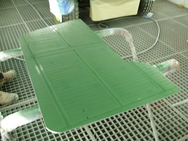

Thought i would get the panel work done first:
Made some doors too. 4mm alloy.
Image[/quote]
Apparently it had some cooling issues, wonder if this could be something to do with it??
So the plan??

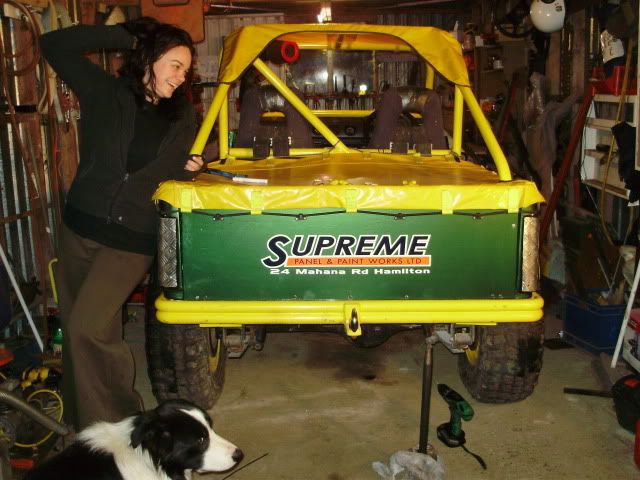

Well, i want to see if I can keep it Nat Trials A Class legal, Winch Challenge Clubclass legal, and bush tough.
Basically, that means having a windscreen, doors, roof, cargo barrier, lockers and winch that are removeable or able to be disabled .
I picked up a convertable windscreen frame and windscreen, so thats sorted. Easy to remove for Nat's. Doors and roof and cargo barrier can stay on.
I'm day dreaming about attaching my Warn 8274 to the front of it, but it's a whole lot of winch to try and hang off the front of a zook and keep the approach angle good, and doesn't do much for the weight distribution. Its about 50kg, so looking to maybe mid mount it, but don't like the dramas it ceates when something goes wrong with the rope.
Might have to run airlockers, that way i can disable them easily to run A Class. Very tempted to give the Chinese 1's a go, because i haven't heard any first hand stories about them yet, and somebody's gotta give em a go eh???

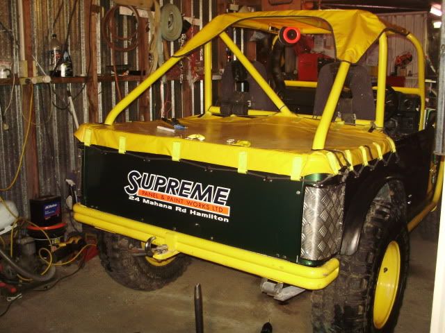

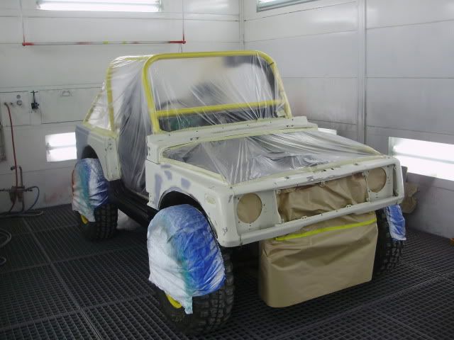

We had a look on the computer in the paint bay, Ginga wasn't listed, but Copper was :lol: :lol: :lol: :lol:
Its a Nissan colour called yellow green, and its got a fair bit of pearl in it, so looks quite special in the sun light.
It looks a bit funny at the moment, but once the rest of its back together, i reckon the colours will work together better.

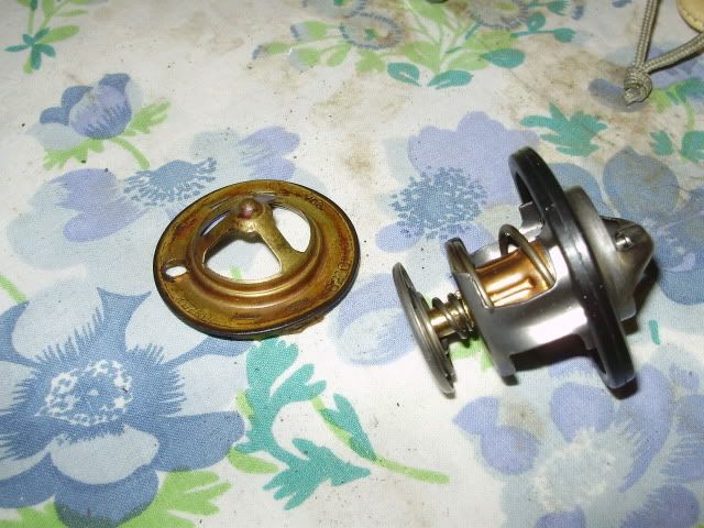

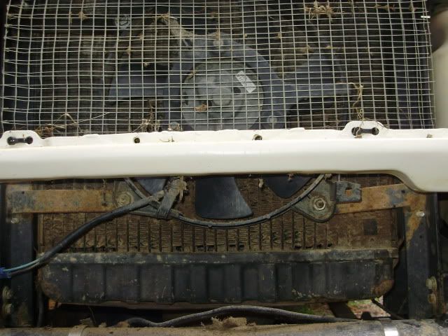

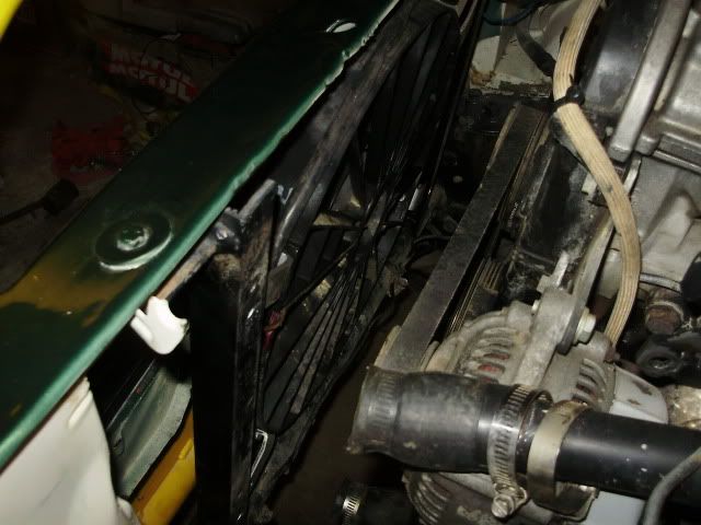

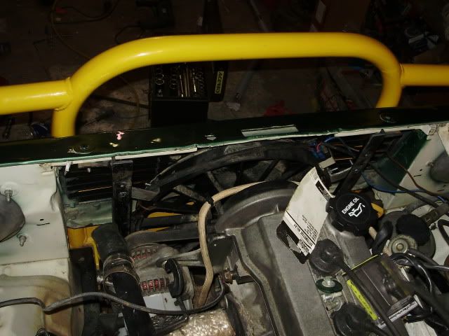

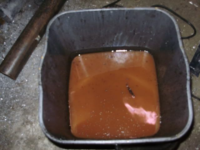

The main thing on the go at the moment is trying to improve the cooling system. It was barely adequate for the short run's it got during a trials event, let alone grinding up a hill in the summer with a radiator half full of mud :lol:
So naturally, i dropped the coolent and wipped the radiator out, which is currently away getting a heavy duty monster core fitted, complete with thermo switch. Looked at aftermarket alloy, but they are crap i decided.
Nasty looking coolent:
A good flush of the block is in order :mrgreen:
I also noted it apeared it might not have a thermostat in it, so went investigating. Old on the left:

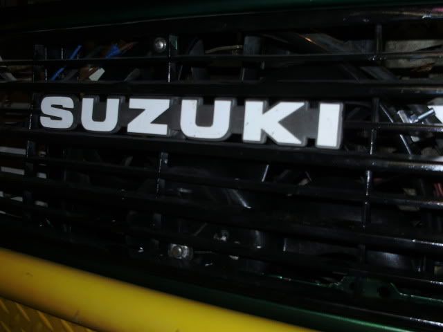

I got to far ahead of the camera, so will grab a better photo of the new godzilla monster 12" BMW fan i squeezed into the tiny space behind the grill next time its apart, which will no doubt be when the rad's back knowing my luck :lol: I'm hoping the rad will bolt straight back in, but with the monster core, it probably won't :roll: :roll:

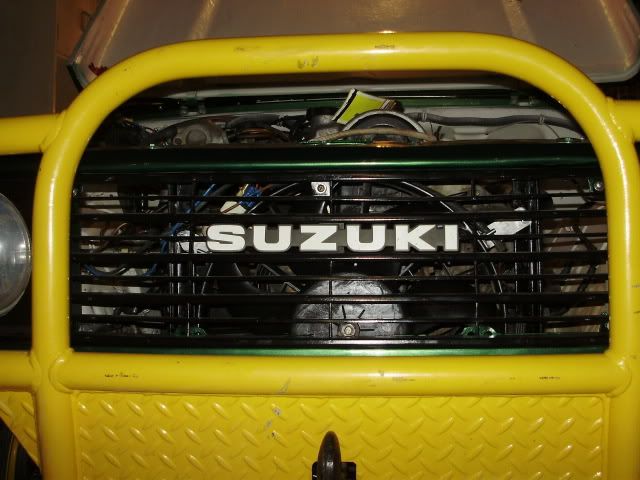

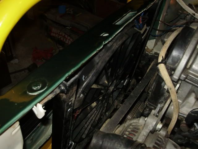

Couple of fan pic's, you get the idea:
Its reeeealy tight in there, i jacked the front panel out about 30mm, and did some minor panel surgery, and massaged the back of the grill slightly, but it's in, and it doesn't rub, and move's some serious air!!!!!
Also while the front end was out, i noticed it made access to oilpresure sender easy, so i took the opportunity to slap a mechanical oil pressure gauge in. ( i prefer mechanical gauges :wink: ) Also a volt gauge in there to. Its cool how a 2" gauge fits into the suzuki airvents :lol: :lol:
I had also be playing with the idea of adding some padding to the rear corner's, as they were full of bog when i got it, and now they are only slightly better :lol:
Don't ask me why, i hadn't intended to, but for some reason at 10:30pm last night i found myself hacking up a piece of 3mm chequer plate in the freezing cold, and buy about 12:00 i had myself a couple of rear corner strengthening thingy's. Random how you just get all carried away and before you know it you've done a job on the "maybe one day soon" list when you had a shit load of far more important work that needed doing :lol: I was only sposed to be going out to the shed to turn the lights off :wink: :wink:
Finished them off tonight:
Chucked some edging round the doors too. Man the router left some sharp edges!!!!
Got these to slap under there at some stage this week aswell :twisted: :twisted:
Jafa
