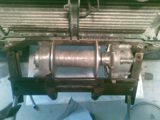

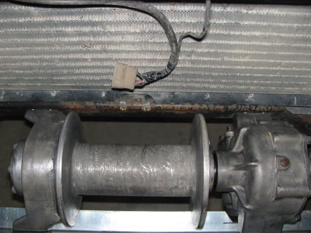

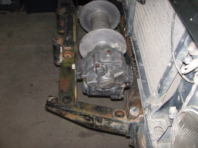

This is what I have so far,rear most winch bracket is now sitting on top of chassis rail.I was going to reverse(make new one) the L shape plate the fair lead is on so it points under the winch instead of foward,by doing this I can cut just over 4" inchs off the front guides.
Elect winch set up vvv

Cut the bottom section of the radiator support panel out and replace with a section of angle in behind it. Then can push the winch back so the drum just clears the section of angle.
As you've already noted, you can lift it 20mm before the knuckle of the input hits the underside of the rad support.
Keep driveshaft angle as flat as possible.

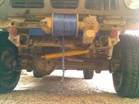

I'd second that question - just replaced my clutch and had a prick of a job getting driveshafts back in because couldn't separate that slip joint (just in front of the bearing that hangs off the engine mount bracket) - it has a circlip, so presumably should come out? Couldn't budge mine. My winch moved back about 4", up about 3" (40mm body lift). Did the angle iron thing too, the front mount is part of bullbar, which mounts to arms slid into chassis rails with original huge bolts plus a couple of extra. Watch out for the rad support tube when moving driveshafts - if you get it wrong (I did) the front universal fouls it - had to trim the support tube (naughty!). Also make bloody sure you can change the shear pin easily - my first hole was good in teh garage but too small in the mud. I used 1/4 of a 250mm x 8mm steel culvert as a runner under the winch to ease those "bang on over" vulnerabilities. I also saved a couple inches parking room (LWB) moving to synthetic rope and losing the fairlead. Made my own fairlead by welding loop of steel rod into cutout (cheap as! - but tidy it up well). I tend to get told I should fit a winch, as it's all hidden (removable magnetic panels).

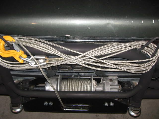

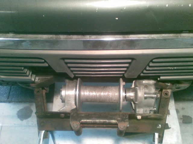

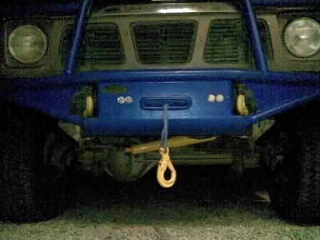

Hi, must admit I farmed that out - first install was a cut and shunt done by Carl at Wgtn 4WD specialists ltd. Nice job and did the big move for me, rearranged the mounts and the front chassis arms (cut the original brakets down and mounted the front via a slip-in to the chassis rails). I revisited it 2 years later, converted to plastic rope and removed all the front mounts, integrated with new bullbar. Also removed the "forward facing" angle iron, replaced with the smooth front 1/4 pipe section - didn't improve the approach angle so much as change a bulldozer blade into a roller-tip. Much easier to bump over stuff now, and doesn't (always) pick up 100kg of spare dirt. Pretty sure the cut was between the front universal and the collar with the shear pin, but can't remember (it was a long time ago). This is a quick cell-phone pic:
Image if that helps. cheers,

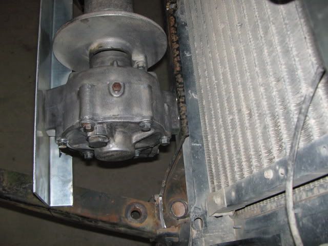

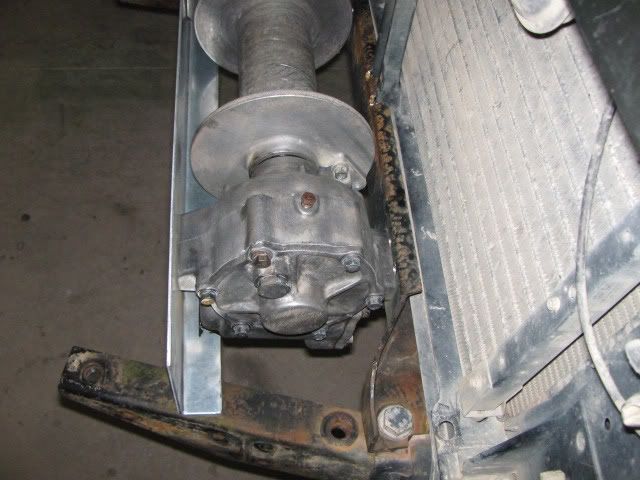

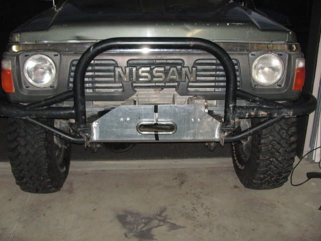

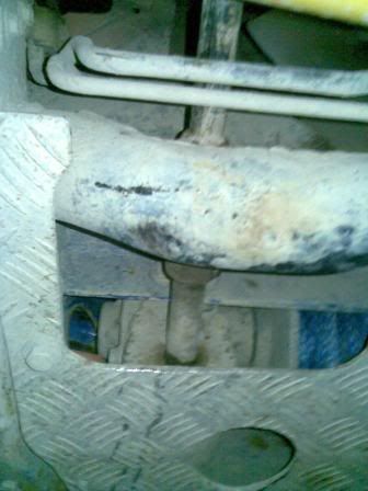

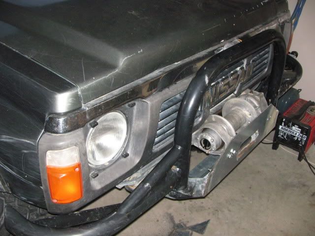

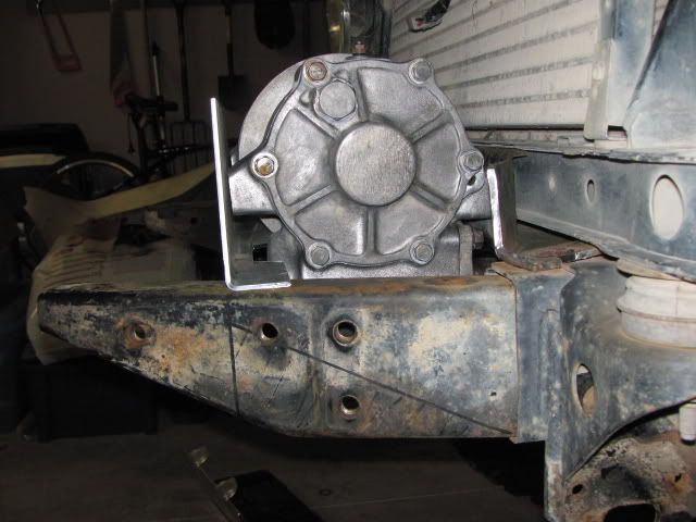

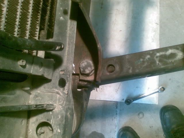

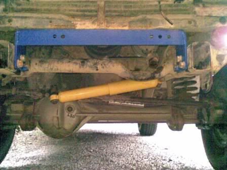

O.k I have had a plate made up for front,which you can see in 2nd pic.
have removed the 2 spacers I had under rear most plate(under rad)and been able slip it under the first lip on the radiator surport panel which gives another 20mm back with out having to cut anything(pics 3,4,5)
Just need to redrill hole and strenghten plate a little,cut front/under side of rail guides,make up panel for front/fair lead then just need to sort drive shaft lenght out.

with std fairlead set up
with new plate sitting in place
with plate under rad surport panel
trim marks

I've got a Thomas PTO winch on mine, not a genuine Nissan one, but here's some pics of how it's set up:
Like everyone else it seems, the slipjoint in the driveshaft is seized on mine. I'm thinking about cutting a section out of the bottom of the grill and moving the cradle back about 40mm as long as I can keep it clear of the radiator, and free up the slip joint (or get the 9" and MIG out :wink: )

Bit of a up date,been working away slowly at getting things sorted.did more work on PTO today.
mainly just cutting,drilling,grinding and got a few things welded.not too much to do now and pto should be finished,got to get fairlead welded in strip,paint and refit.going to fit small bar in the middle of bull bar just above winch to hold spot lights also and some horns for winch rope.
brought some Dynx 75 overbraid winch rope(30m)hoping that well only fill drum 60-70% may shorten if need be.
Few weeks ago I unseized front spline,shortened,changed drive shaft surport mount too suit and bolted in place after trial fitting about 3 million times.have got 3" dump pipe to slip between drive shaft and chassis with out touching.still to finish rest of exhast
Cheers Shane

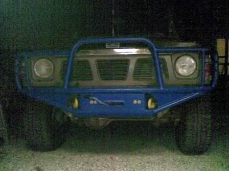

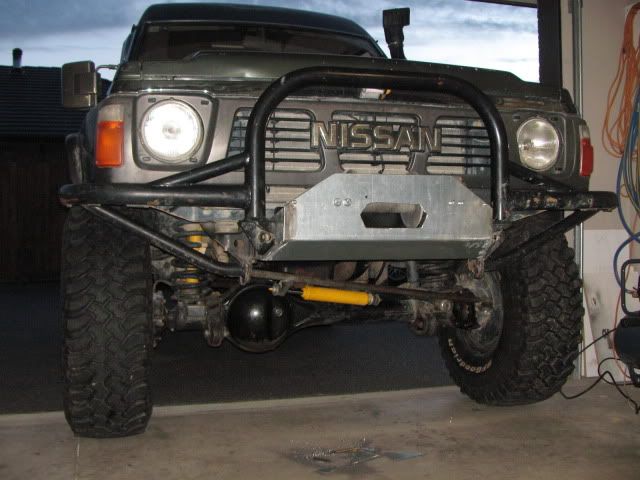

At last winch/bull bar set up pretty much 95% finished.
Added a cross bar just above winch so I have some were to bolt my spot lights,and the devil horns to on main hoop to wrap rope round.
Shane
