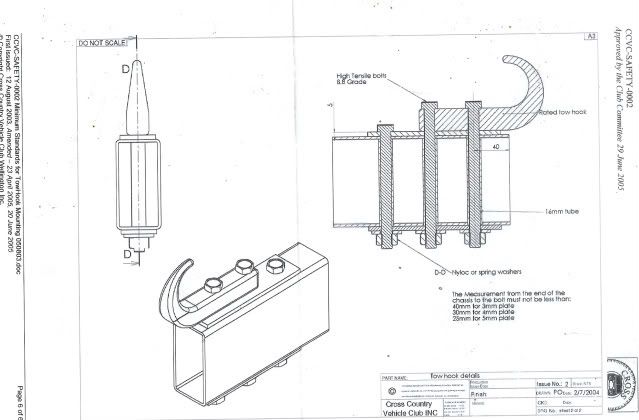

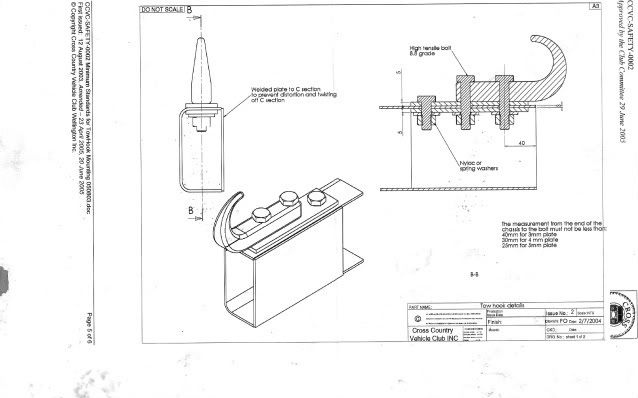

alright i need to mount up a front hook so i can actually go and get muddy again!! i've read articles and stuff but they all are on a open chassis rails. mine is a closed rail. this is on a mu by the way
so i wana do the job once and do it safely.
has anyone got any pics or suggestions or answers or can help??
any help appreciated
