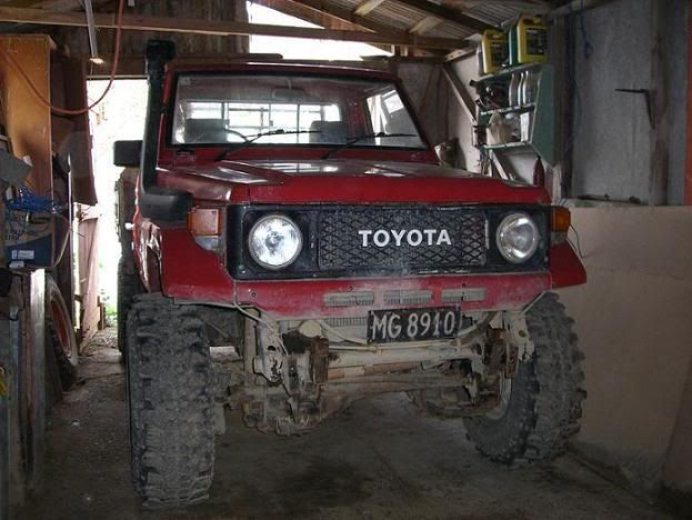

its a width thing im also after,the diffs have been sweet but i dont really drive it with my foot up it alot,ive been quite cautious with it with the big rubber but i want to be able to feed it fat if i need it to without breaking things
ive noticed a huge drop in tippyness with the roof and rear doors gone so its getting there but just want to go a bit further and widen the front since ive got the back lined up

zookfest wrote:its a width thing im also after,the diffs have been sweet but i dont really drive it with my foot up it alot,ive been quite cautious with it with the big rubber but i want to be able to feed it fat if i need it to without breaking things
if you are planning on making the front wider than the back, I don't recommend it. Your road handling will be absolute shite if you do that.
keep same diffs front and rear, so either go for spacers on wot u got, or 80 diffs to make it wider, or nissan diffs to make it really wide
You can get about 150mm extra track with a centre flip in your rims, $30 plus GST each when I had mine done

yea i brought the midi ex kiwimidis truck, from what iv been told they are out of a toyota dyna 5.29s with longfields, goes bloody well, runs the 36s iv put on it with ease
, may do turned rims aswell.have 1" spaces coming shortly.

yep pretty keen on that saf diff of rorys.mite have to measure it again
got 50ml spacers on the ute already
